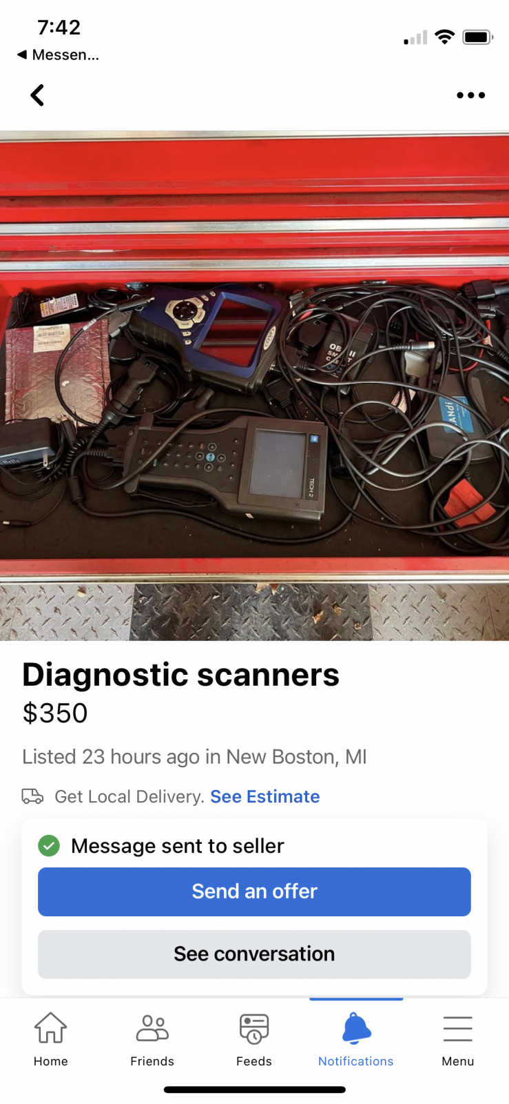

sell it on ebay for parts and recoup a little bit
Good idea!
be sure to put it for parts or not working, and clarify in the listing that it does not work, people are dumb and this way no one can "reasonably" leave bad feedback
What price range you feel os fair for a non working unit with the case, cables and candi. Maybe less the vci as I might keep that.
Thanks for the idea to sell the failed unit for parts. Being that I could get it to work somewhat and that I could flash the card to whatever software someone wanted I was able to sell it for $200.00 on eBay. I even flashed it to the most current Saab software for the buyer.
26,956
40,720
Thanks for the idea to sell the failed unit for parts. Being that I could get it to work somewhat and that I could flash the card to whatever software someone wanted I was able to sell it for $2000.00 on eBay. I even flashed it to the most current Saab software for the buyer.
really? 2000 for a clone?
