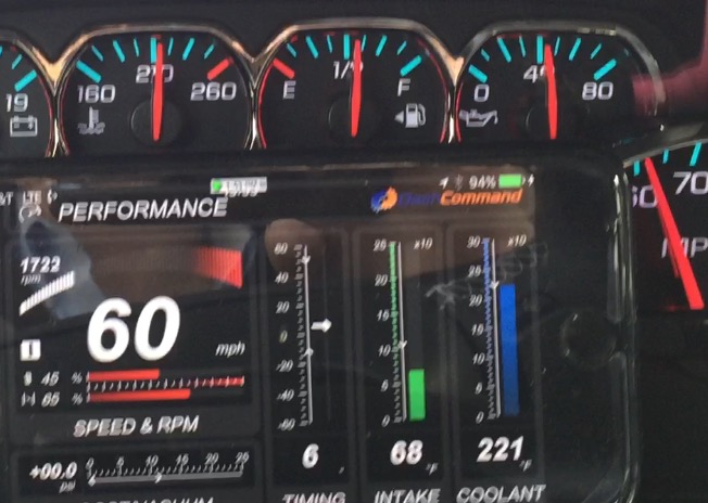

pickup a new 2016 suburban last week and i noticed that going up hill or getting on the freeway on an incline the temp gauge seems to go up a hair than its usual spot.
Normally it sits right at 210 in the middle.
Has this happened to anyonelse here as a problem to fix or is it something normal??
Being in livery biz i hate to drive around with fluctuating gauges especially the temp gauge which is a sign of overheat.
Please chime in , thank you

In this suburban temp gauge say 210 and my readings are around 212-216 range. Then when i start an incline the temp reaches 220 and gauge starts creeping up , it goes back right away but i am concerned.

i have a friend who also bought a 2016 suburban but an ltz couple days after me, tonight we'll take his car and try to replicate the same thing to see if it is common for these models.i had him do a reading on his and his was also reading around 210-220 but he didnt have a chance to go uphill to try the gauge fluctiation.
these cars so as my old 08 escalade come with two cooling fans. while the ac is on one will always be on and the second one kicks in when there is heat building up. so i guess hittin 220 kicks in the secondary cooling fan.but gauge does go up tiny bit. i do not like to drive around with overheating problem breathing down my neck :(
edit: found this repair article on 2015 tahoe and suburban and #9 state that normal operating temperature for the car is 194, so i am curious why mine is running at around 210ish levels.
i know every car is different but the town car also operates around 194 with ac on and secondary fan kicks in at 210. weird weir weird
