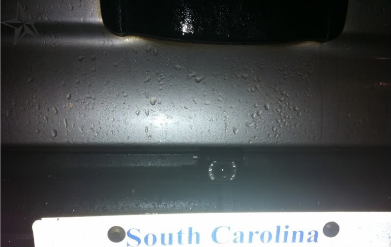

if you look closely at my license plate you can see the black dot in the middle. that black dot is my camera. i drilled a hole and mounted it in the middle there. behind the plate is an open area in the bumper so it worked out perfect. i ran the wires up through the driver side taillight and to the front. i've got it hooked up to a 5" clarion monitor up front.

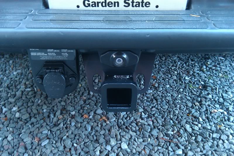

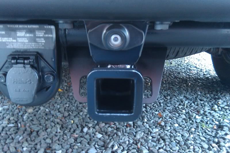

i test fitted my camera in the area right above the hitch receiver. it fits nice in there and can still run the wire up. might need to fab a mount in there.
