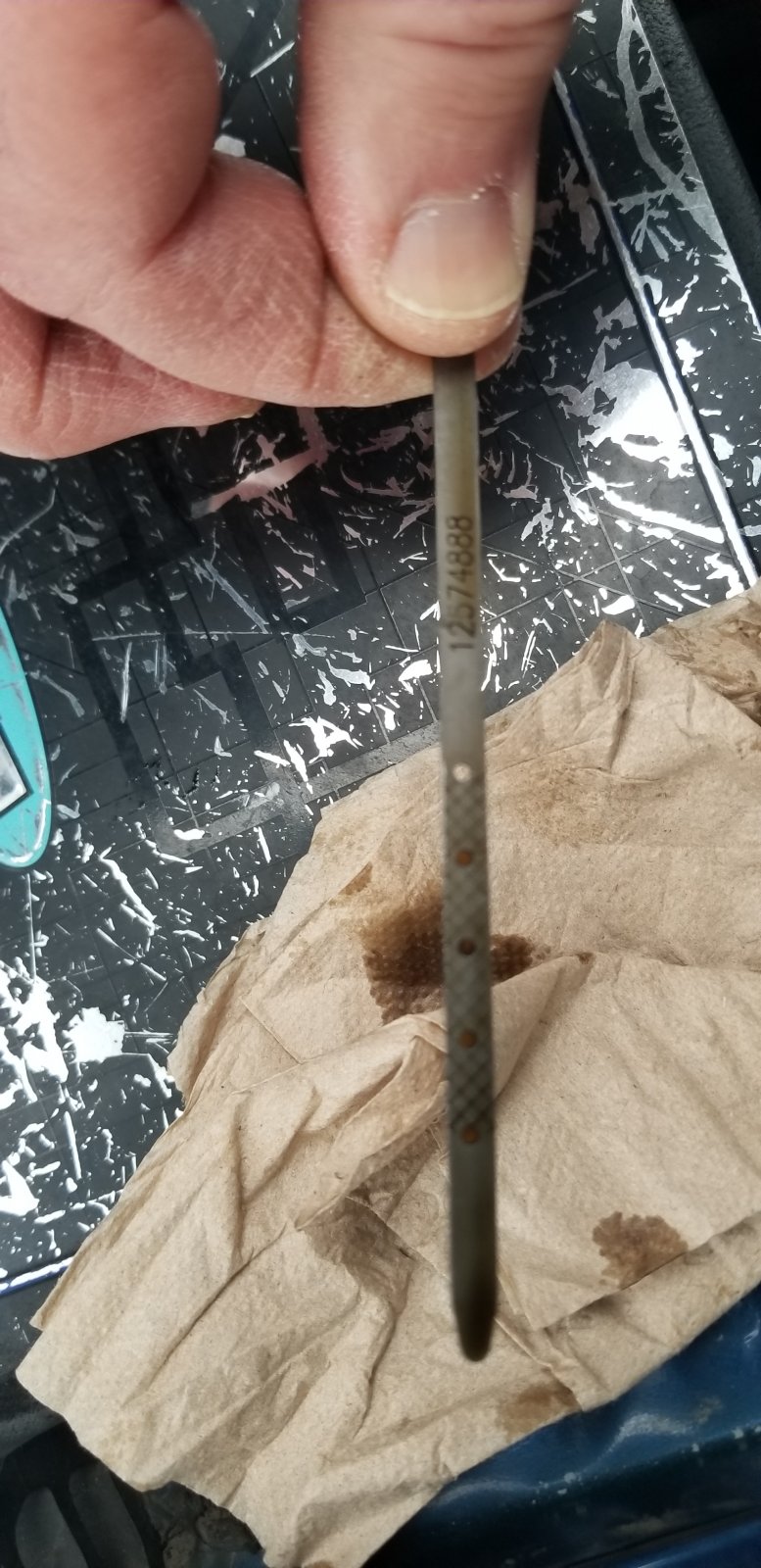

Oh....I checked the oil. It's not smelling like it's fuel saturated, and granted--I don't drive it much, look how clean the oil is.

So is it running good now or do you still have issues? And the trans? Did you have to add fluid? Is it working good too?
Well....I probably put around 40 miles on it today and it actually ran pretty damn good. I didn't hear or feel anything weird. Trans shifted great. I didn't check the fluid today, I actually forgot, but the day of the incident it was good on the stick, and it took around 7 qts. I've probably had this trans going on 4 yrs now and I've YET to change the filter or fluid! I keep losing the damn fluid so it's constantly getting refreshed. Still shifting great tho.
