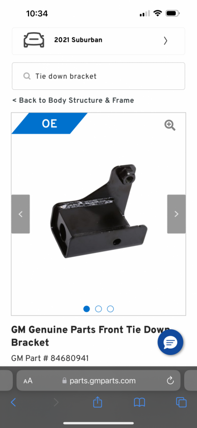

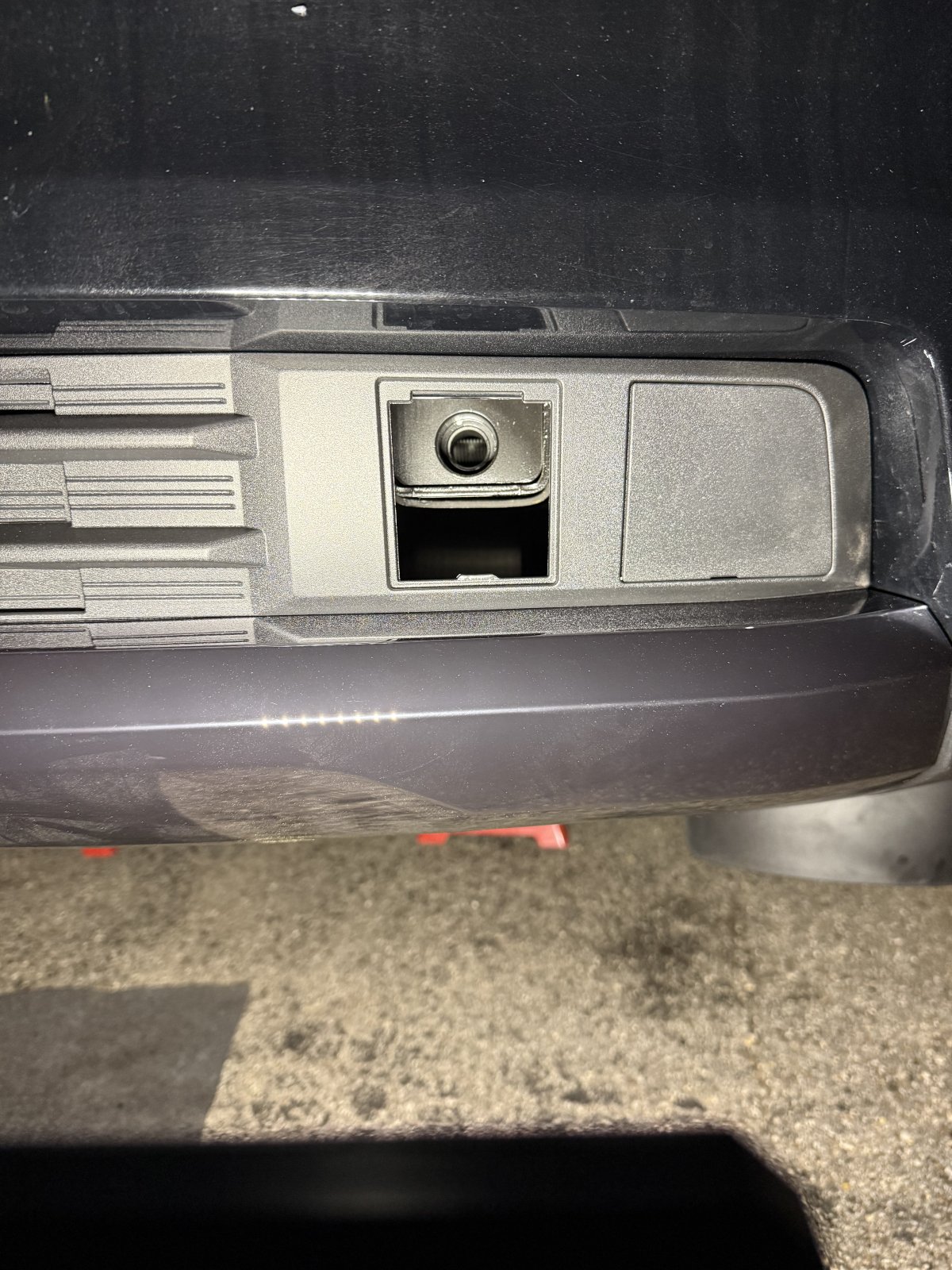

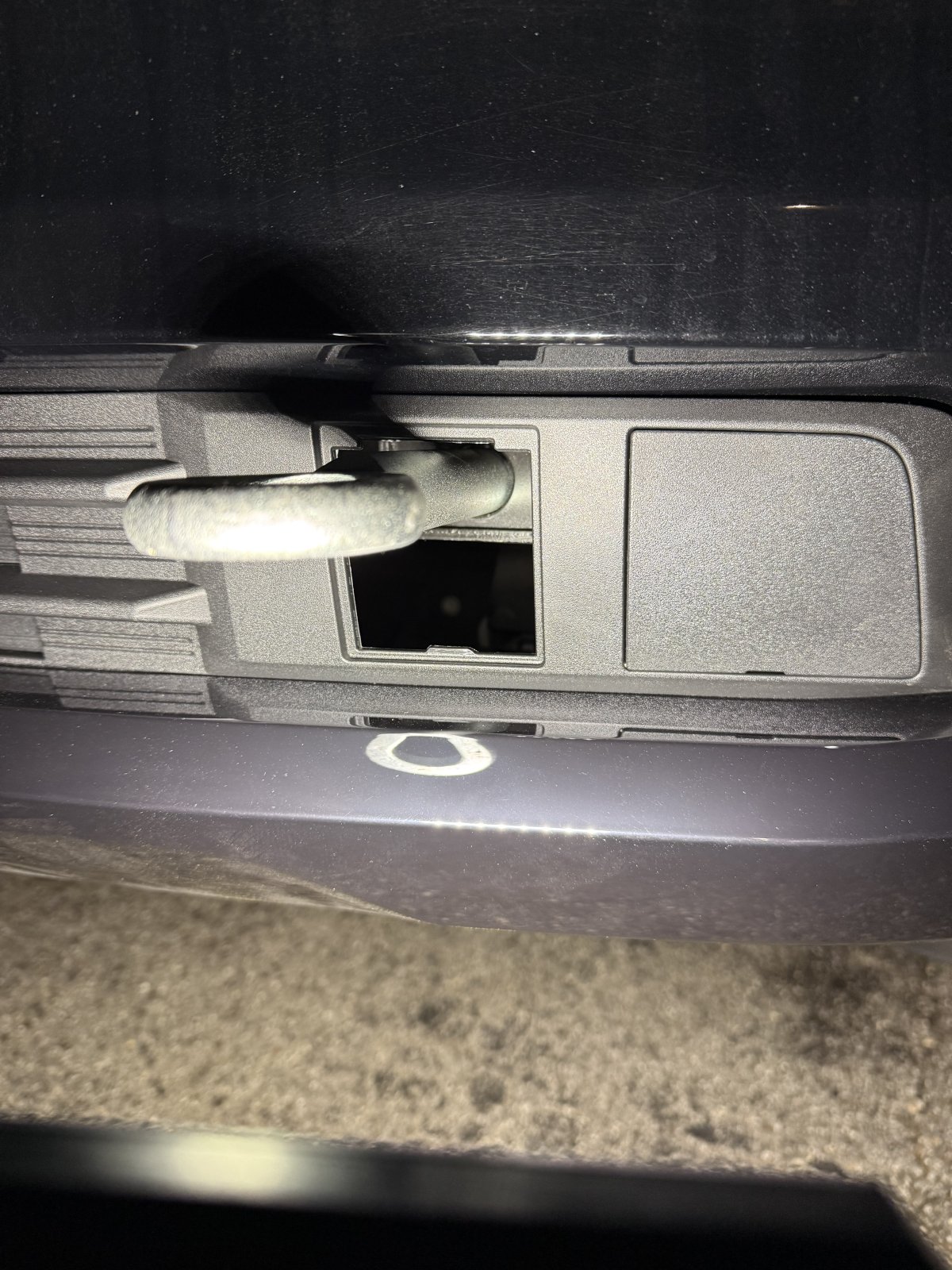

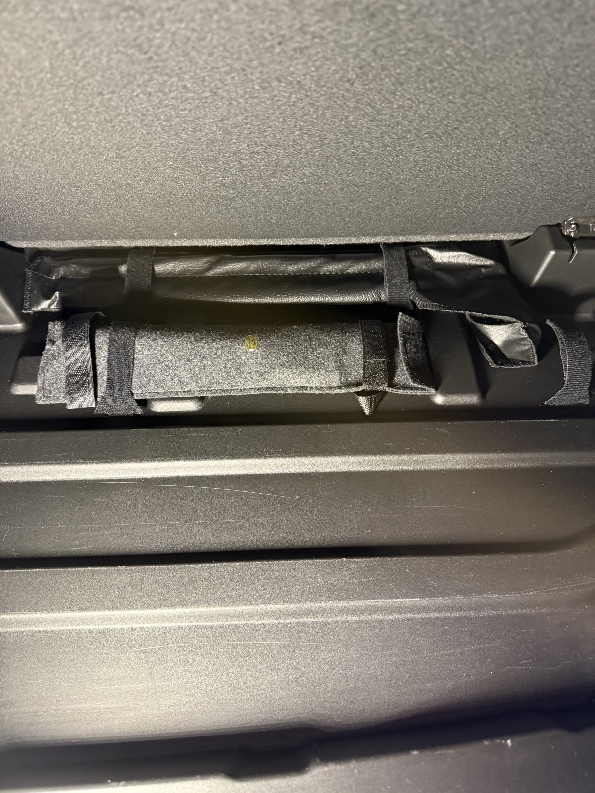

I have done some more research but have not actually purchased the parts to verify. There is a front tie down bracket (GM part # 84680941) that is listed to fit 2021-24 Suburban/Yukon/Escalade vehicles. There is a front tow eye (GM part # 84452971) that is listed to fit 2021-2024 Escalade’s only. Not sure why the tow eye won’t work on a Suburban or Yukon or if it’s a description error.
The tie down bracket bolts to the driver side frame rail. The plastic cover is popped off and the tow eye screwed into the tie down bracket when needed.

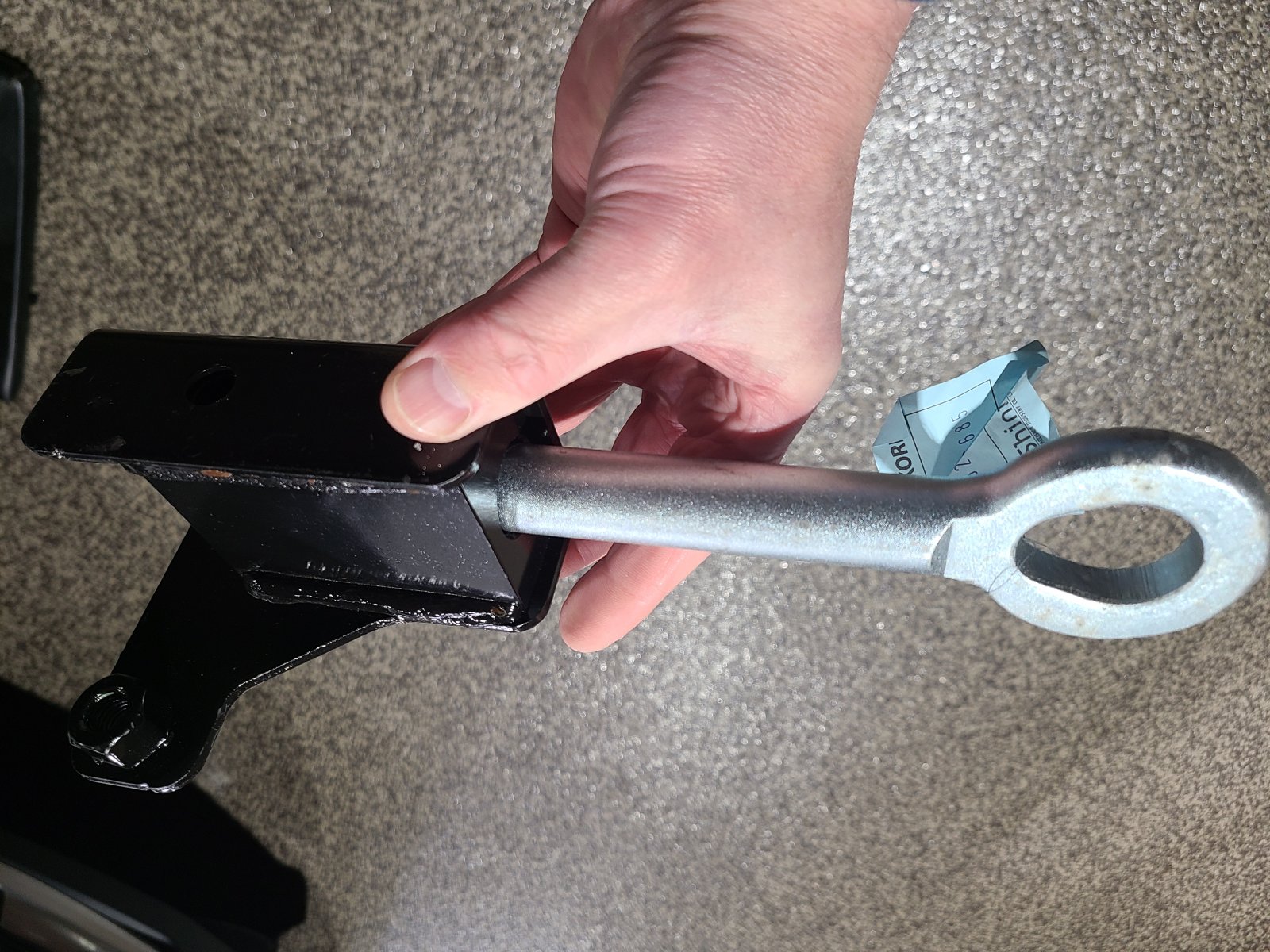

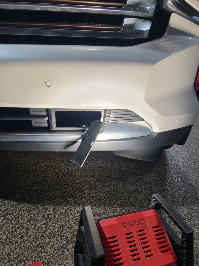

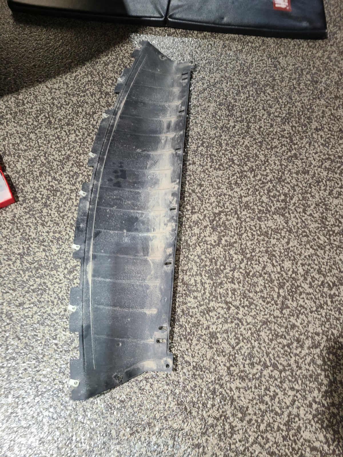

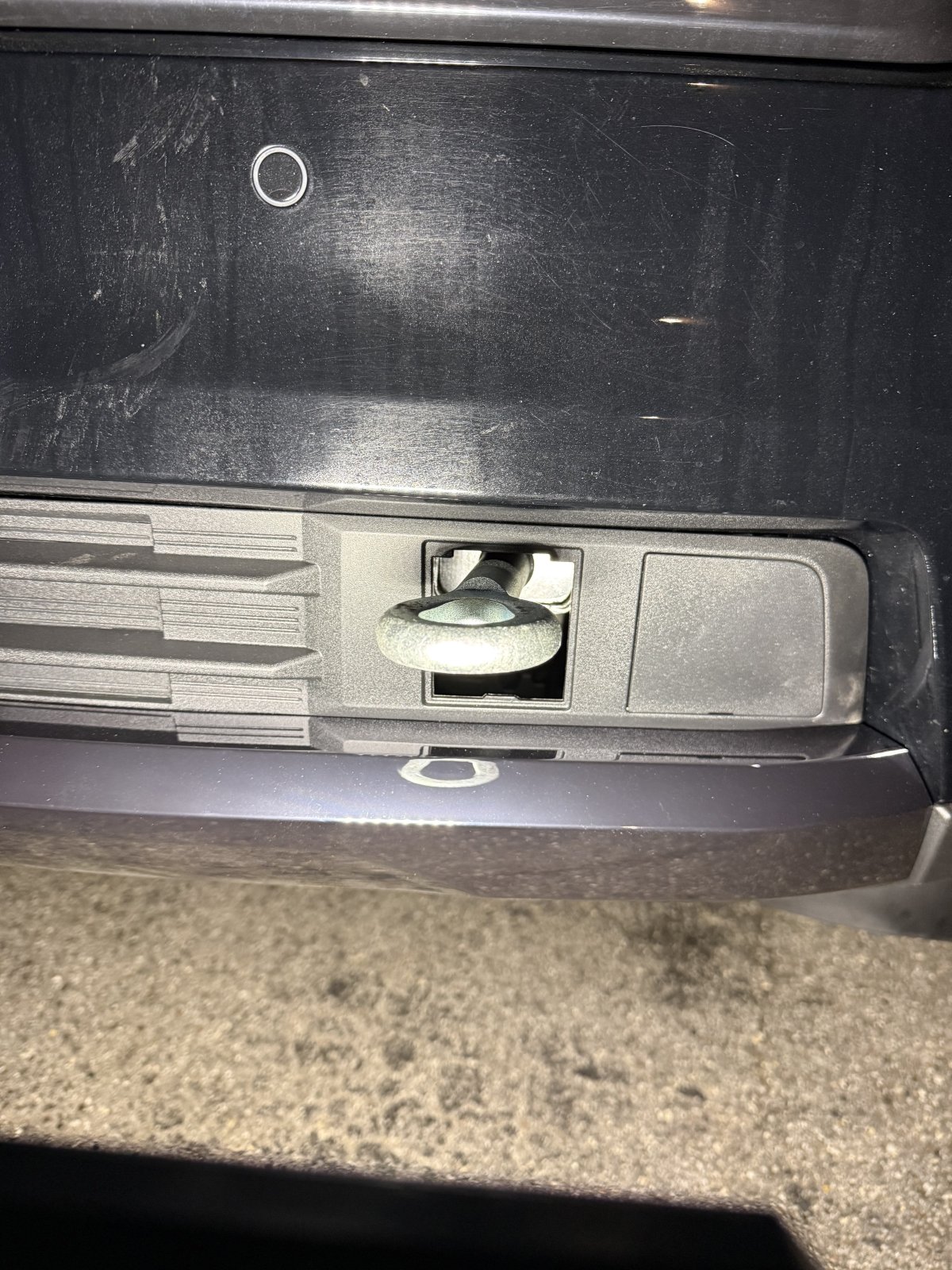

Installed tow pin on a 2024 Tahoe High Country diesel. Had to grind a little on the purchased bracket so it would slide into the frame. Remove the plastic section on the lower bumper. Bolt in place with a few bolts. Now, I have a pull hook on the front. It would be very difficult to secure a strap onto the frame or axle if stuck if you don't have this...
