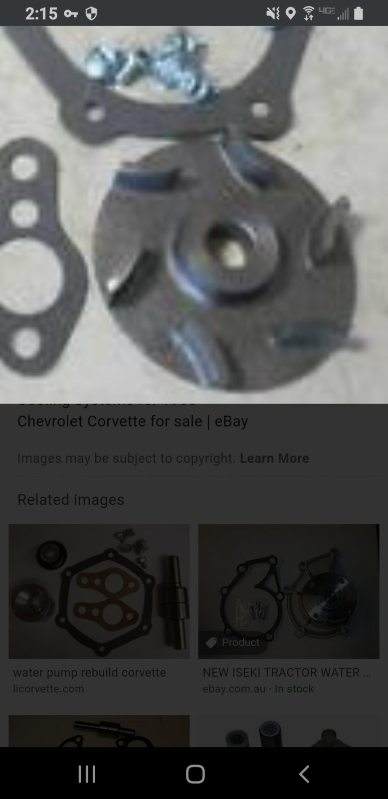

Are your cooling fans running? Also, maybe the water pump is starting to go bad. I think the impellor in them go bad and won't circulate coolant effectively.

Impeller goes bad??
