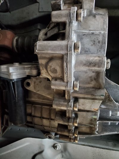

Drove it again and there was a few drops of fluid. Still can't locate the damn leak! The 246 badge is held on by small screw. Could that be a potential spot for a leak? 20220331_121515_resized.jpg20220331_121550_resized.jpg20220331_121835_resized.jpg20220331_122053_resized.jpg20220331_121948_resized.jpg

The red dots are where you will typically see the small rub through holes created by Tcase pump wearing through the case.
OP I am concerned with the area circled in yellow. It appears you might have a hole. Id wire brush the circled in yellow area and look real close. Seems to be alot of grime sticking to the case in that area.

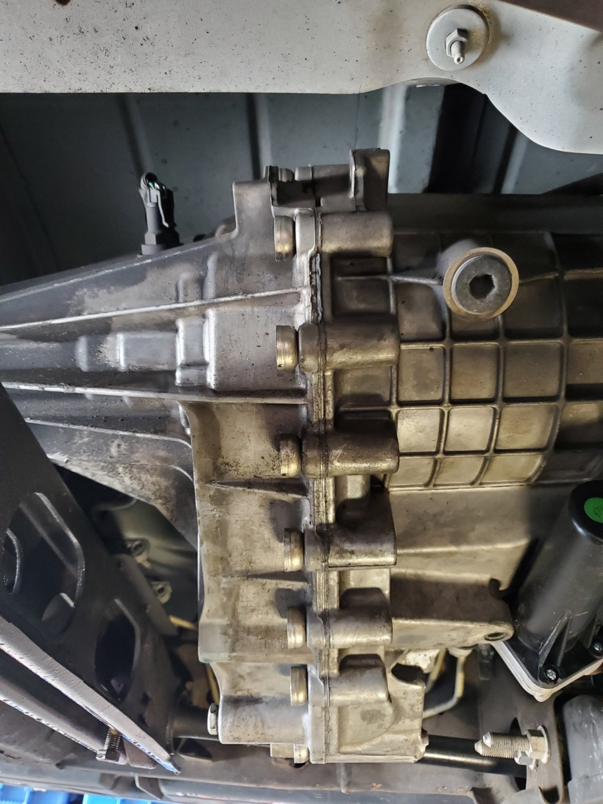

I had my trans rebuilt within the last 5k miles and my mechanic that did it changed the fluid in my transfer case and mentioned the drain plug being too tight he had to drill it out, and if tightened too much would split the case.
I have noticed some drips forming but in a different location. I am a noob in regards to looking at this transfer case but a quick learner.
Can anyone take a look at these pics maybe point me in the right direction or what to investigate. Seems pump rub and a hole forming is common but not what I am seeing on mine.
The rear is dry but the front has obvious drips. The drips are not bad enough to leave any fluid on the ground, I just spend a lot of time looking at every inch of my truck and noticed this.
Thanks in advance

Your case looks like it is wet at the rear and I suspect pump rub through. I would wipe down and inspect real close in the area circled in blue and even the opposite side of the case as well. Your leak is significant and I would also check fluid level of case and top off as needed.
Thanks for the input, the rear of my transfer case is bone dry, I see no fluid near the rear bolts or anywhere further to the rear. The picture does make the rear case bolts glossy but they aren't wet.
I only see fluid collecting near the front and near the black motor.
Edit:
Checked transmission fluid level it looks ok.
Checked tcase fluid level at the fill port, got blue fluid coming out right away so level looks good.
