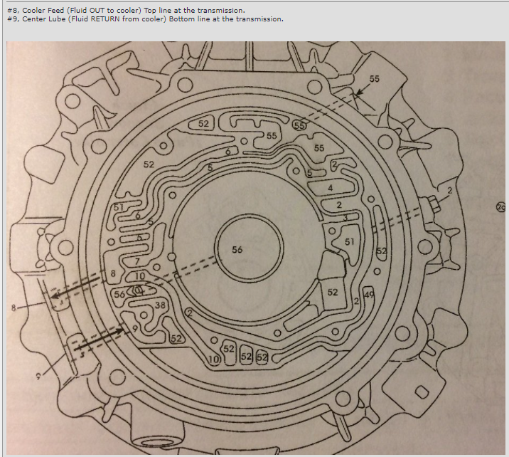

When I did the transmission cooler installation, I did not put the thermostat in, partly because of issues with the shop I got it from. Now, I've got one in hand due to the cold temps I didn't anticipate. The TX never made it to 100deg. F. Im heading back tomorrow, and was going to install it today. However, knowing the flow direction is now critical!!
SO, some say it comes out of the TX lower port, some say the upper port. Earlier, donjetman said it comes from the TX, to the radiator, to the aux cooler, back to the tx. If this is the case, it comes from the upper TX port, and goes to the lower radiator port. This is opposite of most comments I've read, stating the lower TX port is the send.
Can anyone confirm this???

@donjetman is spot on about the flow order. And, it flows from the transmission into the bottom of the radiator fluid cooler, and out the top of it to the aux transmission cooler, then back to the transmission.
