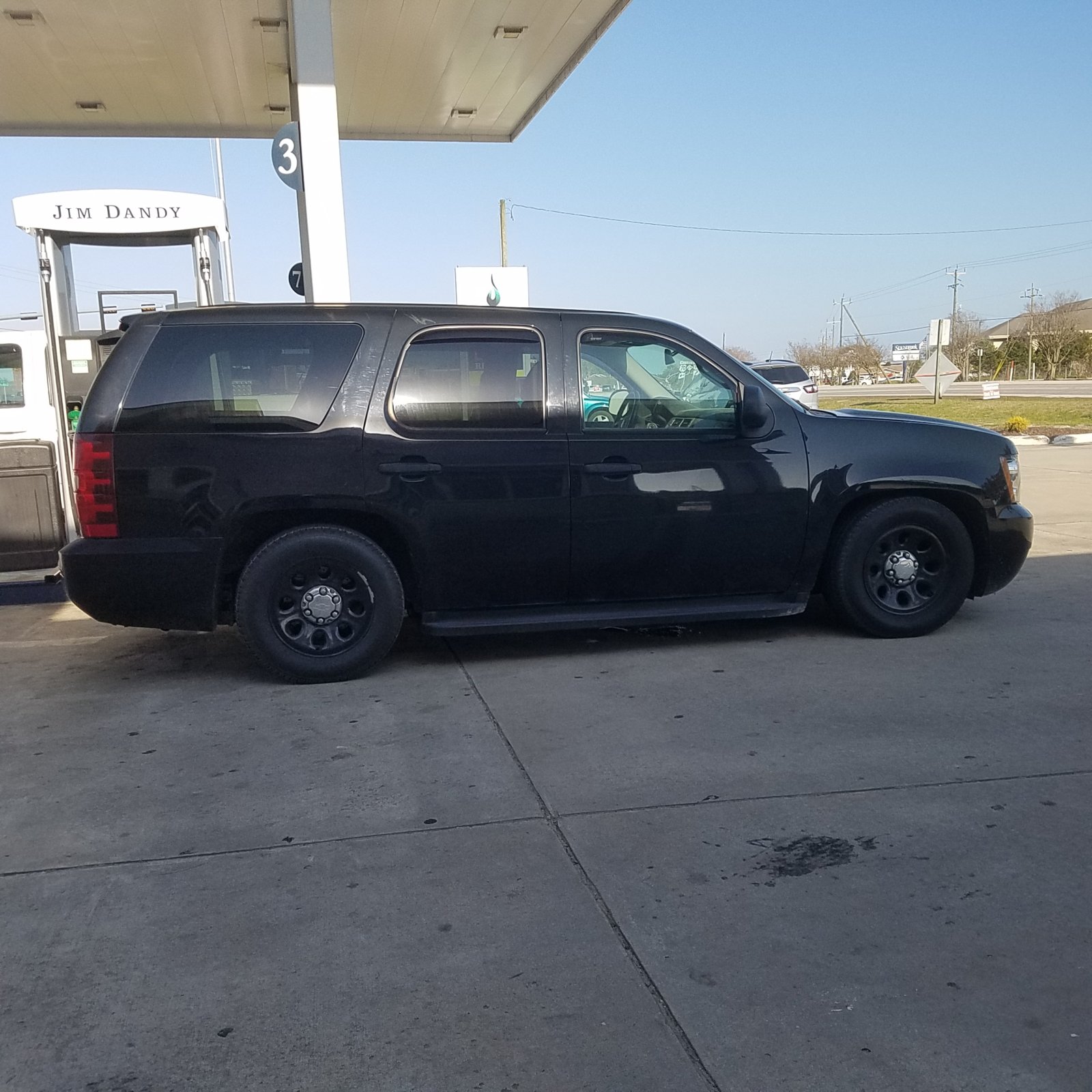

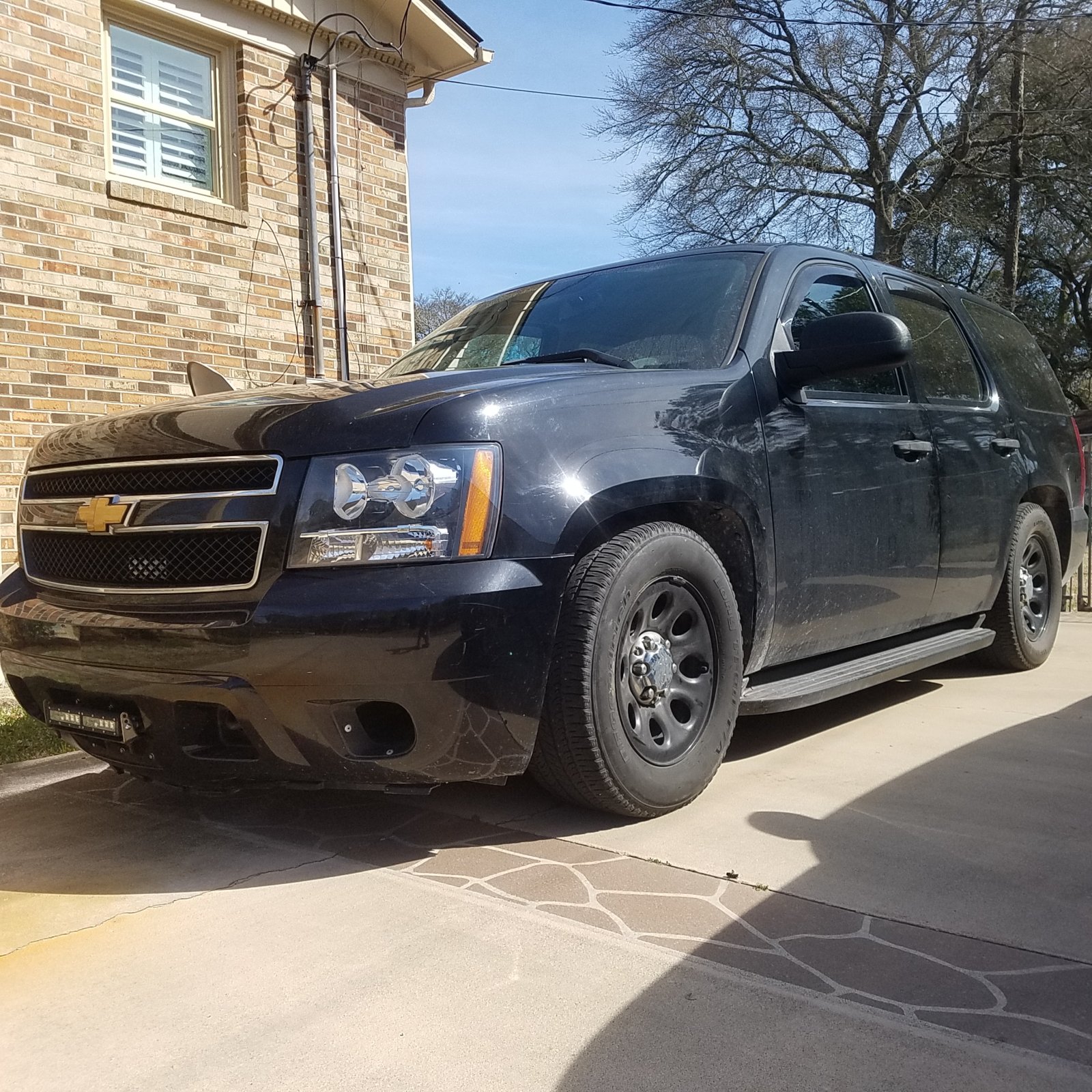

First I want to say thank you to everyone for there help and info. Its definitely appreciated.
My biggest issues were not having the hardware for the lower link adapter brackets and the drivers side sway bar bracket was more or less impossible to get the bolt in that was supposed to be drilled out. There is no way that was going to happen. I'm going to get back under there and drill it out through the bracket and get a longer bolt for it to work.
Took it around the block a few times, went over a nice section of smooth bumps and it settled down nicely. Actually the passenger side may not have been as tight as I thought, it needs to be adjusted. You might be able to see it in the pictures. It makes a little noise to.
Two random questions.
1. Its idling rather high after sitting since Thursday. Why would this be?
2. The ABS light is on. I'm just going to assume its a sensor, maybe lose or pulled out. Thoughts?
I think it looks great, very pleased with the outcome. Everything else is minor.
Now I need to whip out my DA polisher and maker look purdy. Should be easier now with her being so low hahaha. I also took some dimensions for my exhaust build while I was under there.
Well, I'm pooped again. Gonna go put my feet up and enjoy the next two days off :)
I'll be back
Thanks again guys
