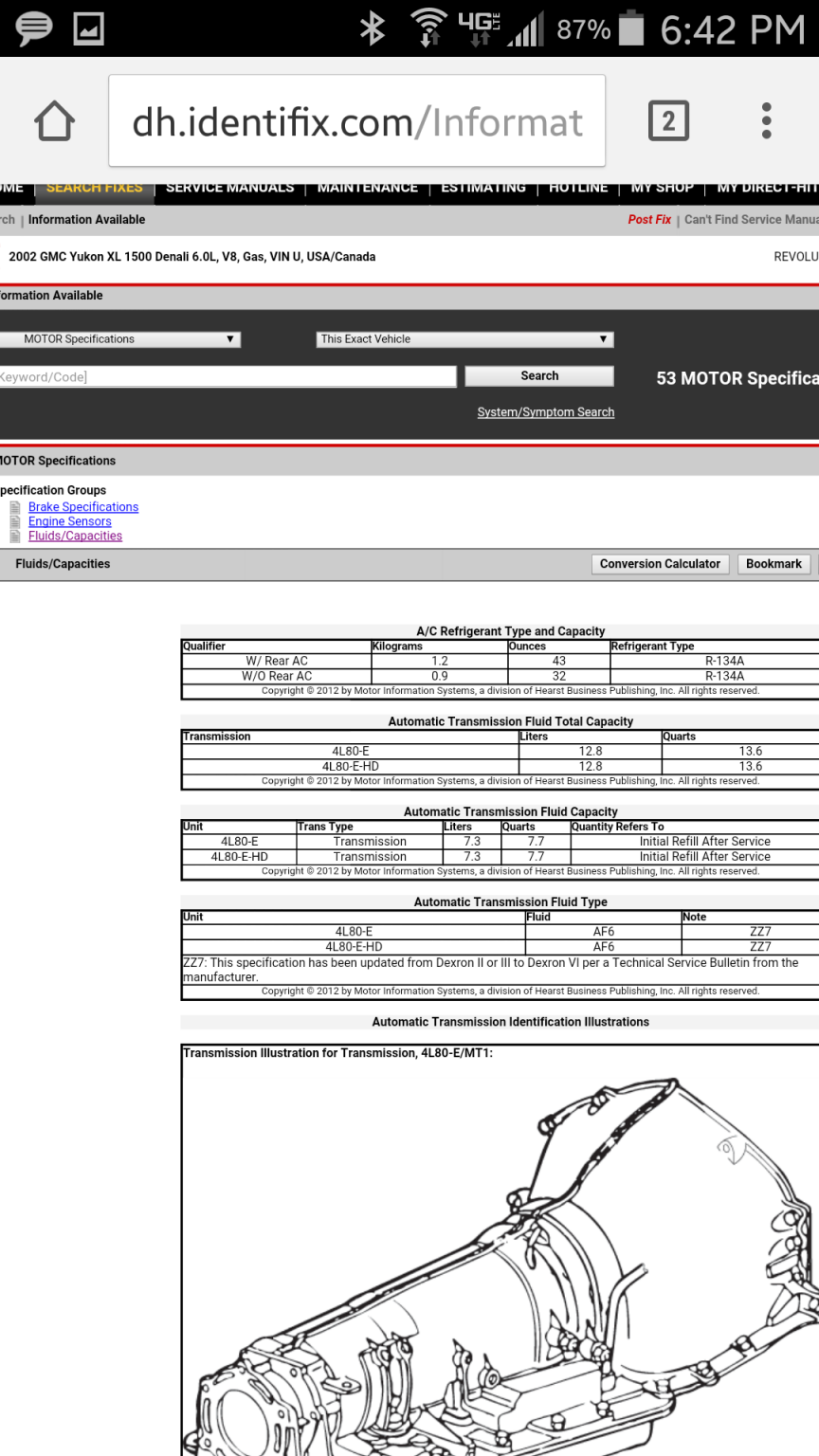

I'll loose my awd with the 4l80 right.. not a big deal but just curious. Thank you very much btw!
bottomline2000
Oct 21, 2009
1,722
988
Dallas, TX
Fairly certain that the Denali's come factory with the 4l80.
Only the 2500 series suvs had the 4l80 to my knowledge. My motor came with a 4l80, but it was in a 2500 suburban.
Sent from my SAMSUNG-SM-G900A using Tapatalk
Wicked
May 4, 2012
The 02 denali does have the 4L80.
You can also call a dealer (parts department) with your VIN.
