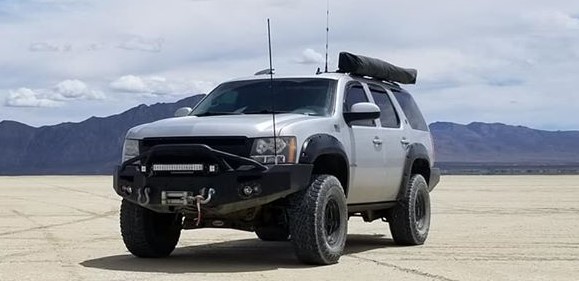

Thank you, I run a 4 inch lift now and most likely will pick up another inch for a total of 5 inches front and rear. The kings will enable more wheel travel most likely up to 8 inches or more depending on how much the axles will take... They should preform better although I have no complaints about the RC 7000's on there now. The rear for now will most likely stay the same
Thank you. I really like how it works... I just keep thinking of other stuff to do to it... lol
Very cool. They don't get any better than King.
Curious, not very familiar with lifting our SUVs. How did you get 5" of lift out back? And does it affect where the rear wheels location? When I dropped mine it moved them off-center, does it do the same for lifting? I'd assume so.
How do you fix it? Lift links?

I have a Ranch 4 inch lift with over two inches of sag up front I plan to use the King shock to raise in up another inch in the front to total out 5 inches.
On the rear with the lift kit I have the rear wheel is re-centered with the Rancho lift kit and I am looking at putting King shocks and a little more spring back there to get a little more height.
To answer your question when dropping it you should be able get the axle in the center by replacing the arms with something shorter.

I guess this post needs an update... lol
This past year I installed 13 mm of sound / thermal insulation in all the side panels, doors, rear door and also the roof it drops the inside temperature at least 20 to 30 degrees when sitting in the Arizona sun. Combined with the tinted windows driving this is like riding around in a cave. The 13mm insulation is glass reinforced on one side and adhesive on the other and sticks really good to the sheet metal.
This is the roof insulation. It is amazing how much cooler it is with the roof insulated the cross member sections are also sealed off.
I added more storage space on both sides in the back. This is the shelf I made for the left side. It is mounted with two quick disconnect pins so it can be removed for access to the storage underneath. I made it out of 10 Gage aluminum with a carpet covering. You can also see my Co2 tank, magazine holders and Radios. Our 8 radios are encrypted so no one can listen in to our conversations. 20200806_164206.jpg
