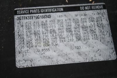

Its an 09 Tahoe with a 6.2, so it's an L9H with no AFM. The owner slapped on badges and threw on some wheels from a hyprid Tahoe. That vortec max max badge is from an 07, 08, or very early 09 Silverado with the L76 6.0. There were L76 vortec max in 09 that had a 4 speed auto, then the 6 speed, then a switch to the L9H 6.2 in the same year. 2009 was a confusing year for GM, lol .
Edited to fix LY6 to L76
