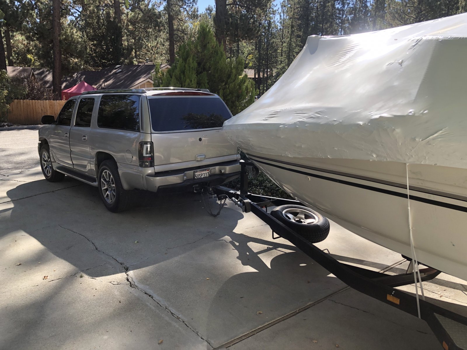

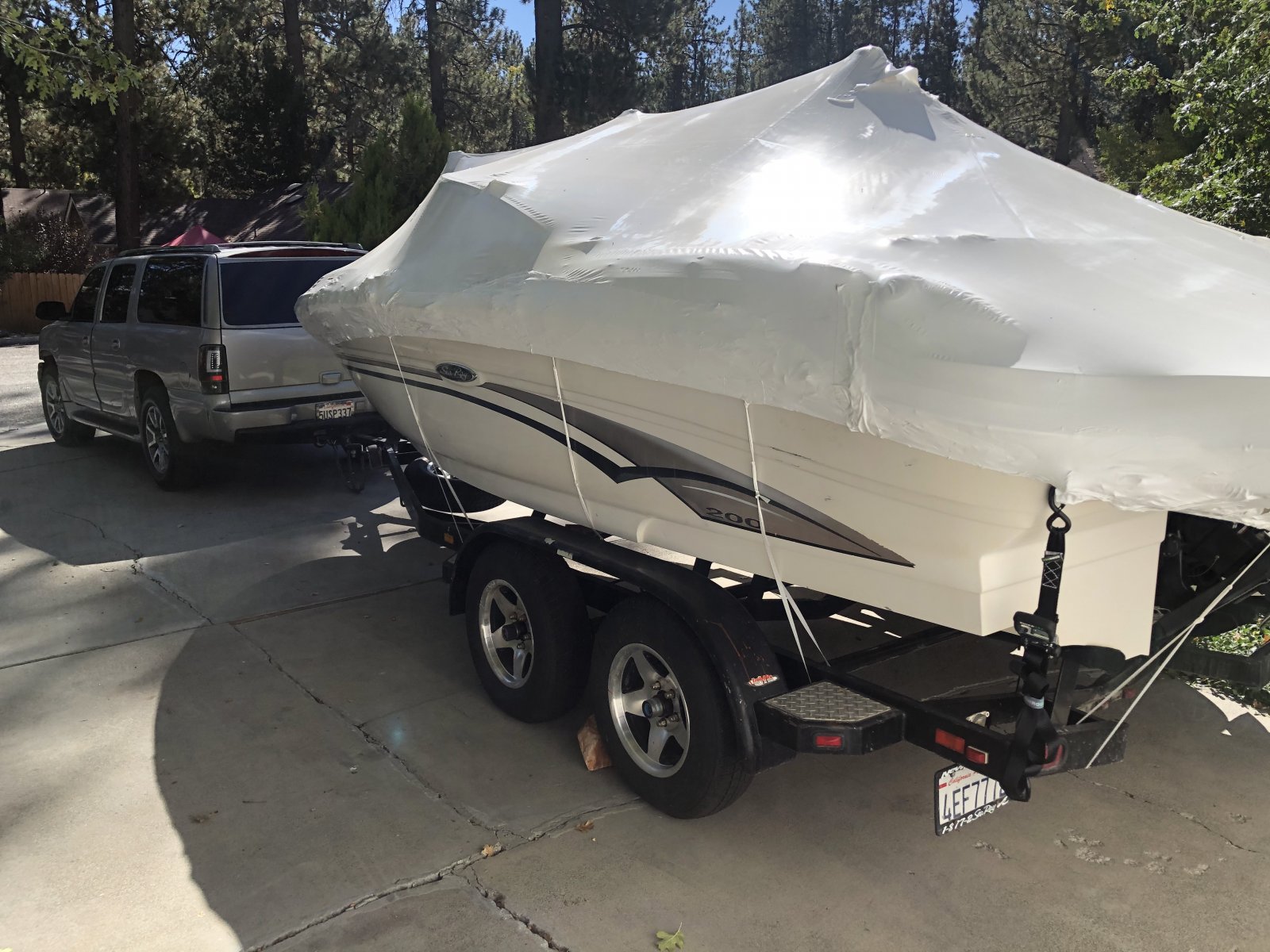

It could be the photo is a little deceiving but it looks like your trailer is a little nose down and the equalizer bars are not level. Try to raise the hitch one notch and ensure the bars are level to the ground when tight. The trailer should also be level to the ground. Do all of that with the trailer just sitting in place on the hitch ball with no load on the truck. Once that is done put the load on the truck and try it.

My WDH says you measure the height of the rear bumper unhitched but the truck loaded and then hitch up and measure the height again. Adjust the chains on the WDH bars until the bumper height is back to the previous measurement.
But it sounds like you've done similar and are still getting the same result, so you working on your suspension seems to be the solution.

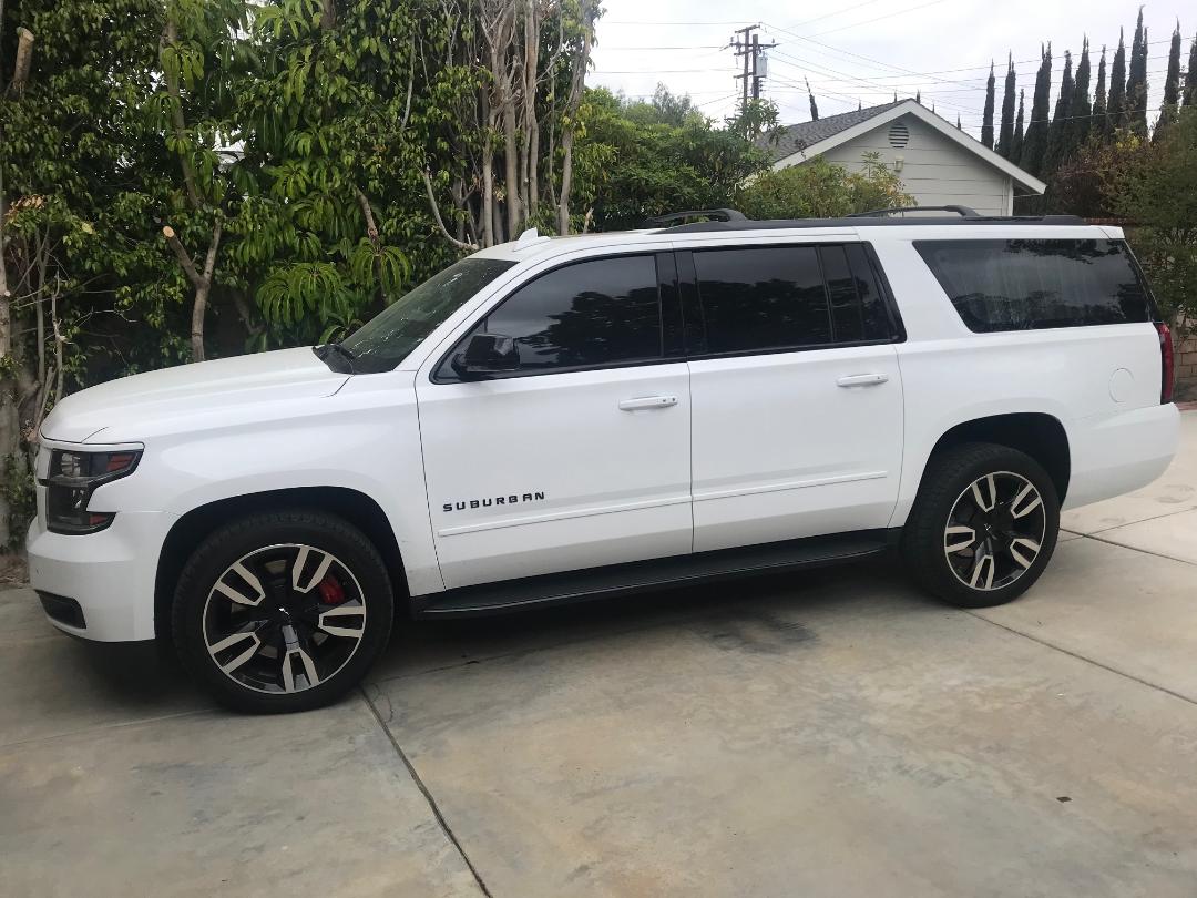

Check out my yukon! Looks familiar yes?
I miss that thing....the seats were so comfortable, nice and puffy.
