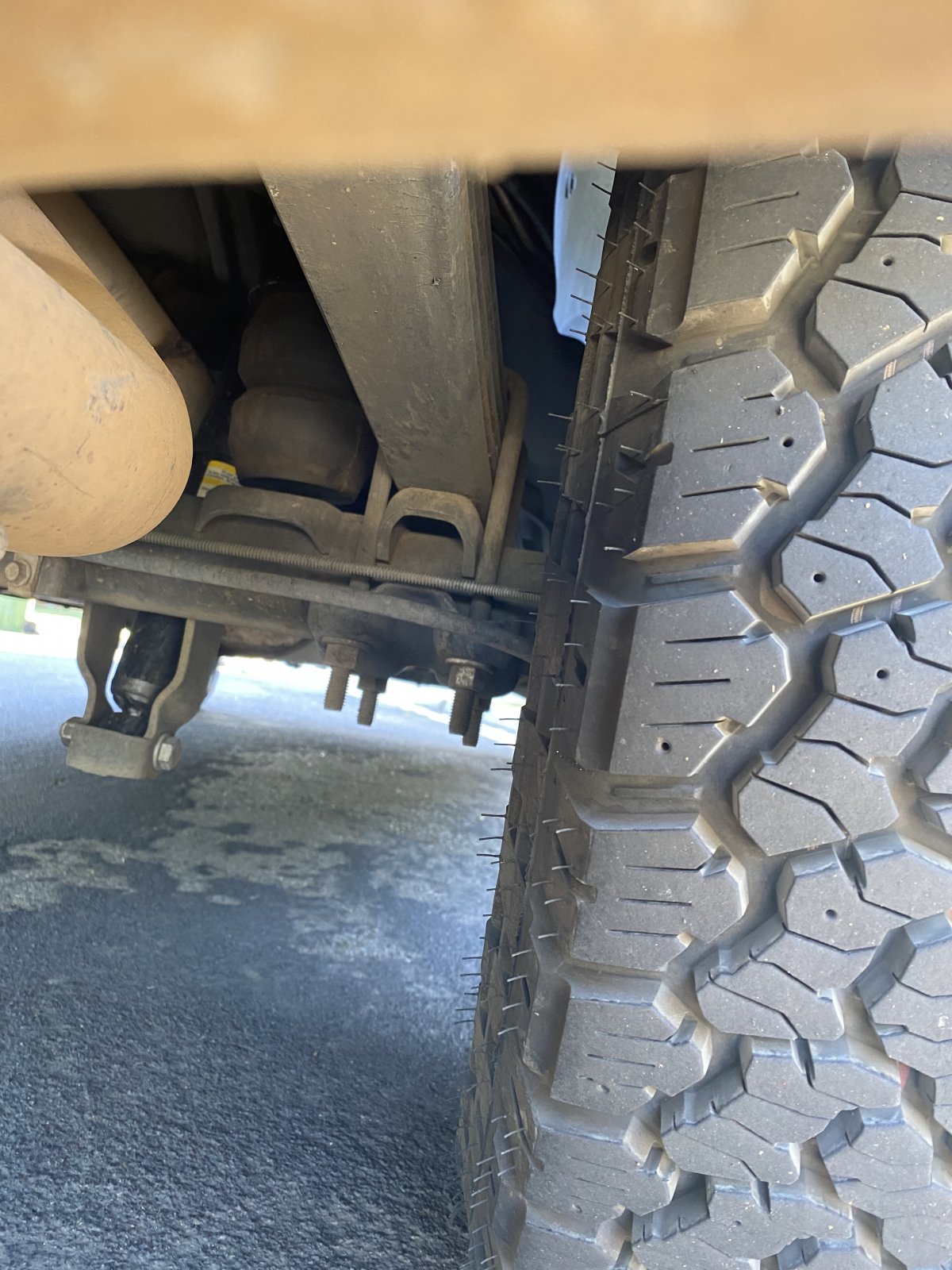

Without having looked it up - where do the airbags go with the leaf springs In back? Had previously considered on my 1/2 ton but those went inside the rear springs. Thanks for the input.
I have seen them mounted 2 diff ways either on top of your rear spring and into predrilled holes in your frame,or directly over your axle housing.

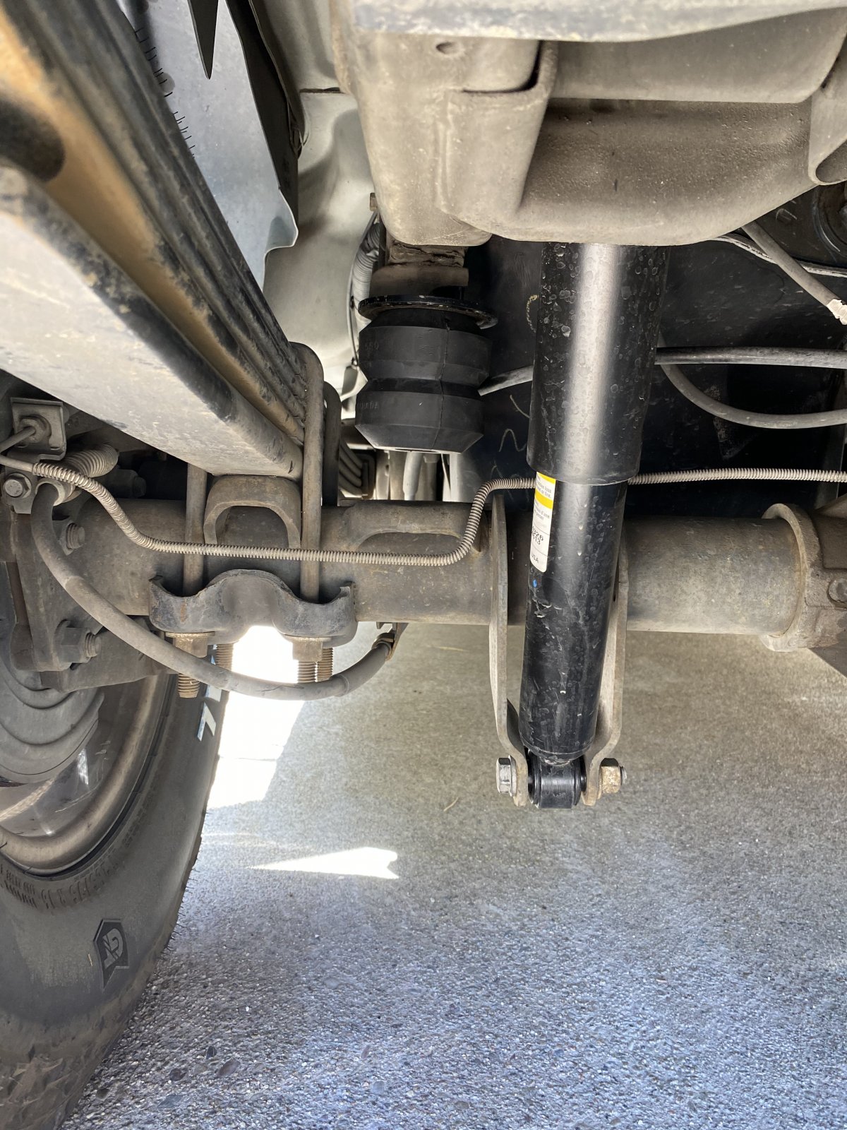

1. Not looking to add load capacity, added the Timbren's to try and soften the bounce, but it turns out they are too big so they may be contributing. Timbren is sending shorter versions at no cost (their support has been terrific BTW). Frankly I'm surprised that a vehicle with a 9400lb stock towing capacity needs anything to be honest, and the rear shocks are new. It was thoroughly inspected with significant maintenance performed at the GM dealer where I purchased it - and again when the water pump went out I had a different dealer inspect it and both did not note that the front shocks needed replacement, but I'm doing it since anyway the rears were shot. It only had 91K miles (now 93K).

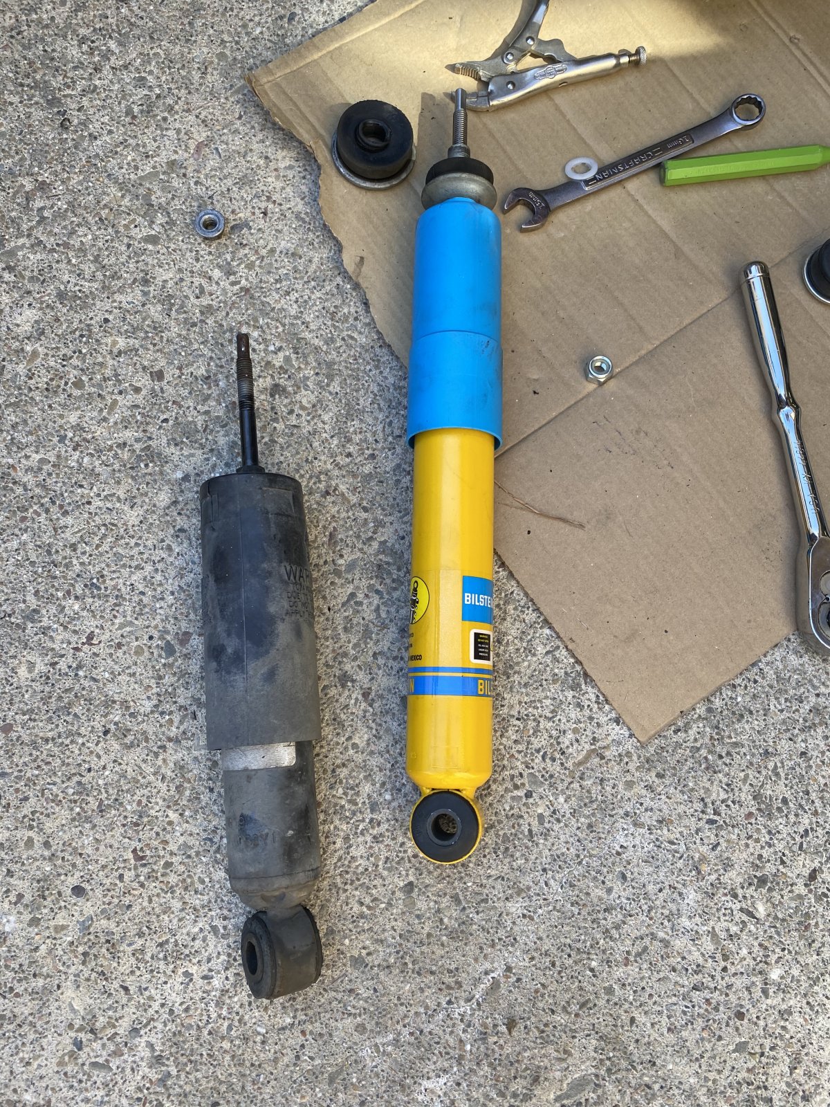

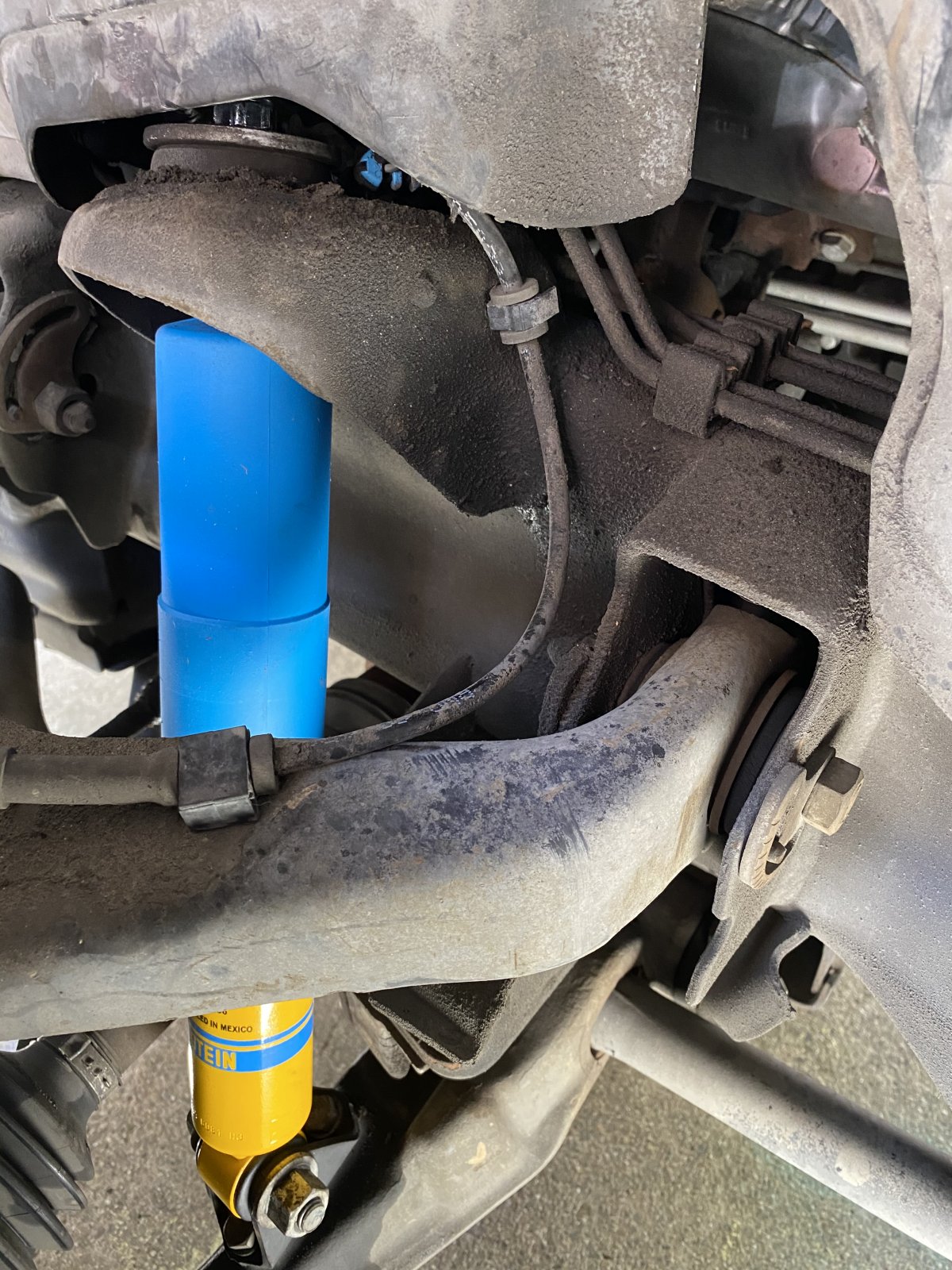

I'm surmising that my front shocks are bad and therefore do not dampen the rebound, and the longer than should be Timbren's are exacerbating that effect currently adding extra rebound in the rear. I saw someone post that they put Bilstein 4600 all around on their GMT 900 and it solved the same issue. So once the front shocks are in I'm hopeful that takes care of it. I mentioned the GM shock part number just to see if anyone else had poor performance from them - seems silly to replace brand new rear shocks that are made for this vehicle that's why I'm only doing the front right now.

The airbags go on the axle with the help of a bracket right above the LeaF springs. I had good luck with them. Do you have something heavy on the front of the trailer? View attachment 277369
