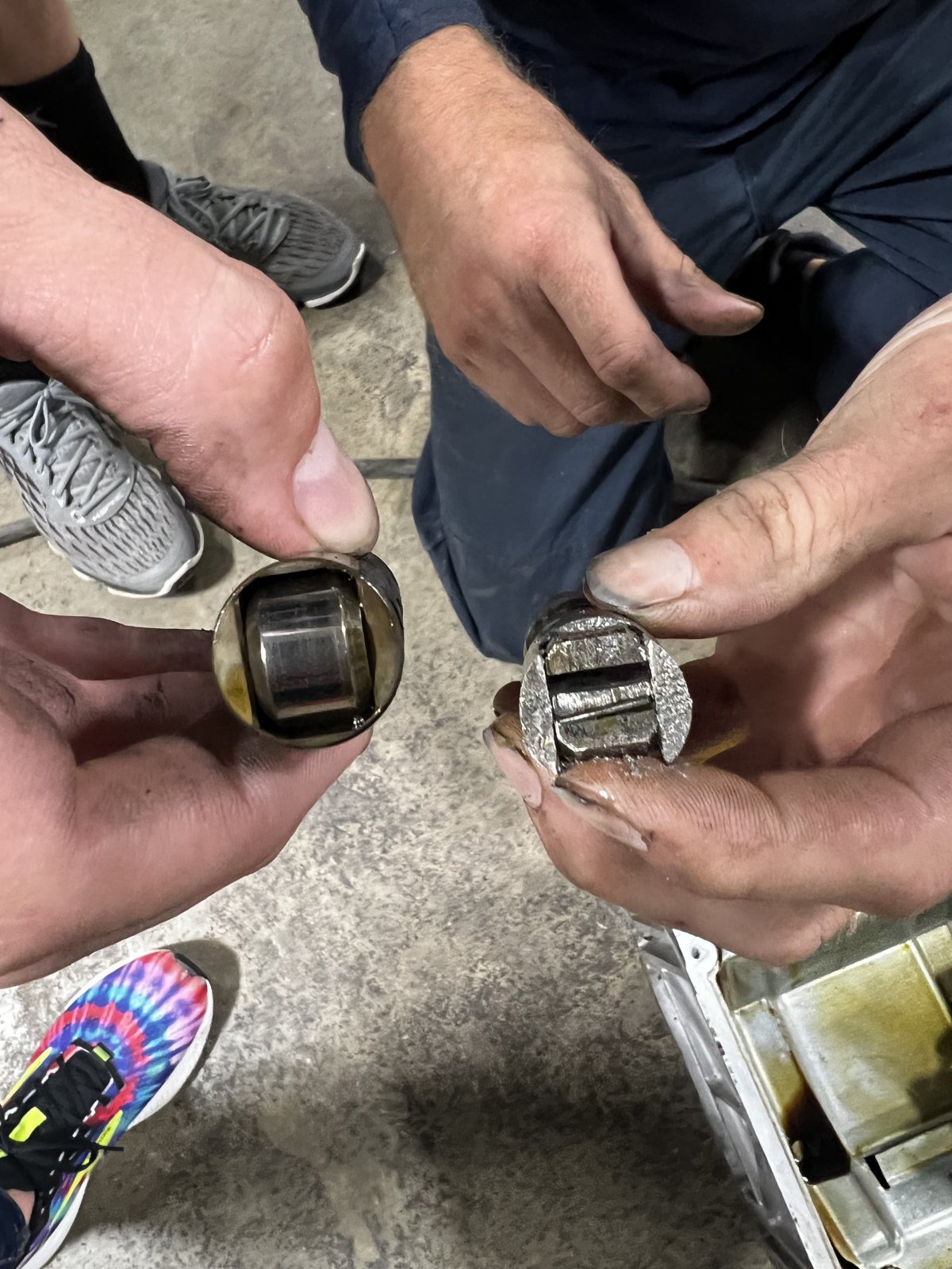

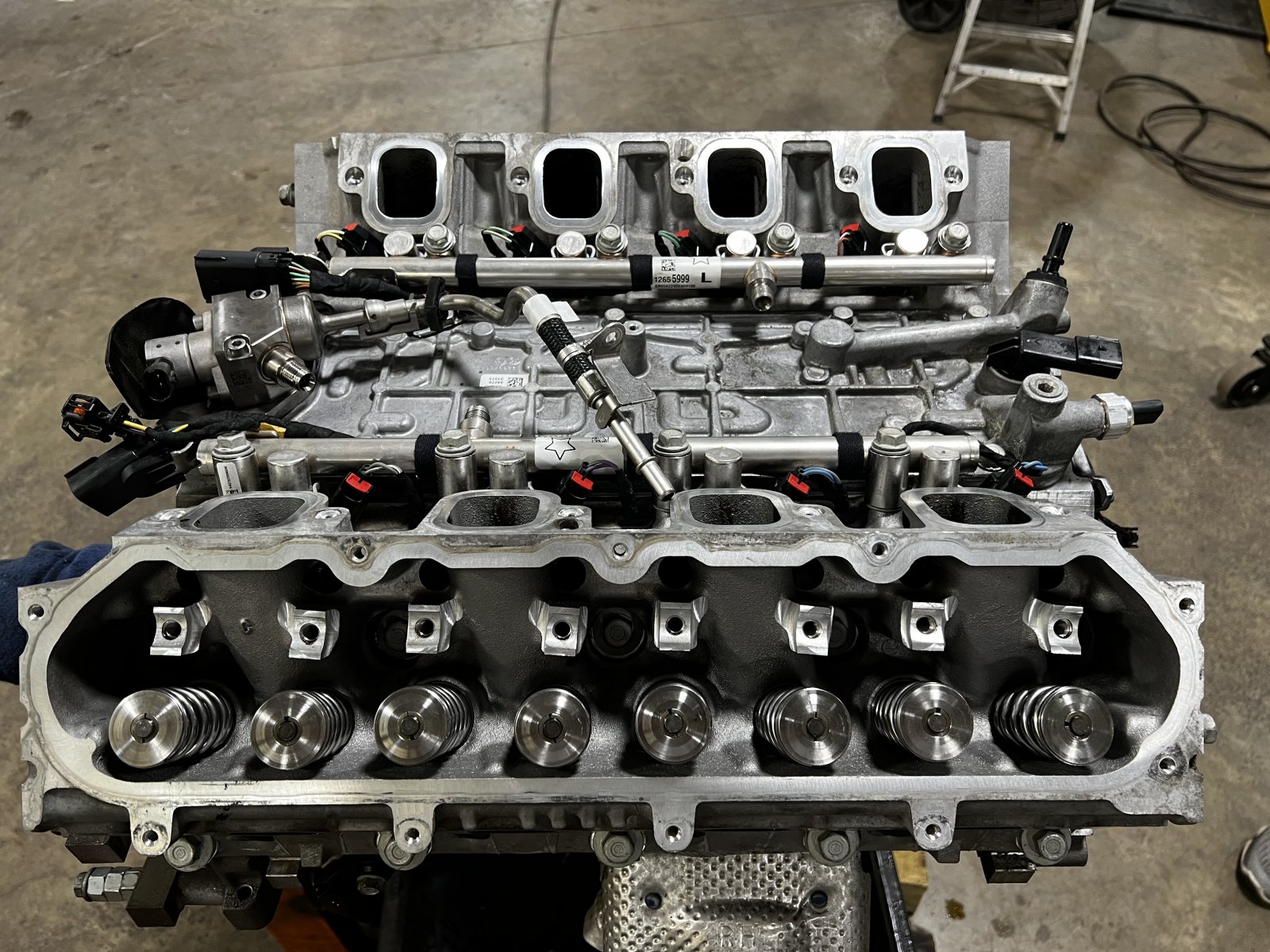

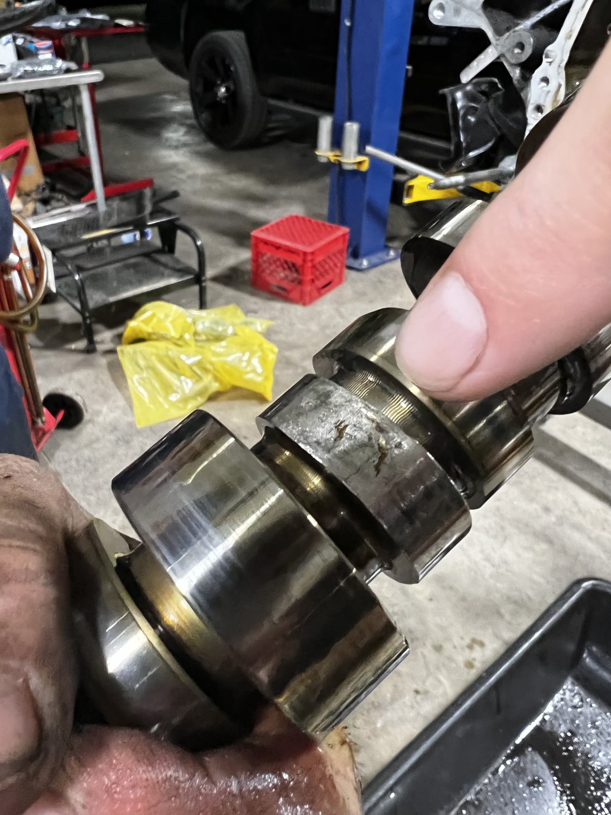

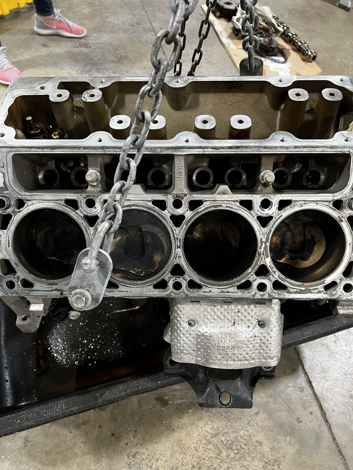

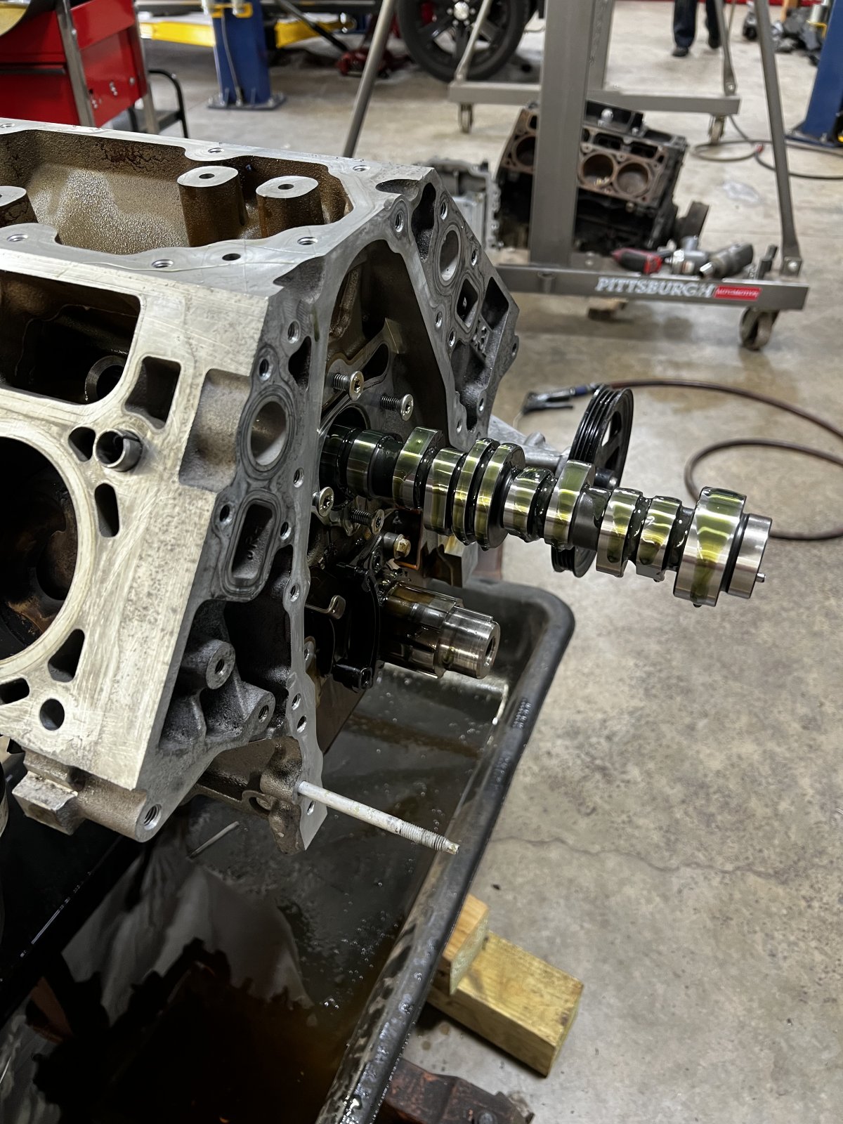

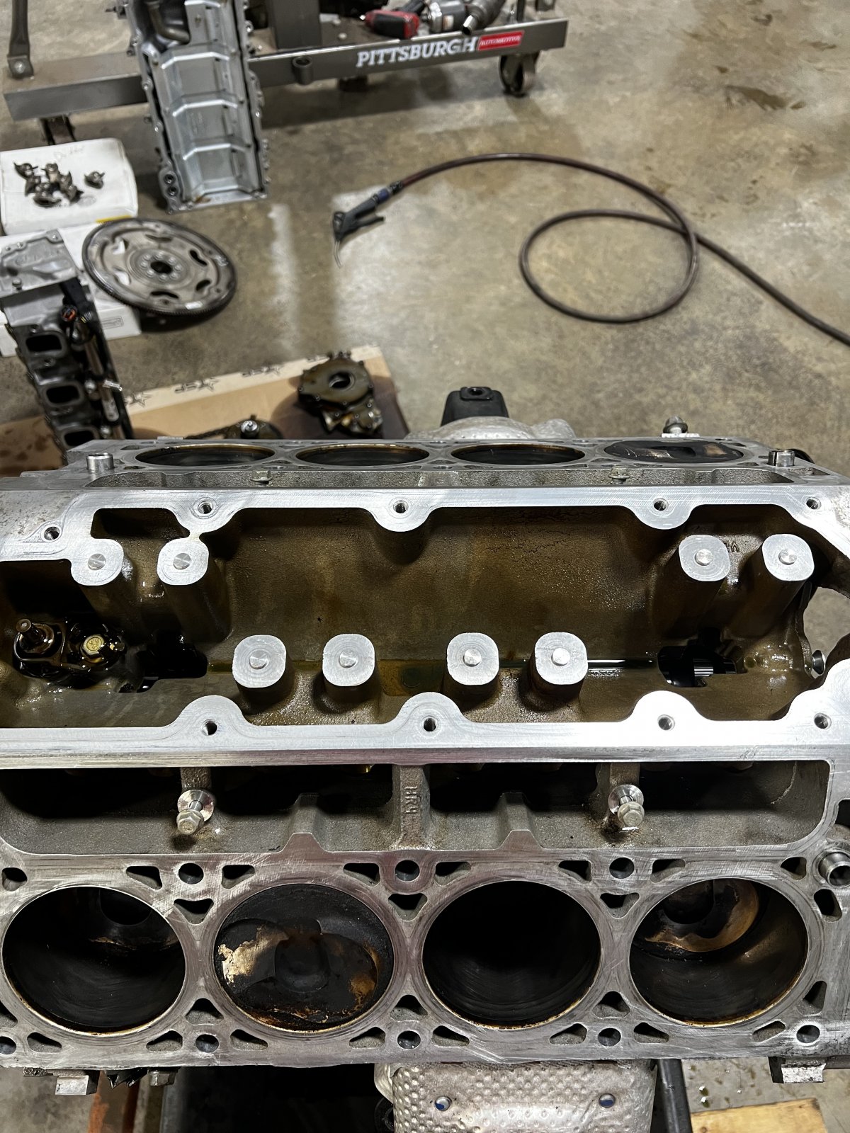

My 2015 Suburban (5.3 L83) has 139,7XX on the clock I just did the DOD delete kit on it. I too heard a crazy loud tapping noise and was receiving a misfire code on cylinder 5. Pulled the valve cover and head and found that I had a lifter that broke up into a few pieces and also scorched the cam. The lifter that went up was not one of the DOD lifters, but nonetheless it came apart.

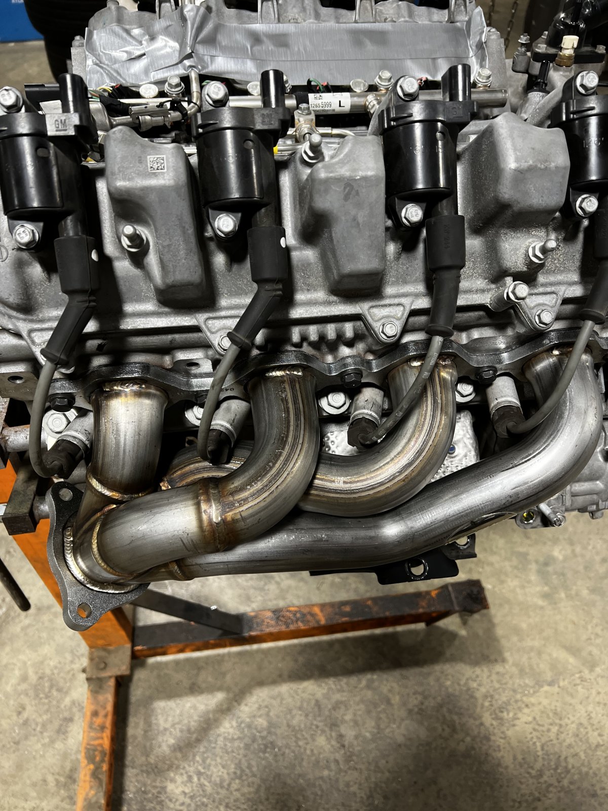

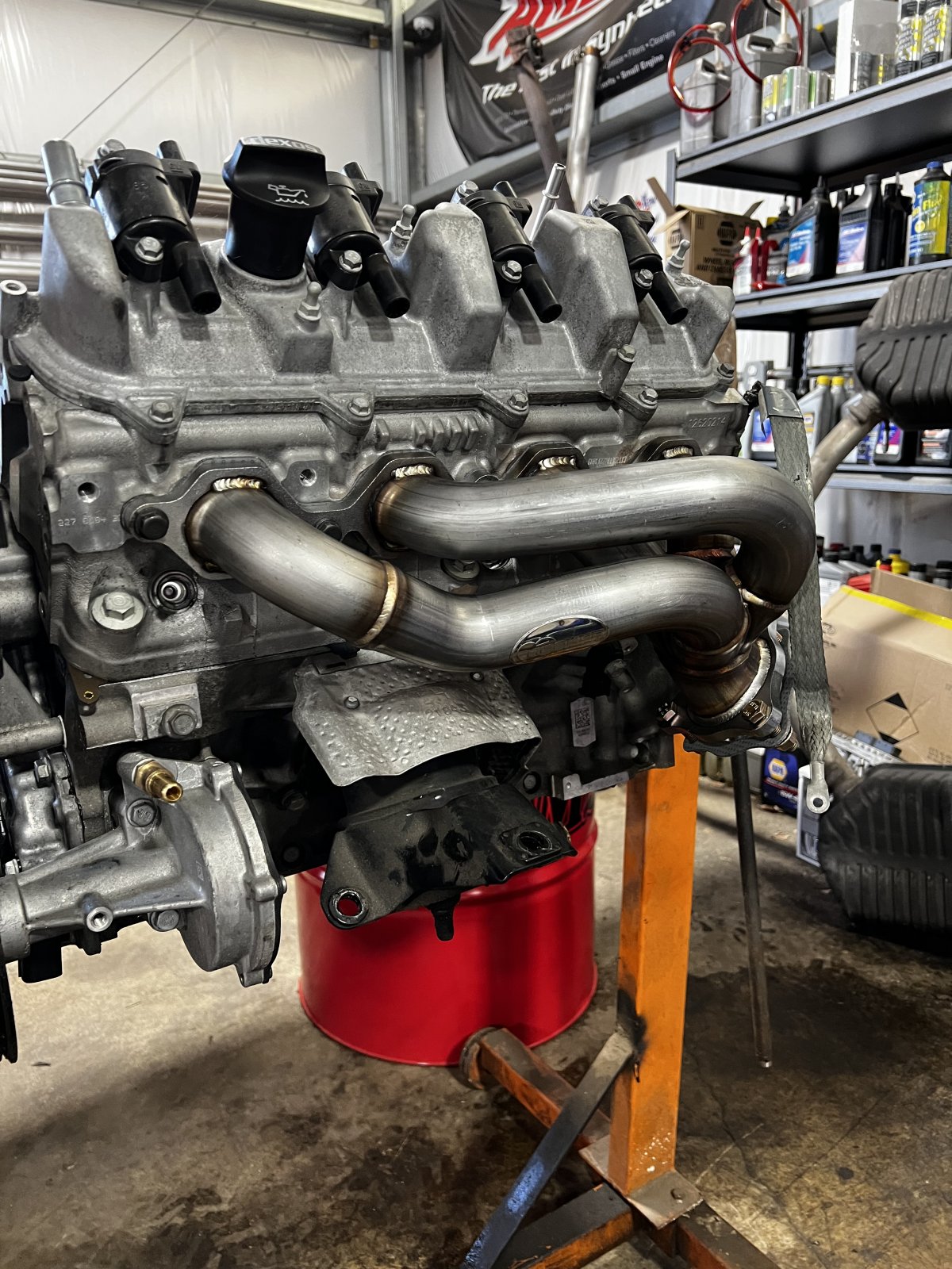

I purchased this DOD delete kit and she is now back up and running. While I was at it and had the motor completely out of the vehicle I replaced every gasket I could I think of to include the rear main seal. I also added the Volant cold air intake along with a set of shorty ****** headers. I will say that if you do the headers order new plug wires because a few of the factory plug wires (particularly 3 & 5) will sit right on the header and obviously burn through.
I have a bunch of photos on my Facebook page and can certainly share some along with any struggles I encountered along the way if anyone would like to see them.
Thanks for the information there. I'll be looking into the kit and see if my guy can do all that for me. That's a little out of my range honestly. Weird thing is it has not thrown any codes...
Yes please share. What shorty header did you go with?

I went with Hook3r. For some reason when I spell it correctly it turns it into a serious of asterisks. I put the link to everything in my original post. I will post pictures later when I'm back home.
