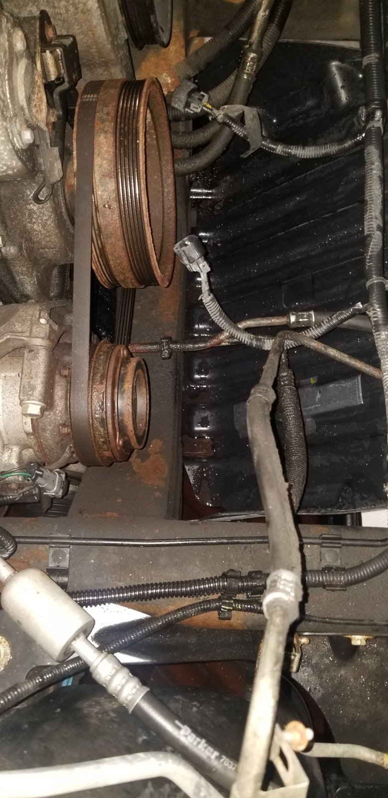

I believe I replaced the serpentine belt about 60K miles ago. It looks to be in good condition - should I still replace it?
I wouldn't bother.

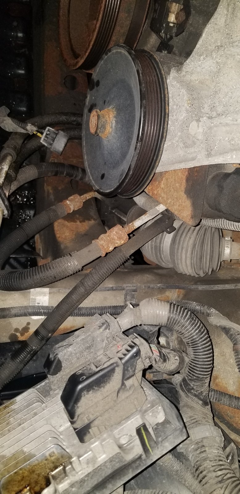

Early in the discussion, I mentioned I did an electrical overhaul by replacing battery cables (have the positive to the starter still left), cleaning up all of the grounds, fuse block, etc. There is one ground strap going from behind the engine up to the the firewall area on the driver's side - I'm having some trouble getting to the nut behind the engine - any suggestions? It's almost like that strap is not completely flush and getting in the way of my wrench getting in there in an already tight space. . Maybe I need to try a swivel?
I wouldn't bother. It's easier to add a ground elsewhere. It can only help as then the body will be extra grounded. I did a Big 3 upgrade (1/0 gauge) that turned into a Big 5. I used the original 4 gauge battery ground as the body-to-engine connection, ran from a bolt I added to the cowl to the factory ground location on the front of the RH cylinder head. I made my own cables, but you can buy a pre-made battery cable from the auto parts store. Add it to that stud on the firewall or any other and run it to wherever is convenient on the engine block and just leave that flat braided one alone.

Thank you so much - incredible info and exactly what I was looking for! I really wasn't sure how long these things would last, but that gives me some confidence that you're up to 225K. I think I'll just leave it then and see how it goes.
180K... 225K... That's nothing on these things with basic maintenance. I've had mine since ~146K and have NOT been easy on it. I cammed it at 200K and have been spanking it even harder ever since. Mine's just a weekend toy and I'm not aiming to maximize its lifespan. We've had at least one 400K+ member here and a there are a few 300K+ members running around. @89Suburban is one of the most active. I think @Trey Hardy is over 300K, too. Personally, I don't consider these things "high mileage" until 200K. But "high mileage" does not equate to "worn out". There are a few maintenance/wear items that need attention around your Yukon's mileage, and all that has been covered here.

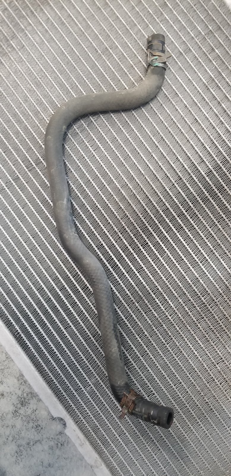

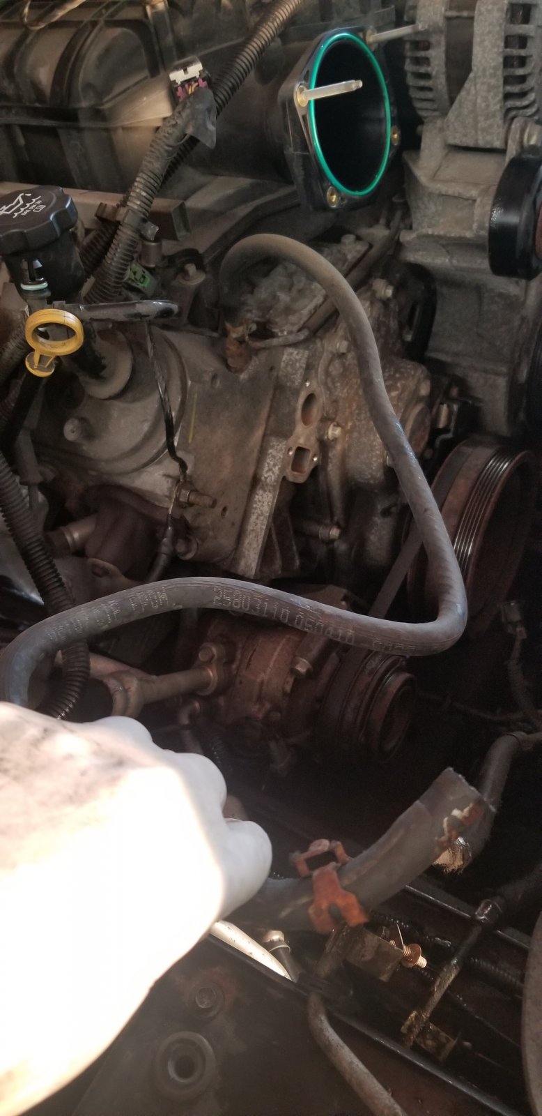

One question on the heater hoses - should I also replace the hose that goes to the radiator?
I think this was already covered, but, yes- "all the soft parts".
