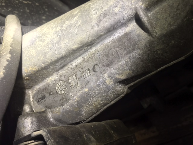

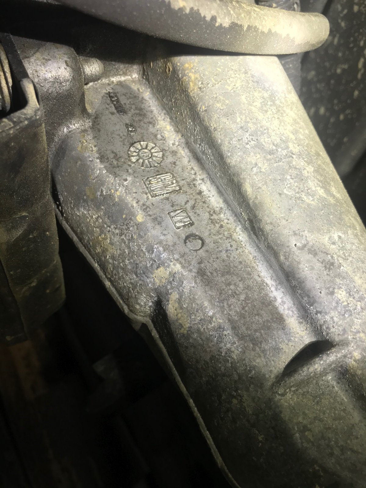

Looks like it's time for a new one. Funny thing, that looks like the seal on the back of my transfer case. If I'm reading the books right, yours should look completely different. I'm coming up with 8677268 for yours and installed with J-21426 but could be wrong.
Is that the part number for the transmission extension housing or the seal? The trans extension housing I purchased came with the seal already so maybe I have the wrong trans extension housing?
Anyway to determine the trans extension housing is correct other than with the dealer?

I believe you should be looking at the output shaft seal, the rear seal on the trans itself. That much fluid means to me that your rear seal is leaking pretty good and filling the extension housing up and then leaking out the back of it. It should only get a small amount of fluid in it. Every time I have pulled my trans and separated the extension housing there has only been a small amount of fluid in the extension housing.
