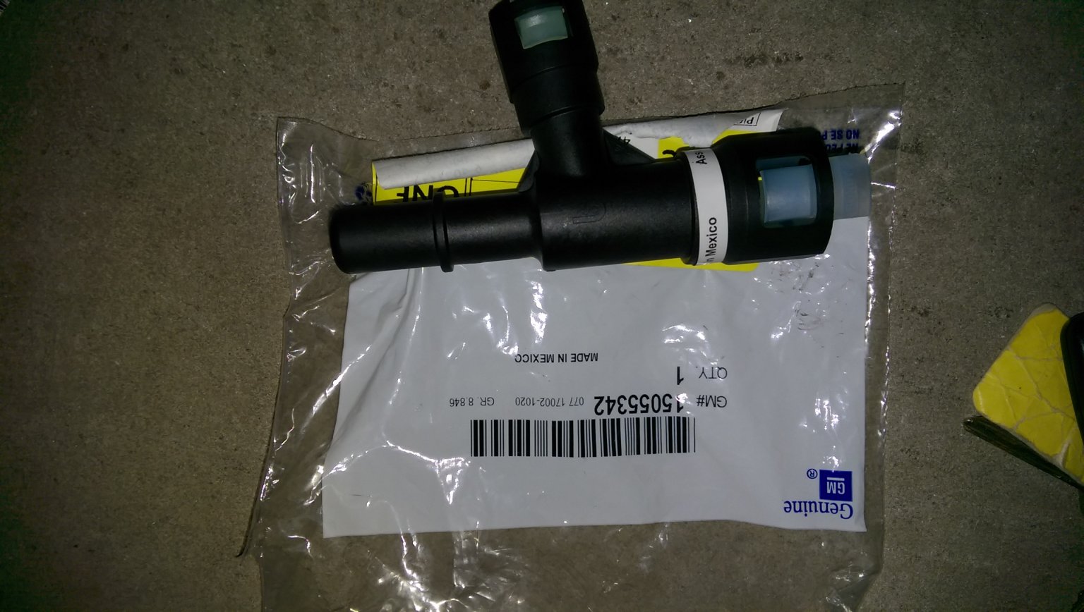

I noticed a leak and after a week of looking for it I found it was the heater hose. It was actually the plastic y that has 2 hoses, connects to the firewall and the reservoir tank to the engine. Dealer part and cost me $110.

This part?

Yea heater hose was one of the suggestions my dad had when I told him about it.

Its not only a dealer part. Dorman makes them, any auto parts store has them as well as rockauto.. Did they give you a big ol kiss on the way out for your $110 coupling?

Well damn now I feel like an ass @Tonyrodz yes that's the part, I didn't check much only went to Autozone which is a few min away and couldn't find it so I just went to dealer, it did come with hoses and clamps aswell.

When I bought mine, that was the only part, no hoses or clamps. Maybe you bought some kind of repair kit. The exact amount I paid was $19.87.
