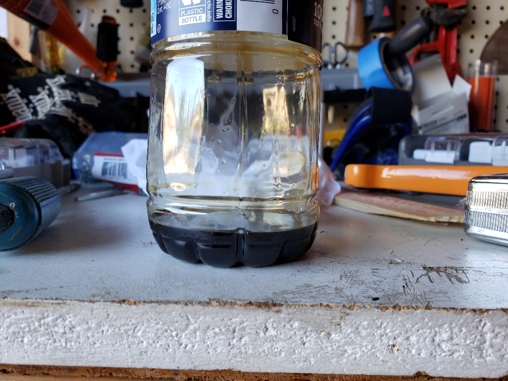

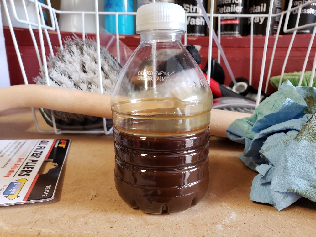

Nope. My wife's truck is a garage baby. My F150 has a JLT catch can on it, it lives outside. No issues in 10000+ miles.
I'm more concerned about how the 5.3s intake valves look after 40000 miles of oil vapor building up. DI engines are notorious for it. Ford addressed this with dual (port and direct) injection on the F150 engines. I still run one on my truck.
This is a little over 10000 miles of catch can collection from my 2019 F150 5.0. All this will not be going back through the intake manifold to be burned.

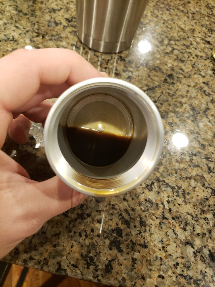

About 3 weeks of the JLT can being on the Yukon and its half full (3oz total compacity) already. Full disclosure, my wife drives a good bit of highway commuting so makes sense. I'm gonna have to empty that thing once a month.
