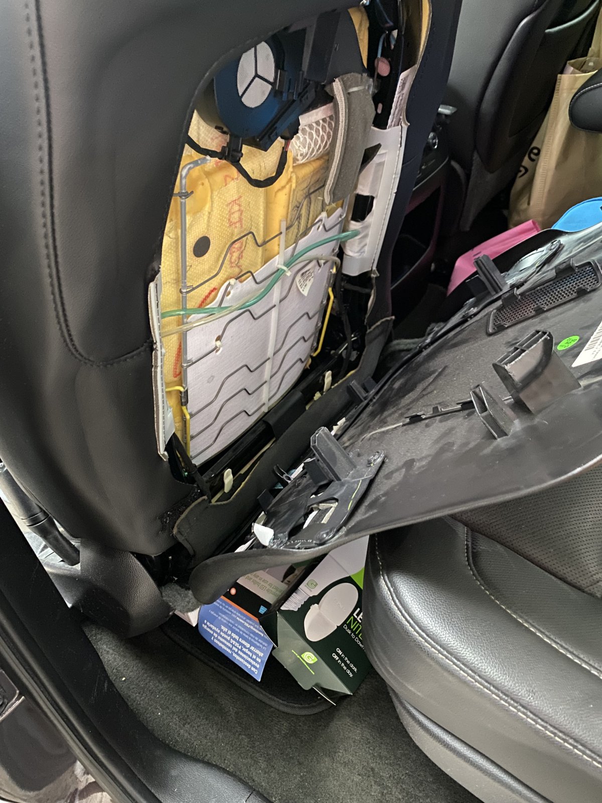

You have to replace the seat back. It either stretches out the plastic tabs that hold it on or breaks the bend on the end of the tab off.

Is that a 2015? It seems to be a pretty common problem, my 14 sierra had the same problem. I put newer model seats in it that don't have that hard back piece.
Yup, 2015 Yukon. Something def seems broken tab/clip wise. When I get it back in place the bottom carpeted part is never flush. The passenger side, pic attached, is flush at the bottom. IMG_0738.jpeg

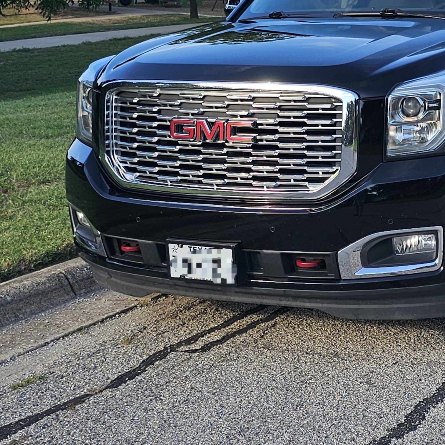

Swapped out the stock Denali grill for a black one today. This was a pretty cheap one from AMZ ($170 or so delivered), but everything lined up nicely. Couple hours and 2 beers. I actually like it with the stock red emblem. Slowly de-chroming, but it was too humid to paint today. Mods keep me busy...

Yep that's why I got newer version of the seats.
I saw a couple cool ideas on YT for a zip tie fix.
How much disassembly is required. I’m going to do this before summer is over. I got wrap for the window frames and fog lights but may go with painting instead. If I paint a grill I’ll probobly paint, but with a grill like yours I think wrapping might be more uniform.
it wasn't hard. Had to pull the whole front bumper cover. 6 screws and 6 pins on top, 7 screws around each wheel well, and 8 screws and 2 pins on bottom plus a couple tabs. I had all the fasteners out in about 20 minutes (just have a 10mm, 7mm, and t15 ready to go), then pushed out clips for another 20 minutes. The damn connector for the fog/front sensors gave me more hell than anything. Swapping the actual grill and emblem was another 15 min or so just popping tabs. I plan to use hyper dip piano black for the fogs surrounds and door/rear moldings...
