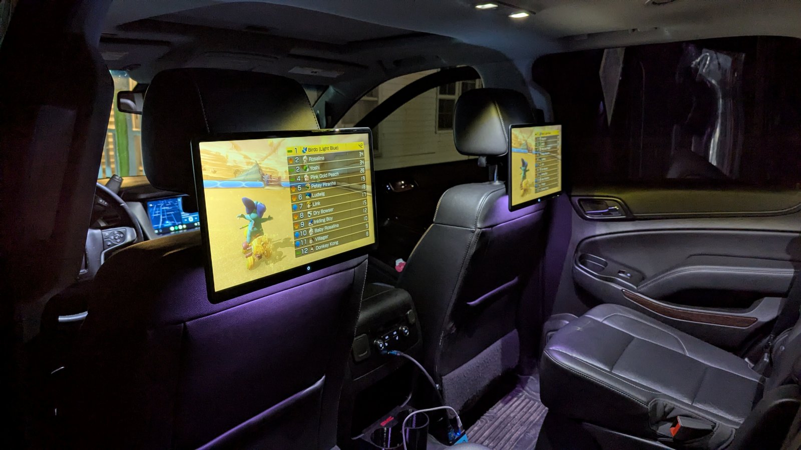

It looks great. What is not going right? Maybe I can help you.

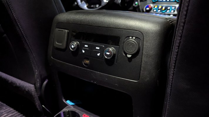

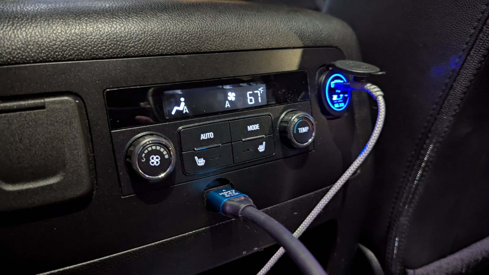

Basically, I'm stuck using USB-C for charging with a separate HDMI port for audio\video. The original hopes and dreams were to have a dock in the center console, with one single USB-C connection for charging, A\V, USB, etc. The problem is that there are very few docks that work with a Nintendo Switch and a Steam Deck\Ally\Legion\Laptop, the only one that really fits the bill has a male USB-C output. Due to USB-C's design, a female to female adapter (coupler) can't exist. It can ONLY pass power (not data), and only in one direction...so it will only pass power through with the cable plugged in one way. I guess a lot of the reasoning behind it safety. With a female to female adapter you can basically make a USB-C to USB-C cable as long as you want. Since they are carrying a significant amount of power to charge devices (PD power), the cables aren't rated to carry that kind of current over long distances. Worst case scenario there could potentially be a fire hazard, melting wires, etc.

Maybe this weekend, but in short I wanted to hide this in the center console: https://a.co/d/bB3fl7H
Then plug it into this adapter:
In theory, this would make it to where I only had to plug in one USBC cable whenever I brought a game console(or laptop) into the Yukon. The problem is that second adapter doesn't work that way, and there isn't one that works that way. That second adapter will only work for charging, no data.
Edit: I also finished them last night. Had to modify my wireless charger's add-on harness so I wouldn't cut too many wires on the stock harness. I ended up only need to cut 2 of the stock wires in the entire project. Also, the power hungry USB-C charger is now on it's own circuit. Came out great!

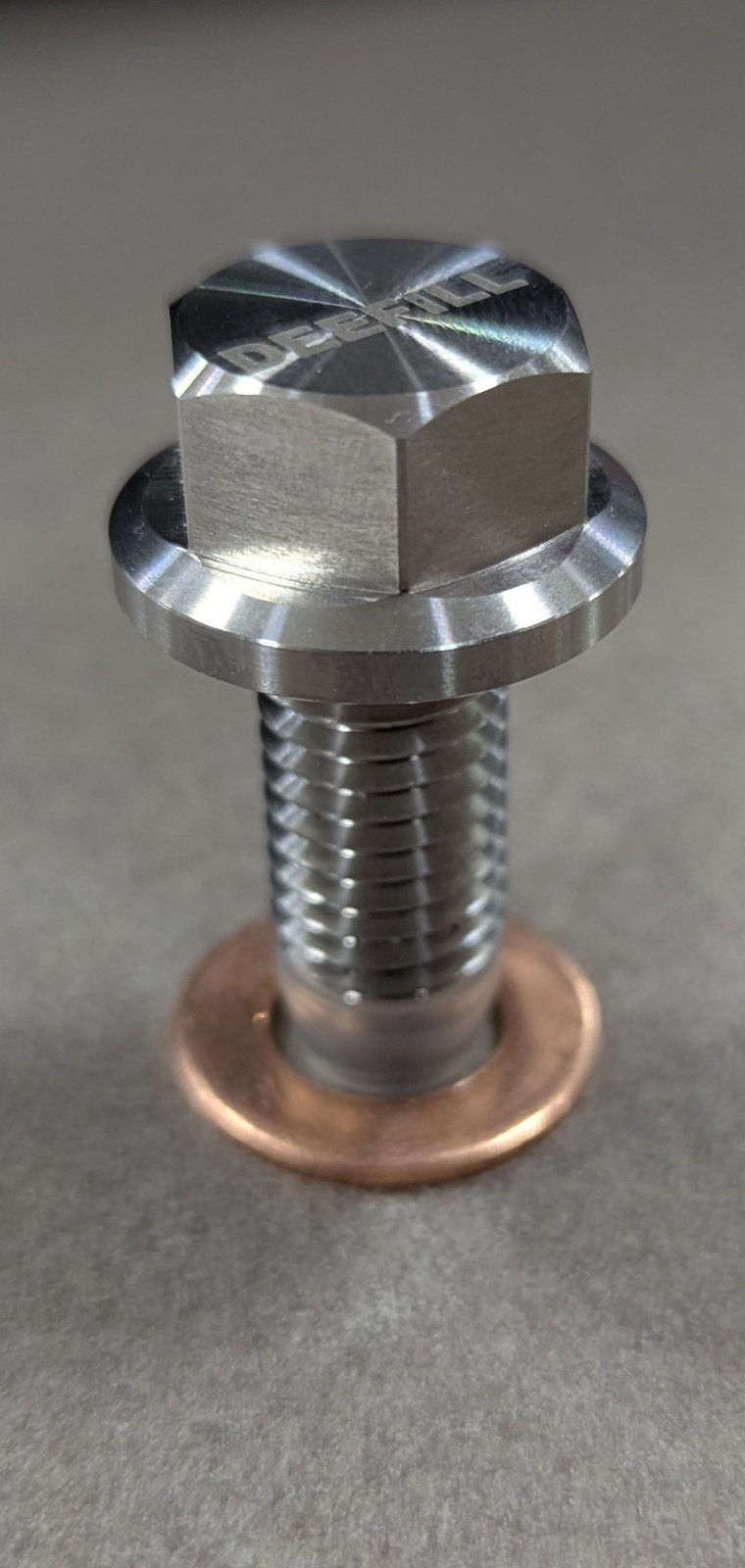

Watched my son change the oil for the first time by himself. Only forgot the "Push against the drain bolt\oil filter while you loosen it so it doesn't suddenly drop and start draining and spilling oil everywhere" rule once, on the filter. Everything he did exactly by the book, even drained the catch can. He installed this new drain plug that is the fanciest looking plug I have ever seen:
Fancy, right? Too bad it leaks. He torqued it to 18 ft pounds and it still drips slowly, I think it's that copper crush washer. Today after work I'm going to try a Dorman 097-116CD gasket on it. We are going to try the shopvac to the oil cap trick to keep the oil from leaking out during the gasket swap. Here's hoping that goes well.

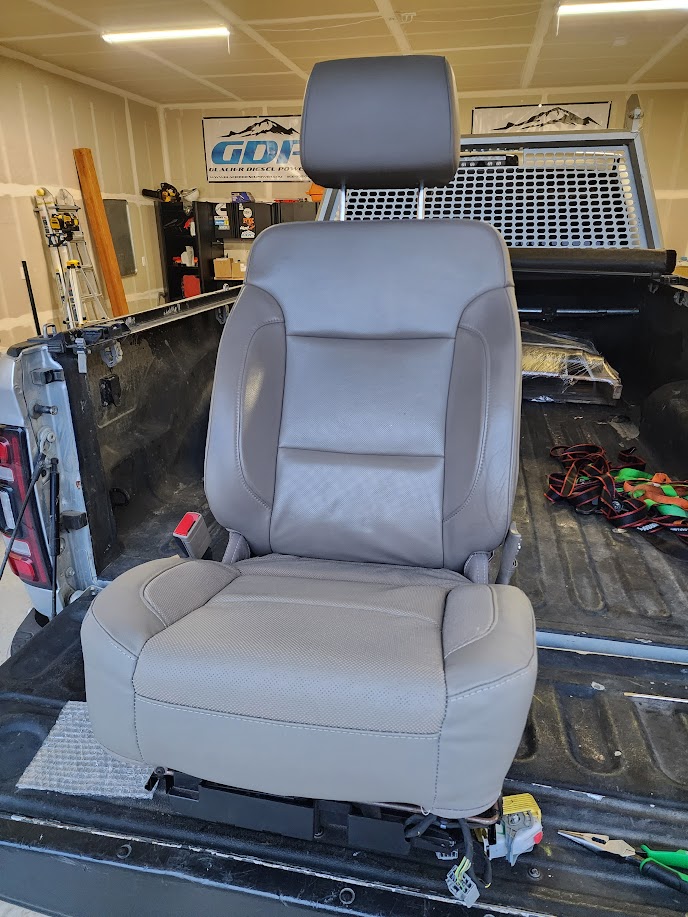

And after fully rebuilding the bottom end of this seat, new cushion, new leather, new heater / ac ducts, new vibrators, got it sitting back in the burb all nice and happy. And honestly, wow. What a difference. the durafoam from the seat shop makes a gigantic difference. And the color match on the leather is nearly perfect. Highly recommend everyone with the bad stock seat cushions to replace them with the durafoam. Takes about an hour per seat, but it's worth it
