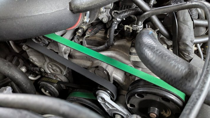

Flushed coolant a bunch of times. went through 12 gallons of distilled water. After that, my son changed the tensioner and belt. He looked up the torque specs, set the torque wrench, everything!
Also...a little test fit and function test....

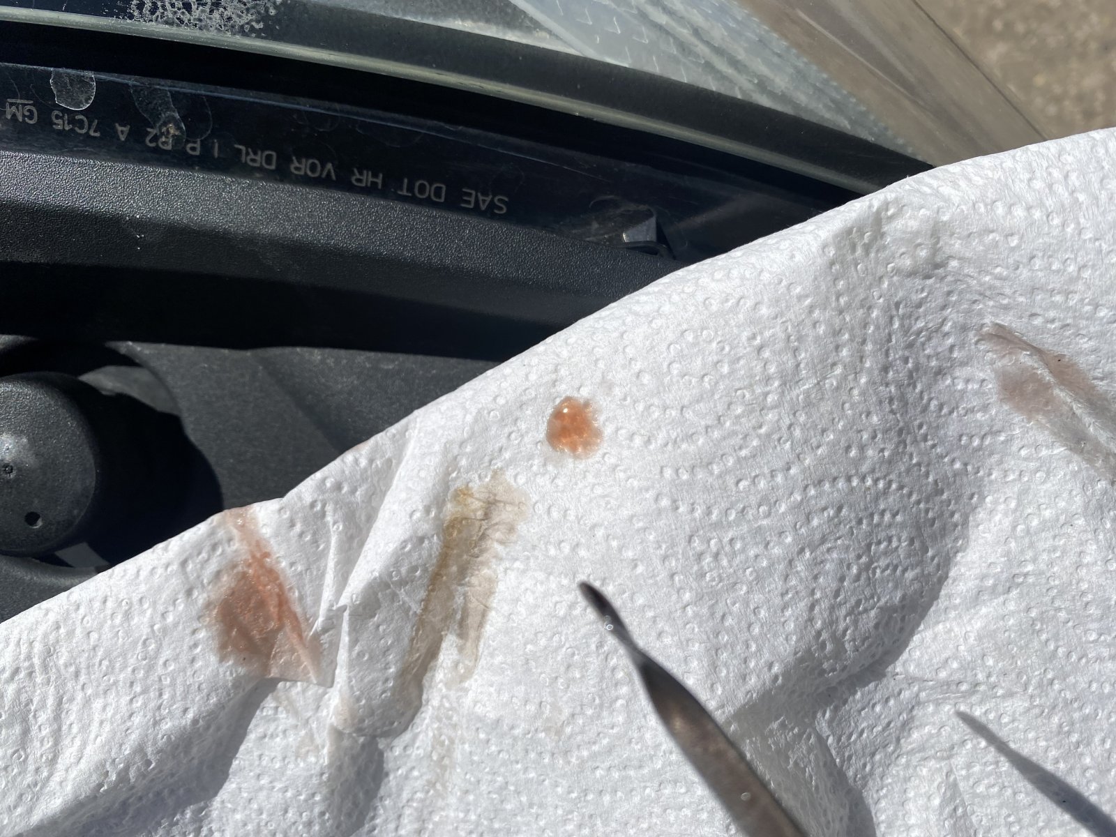

I tried to data log for my BB tune today and my autocal won’t data log for some reason. I messaged BB so it will be a day or so before I get a SZ response. Definitely miss the old in person tunes. Would have been had this done if that was the case. I imagine due to the errors and only being able to play around with this every other weekend, this will be a long drawn out process. Couldn’t retrieve current tune either as IMG_1498.jpeg message indicates “file system full”. I just check the trans fluid, changed my air and cabin filters to make it feel like I got something done this weekend :( I guess it’s pinkish
