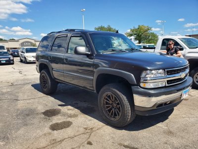

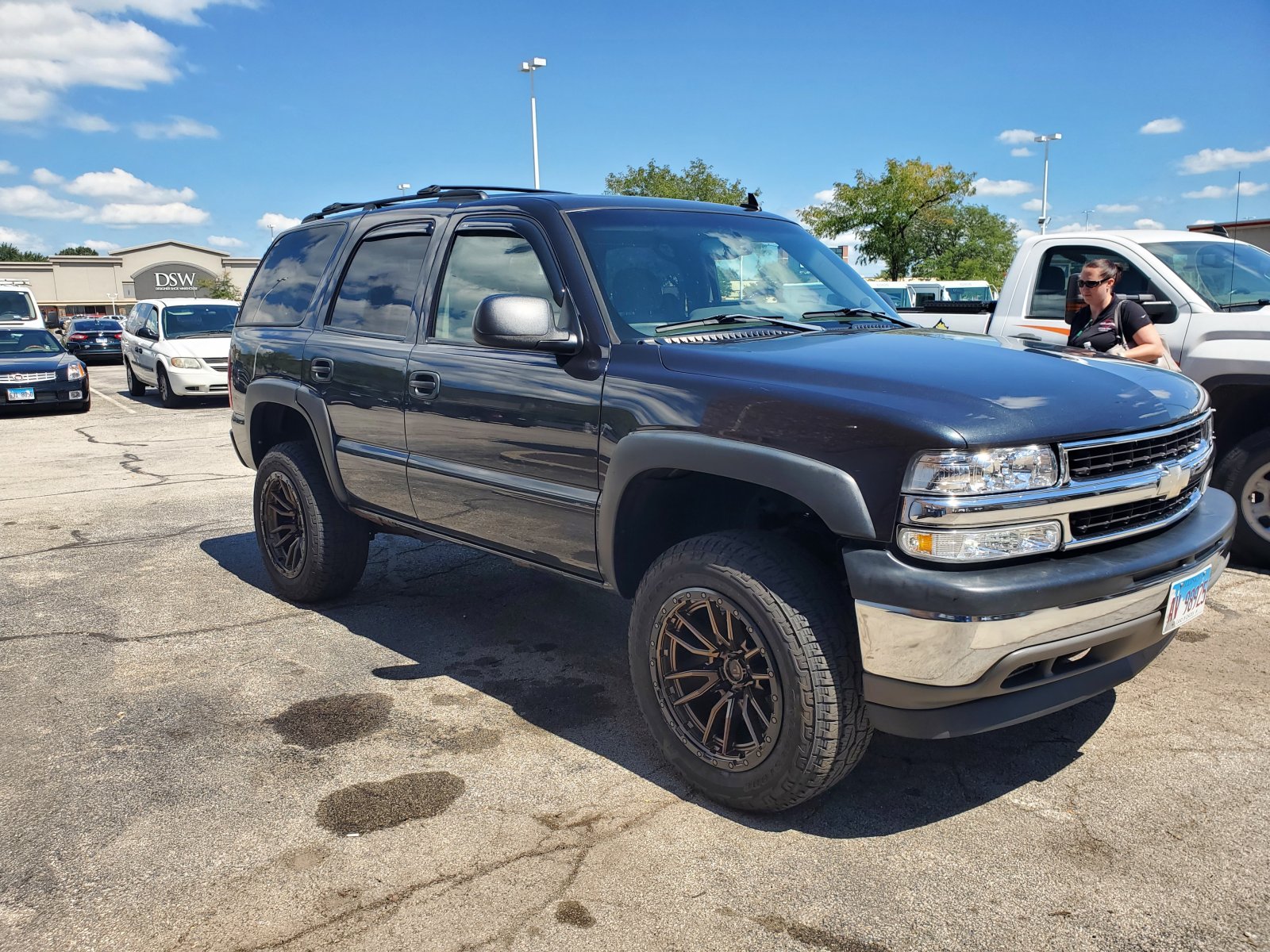

You're raised correct? I see you have added a pad on the LCA itself to make up for that? I also see stainless brake hoses and Billstein shock upgrades. Nice.
its lifted 3" in the front, keys cranked to about an 1/8" droop left. Also, I just did the 900 brakes the other day.
