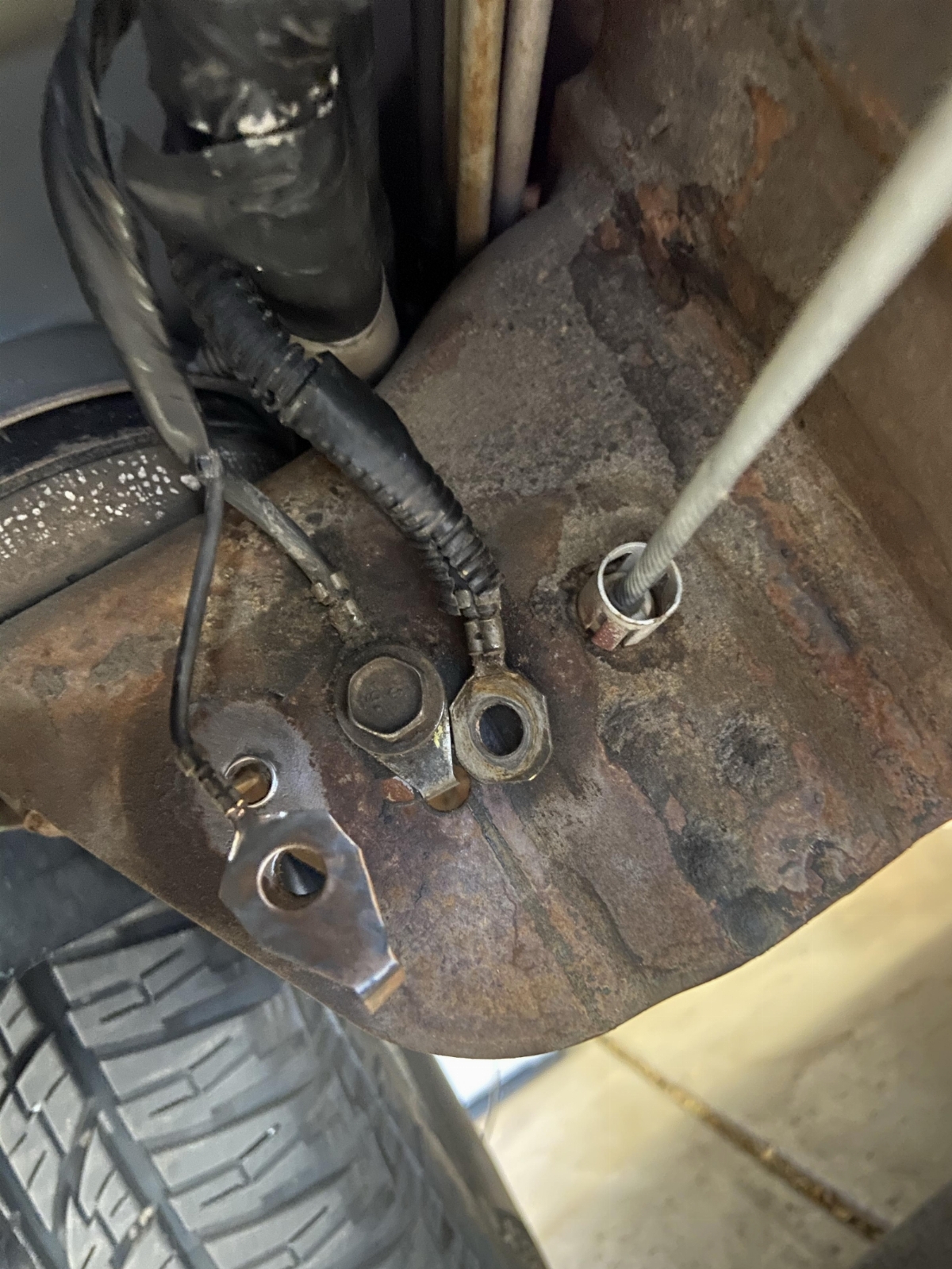

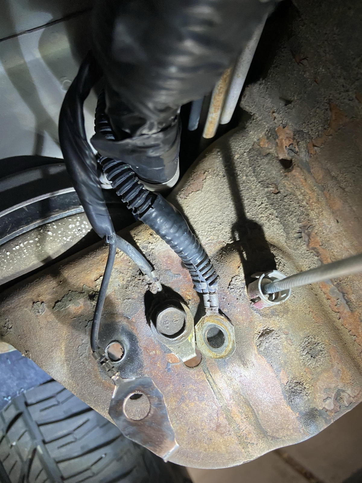

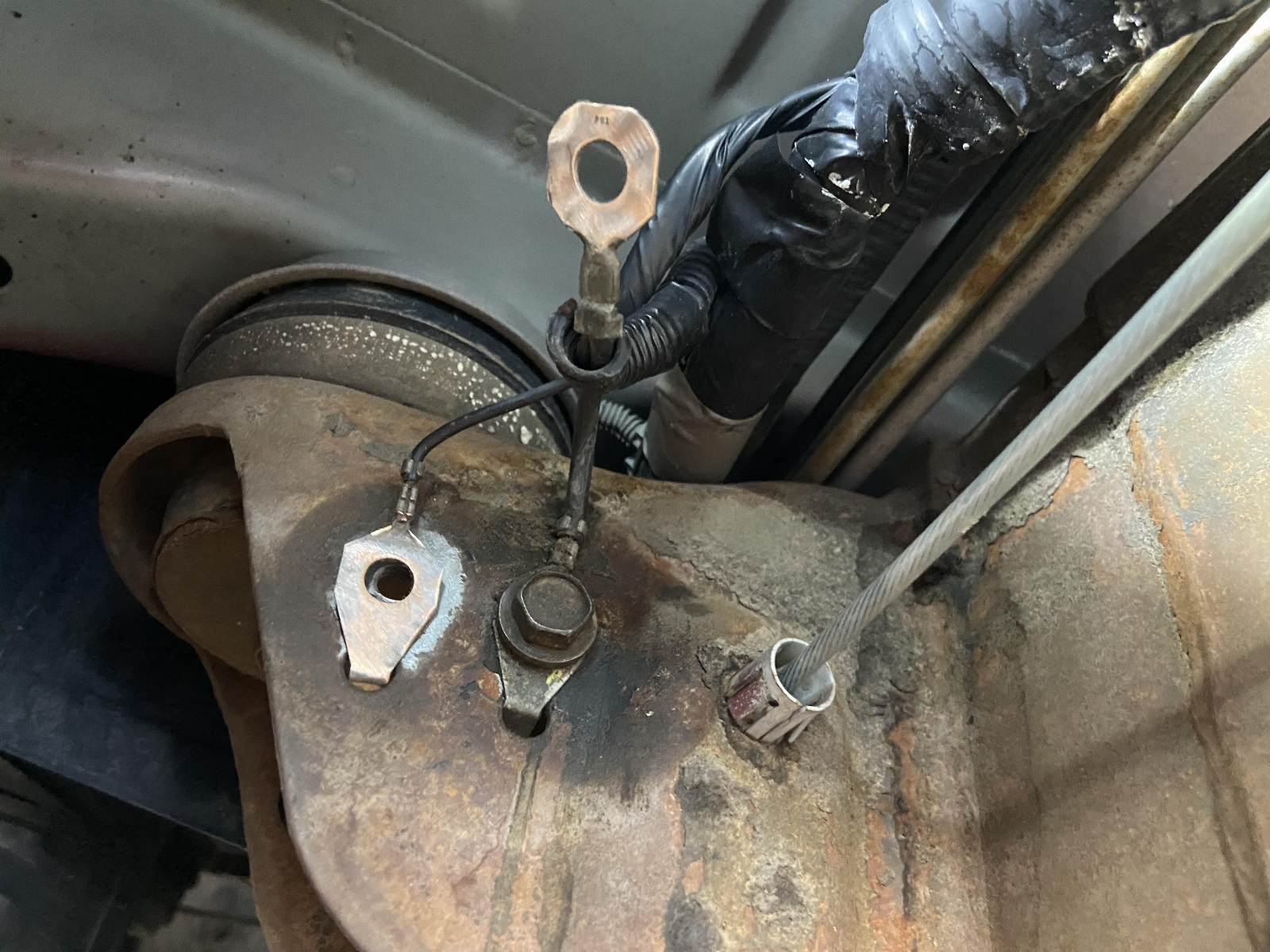

Check these people!. I REPLACED CORRODED TAILIGHT HARNESS ON LEFT SIDE that connect to bulbs. connectors burnt! Check them people!
