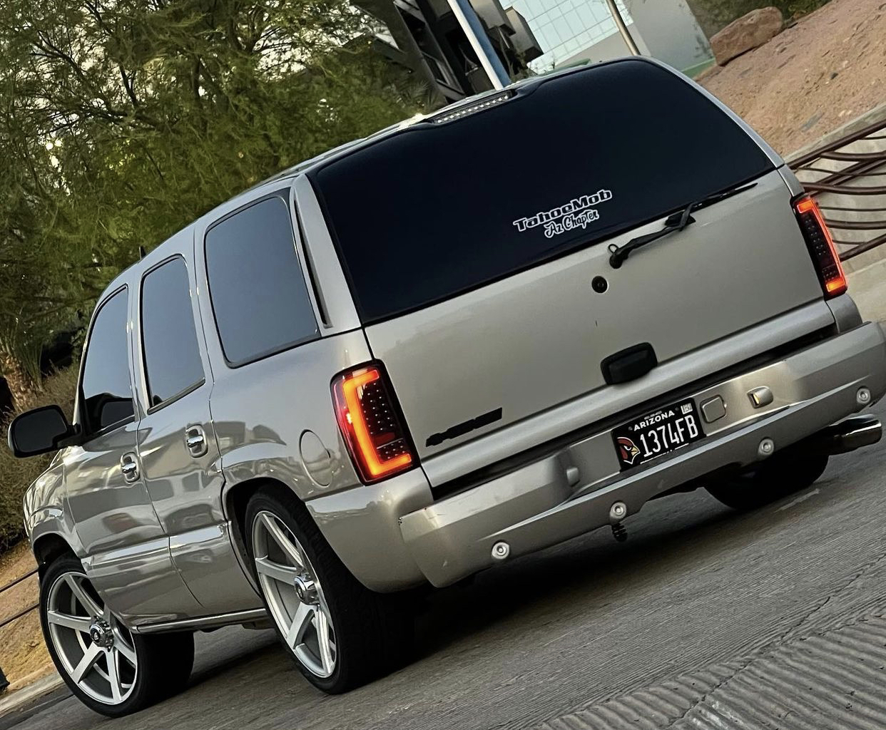

So today I was fixing the squat I had. The rear fender was 1.25" lower than the front but after you take out that the front fender is .75" higher, it was a half in higher in the front. So decranked the keys and literally got it perfectly level. Before I did this I noticed my UCA's were hitting the droop stop even on a level surface, so I did this today 1.to get rid of the squat and 2. Put less stress on the front end. So now it's down a half inch. I went to look at the UCA and it's still resting on the droop stop but I measured to check again and it definitely got lower. How does it get lower but still rest on the droop stop?

It's supposed to rest on the jounce stop. It acts as a fulcrum on the torsion bar. It's part of the design of this type of suspension.
I understand that, but im talking about the piece that prevents too much down travel
