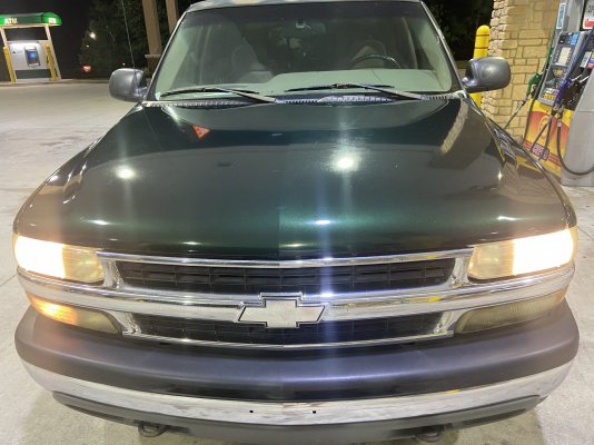

So after owning my Yukon for one year, it was time to renew my registration and get an annual motor vehicle inspection.
I surprisingly failed for the following reasons:
  • HID Aftermarket Low Beam Bulbs
  • Right Turn Signal Activates Hazard Lights
  • Excessive Play in the Front End
Apparently HID lights that are not OEM have been illegal in Massachusetts for the past three years. So I had to go get a pair of incandescent bulbs and "install them for a re-inspection". The HID lights were in the Yukon when I bought it last year. The dealer I purchased it from handled the registration and inspection, so the inspection station either missed the lights, or looked the other way for the dealer.
