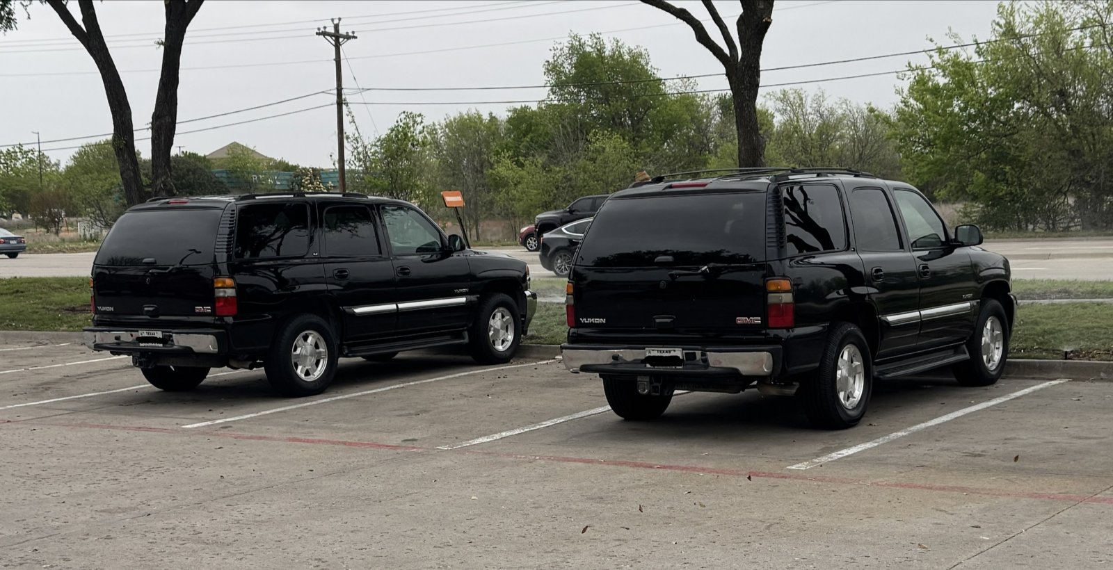

I swapped in Z71 springs and 2" spacers, kept the factory bar, and I don't think the driver's and passenger sides are different by even 1/4". Like you, I swapped out the sway bar links, I used ones for a 3" lifted Jeep Wrangler.
Glad to see you zip-tied the E-brake cable, as opposed to letting it dangle free. Zip ties kept breaking with mine, I finally used some 2" wide Gorilla duct tape, and wrapped about 8 layers over the cable and bar. Has been holding up for over a year:happy107:.
What do the angles of your CV axles look like? Just installed ebay "Ford" keys on my 06 XL Denali with Bilstein 5100 shocks, and the front is sitting at 40"!!! Haven't done the back suspension yet, but I'm worried about my CV axles. Don't have much room to crank the keys down. Saw in another post that you're sitting at about 40" so figured I'd ask what yours look like.

Did I miss info and pics on this lift?
