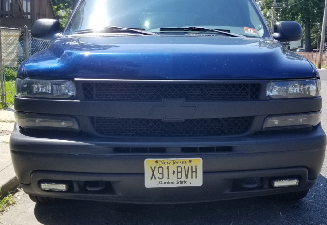

Hell yeah that’s got the front looking mean! I gotta get my HD hood soon.
Mind if I ask what getting it painted ran you?
Edit: now time for PM bumper cap and what not
