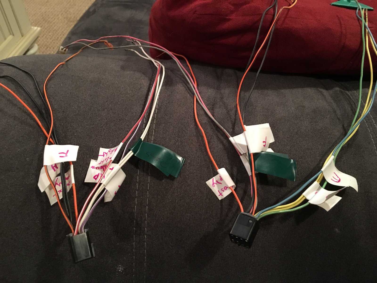

OK, I need some help. Can anybody identify these wires on my new 03-07 side mirrors? The wiring diagram I found doesn't make sense. It may be because the diagram is for the wires that are in the door and not the colors in my plugs. Even so, they don't match up to the locations in the plugs.
Old plugs and I have identified what they are.
New plugs without up/down control identification.
I need to know what the yellow, orange, and white wires are.
left/right ?, up/down ?, common for movement ?
The red and black on each set is for the turn signal.
The gray wires on each set are for the mirror heater.

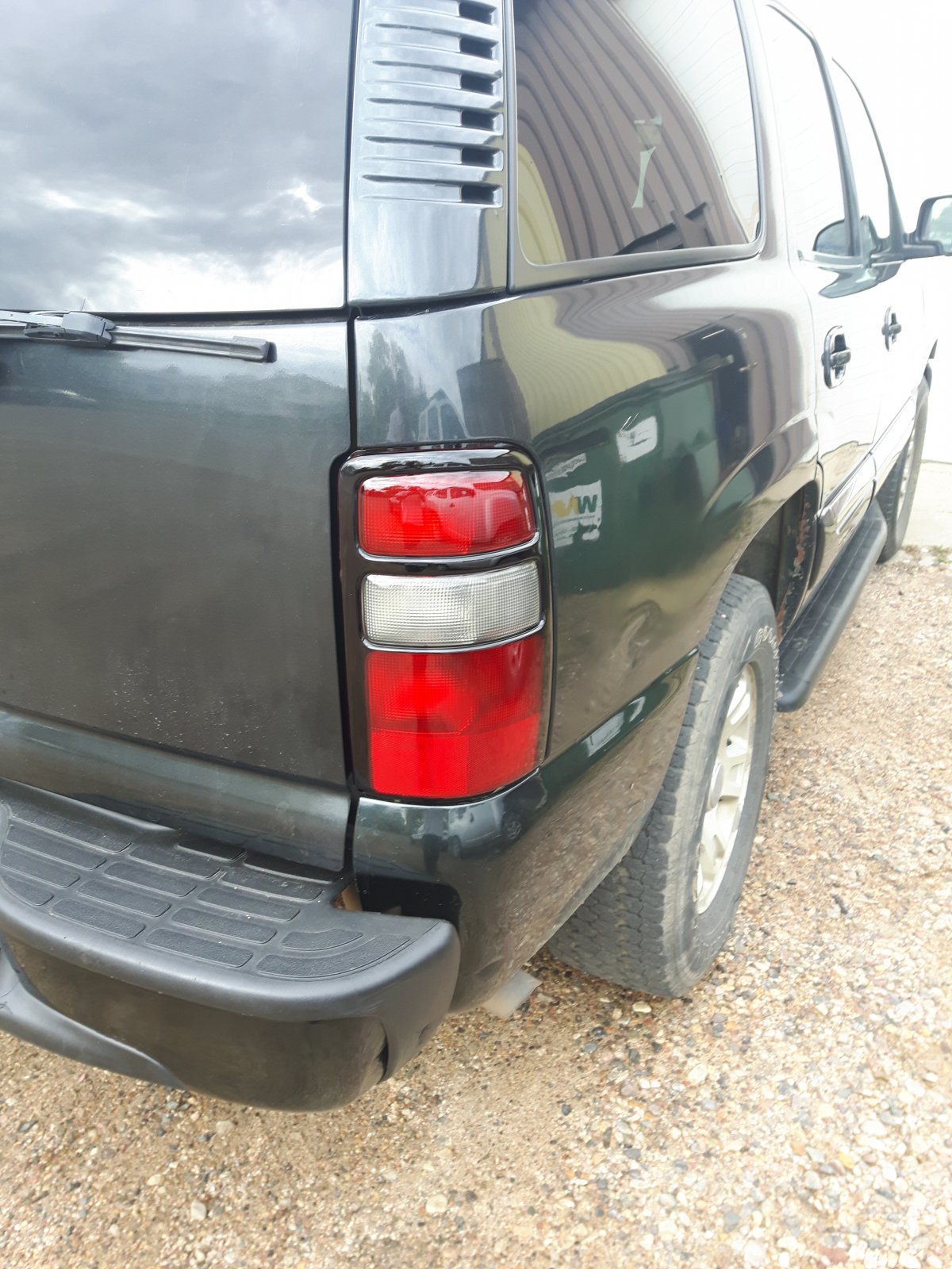

No the amber color is right in the plastic of the light. Sanded the whole light , masked of the reverse light , used vht nightshade in red sprayed the whole light , then unmasked the reverse light , and cleared the whole light. Pretty simple.
