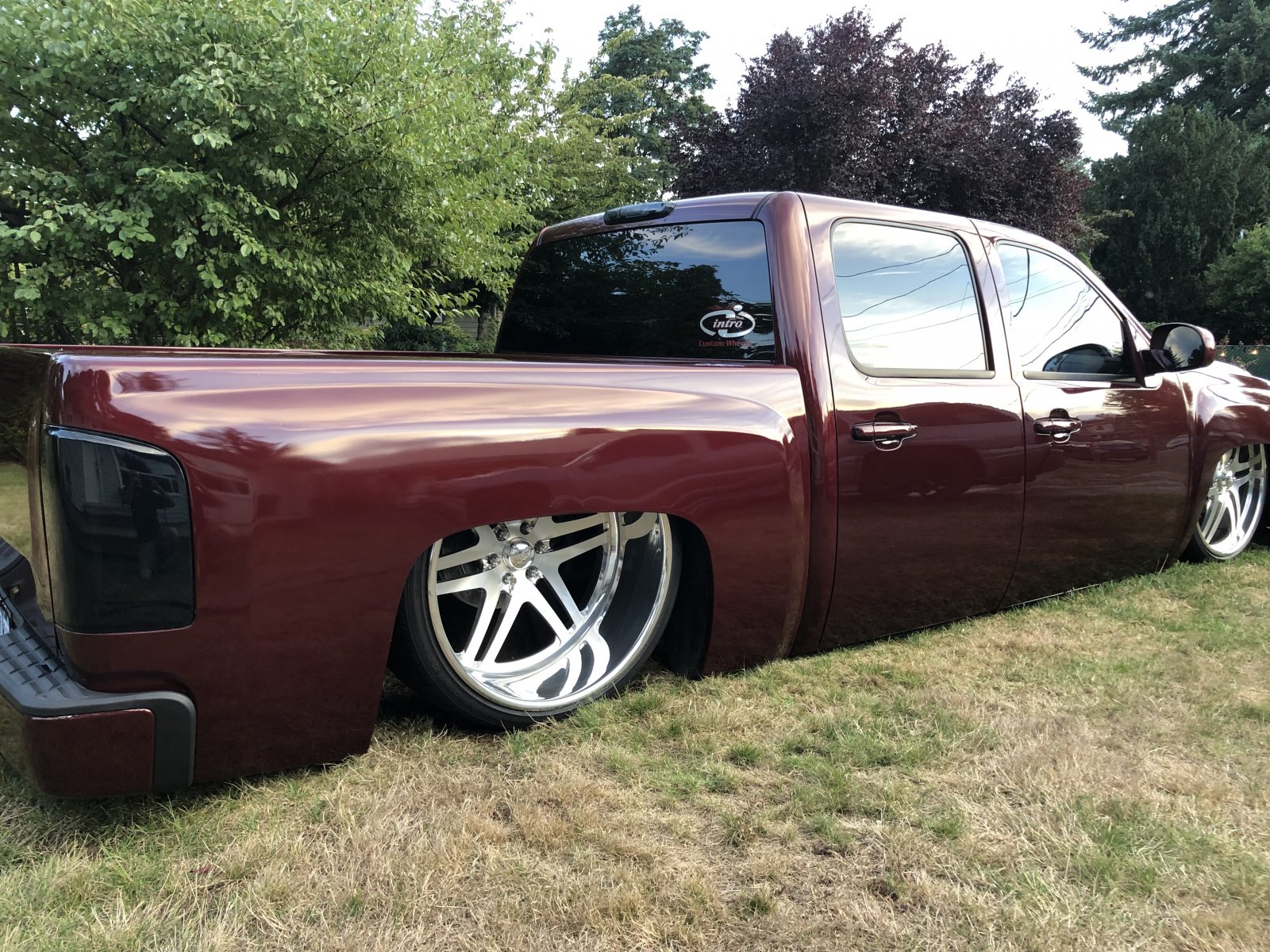

How much steering angle do you have before you have to put more air in the front bags?
Not understanding the question but I’ll try...fully aired out, the body itself lays on the ground at which point steering angle doesn’t matter, it has to come up at least a couple inches to move and also not bounce off the pavement. At that point it can drive pretty much anywhere except turning at intersections, etc. When I get to an intersection or need to pull into a driveway or parking lot, I bump the front up to turn sharp. However for 90% of my driving, 2-3” off the ground is where I drive at including the freeway.

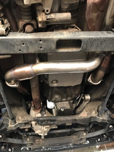

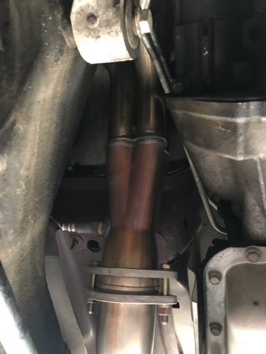

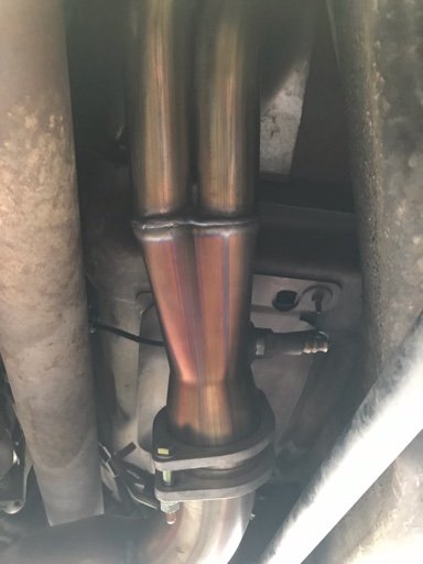

Ok, so I got the American Racing Longtubes installed last week. I had some issues directly afterward, as the spark plugs were not all fully seated, and had to figure out what the noise was and get it addressed. After installing the headers, the spark plugs are really difficult to access, and they feel tight when they are not, since the socket tends to hangup on the outside edges. Needless to say, it’s taken me a bit to get some before/ after videos. I now have the headers (with cats), and an 18” magnaflow muffler (sorry, don’t know model -think it’s: 12259) Really digging the Accel Ceramic wires (9070C). They’re the perfect length, and stay out of the way of the headers.
Here are some clips. Not the best quality, and you really need to play on a system with a subwoofer, so you can hear the lower tones.
Before headers 30-70:
After headers 30-70:
Warm start:
Stock:
Headers installed:
Headers + Magnaflow:
And a few (albeit ******, but obligatory) photos:
Next up on my list is a Black Bear tune!
Nice progression videos. Sounds great!! The Black Bear Tune will tie it all in and be so worth it. Nice work on the budget build. lol We're going ballistic Mav!

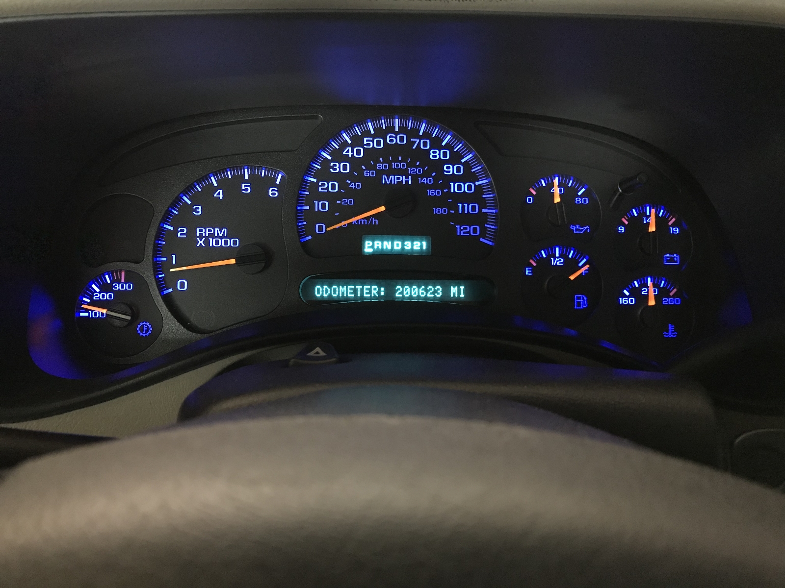

Replaced the oil pressure sensor again. Back to showing correctly in the dash. Last replacement was with a genuine AC Delco part, and so was this one. Hopefully this one lasts longer that a few months! At least it was within warranty.
ETA: regarding my replacement cluster, and fuel level, I decided to just leave it as-is. The over-full indication levels itself after about an eighth of a tank, then seems pretty accurate. Digital Dash Solutions did offer to swap it if I wanted to but I decided to keep this one, since it evens out after a bit.

My fuel gauge used to be the same before I had the fuel pump changed last fall and afterwards it never showed over full

Interesting. Well, my original cluster never showed over full, but this one always does. :shrug:
