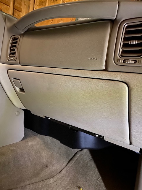

I went to pull a part and found a matching glove box, the rear pass door reflector, and came up with an A/C outlet cover for 17$
I never realized how difficult getting the new glove box in would be. That center console really shuts you down when you are trying to get the left side clips in place.
Now, I have a working glove box, no random hole in the rear door, and the dash looks better with that A/C cover.
