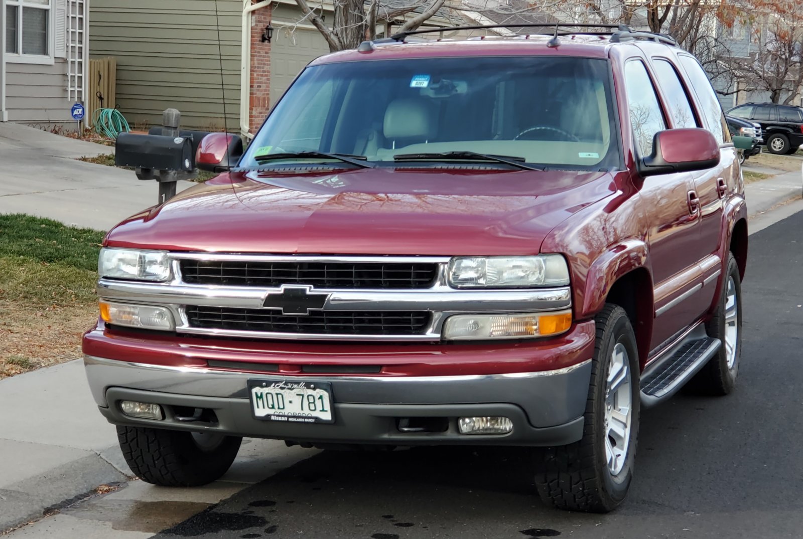

Gave her a good scrubbing; it was in the mid 50s and sunny most of the day, perfect weather. Didn't dry too fast. But I can't compete with @Sam Harris so I've given up -- clean is fine! Also washed the Fusion.
your truck looks soooo clean.
i picked up a gas power washer and a foam cannon and then got adams mega foam car wash. and then it got cold out and im lacking the time to use it all. trucks a dirty mess. ss would look clean to most people, but its also filthy lol
