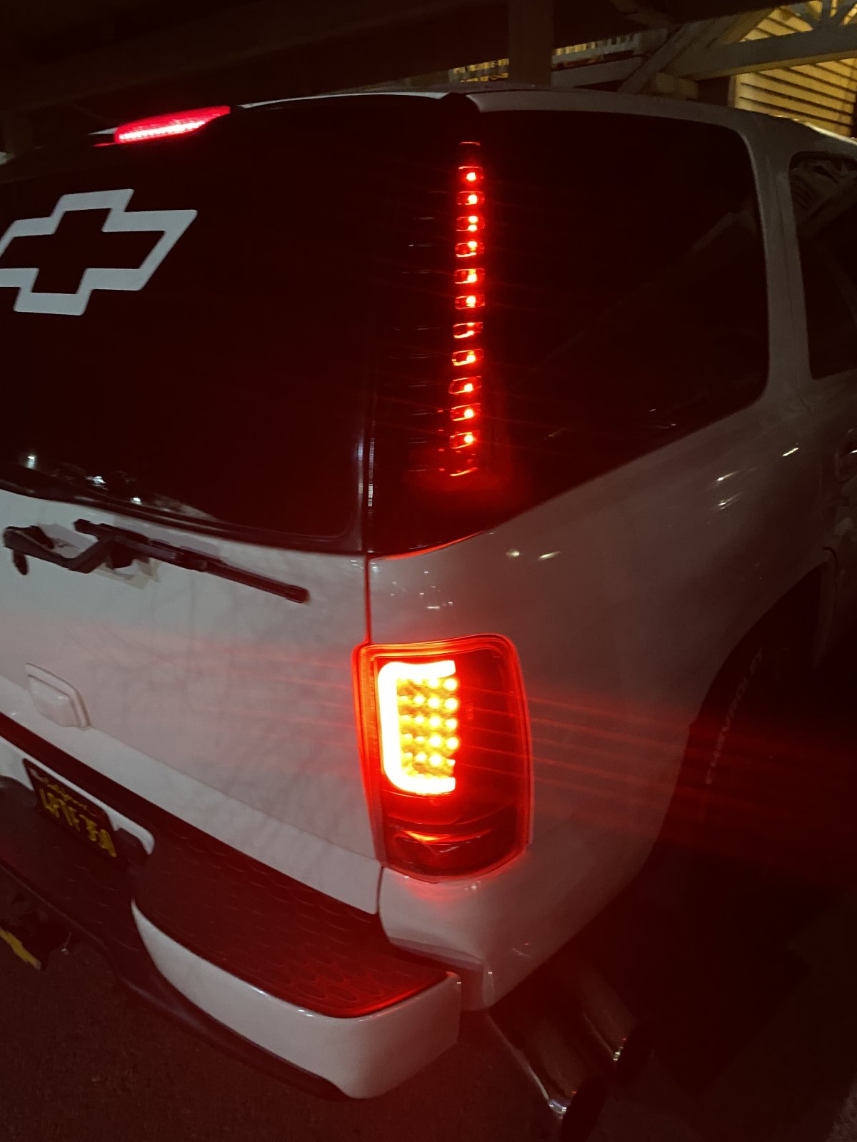

Modified corner appliqués never seen done just thought it would look cool

Care to elaborate on what you did?
Sure I cut a couple LED strips to size and with Dremel cut the center hole to match because didn’t like the way it looked with a space in the lights… you would also have to paint or cover The panel underneath because it is painted to match the body so more than likely would have to black it out. Then tap them into the third brake light because I only want them for brake light but you could always tap in to taillights if you wanted them for blinkers or regular lights and so on.
