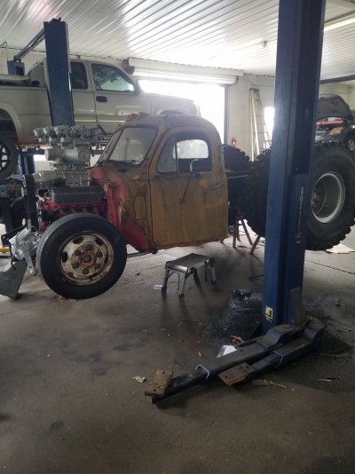

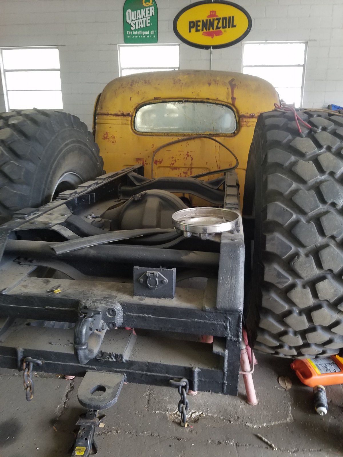

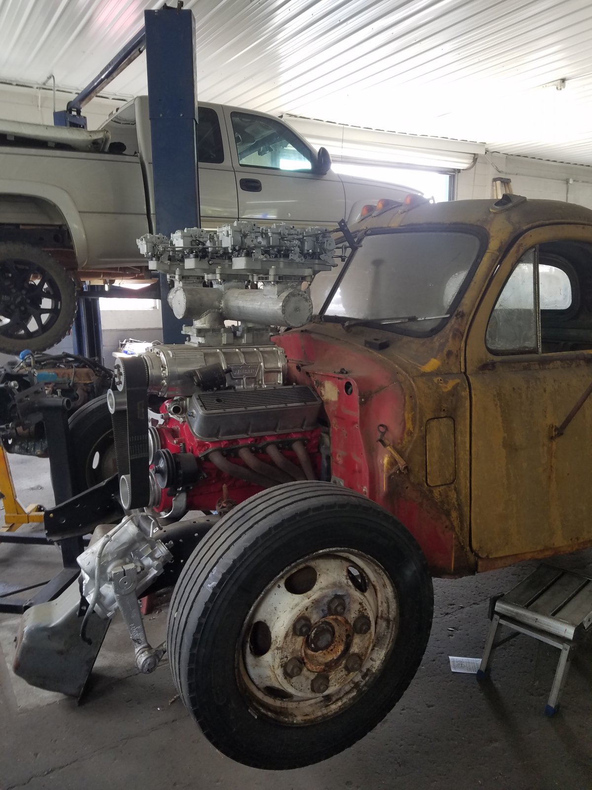

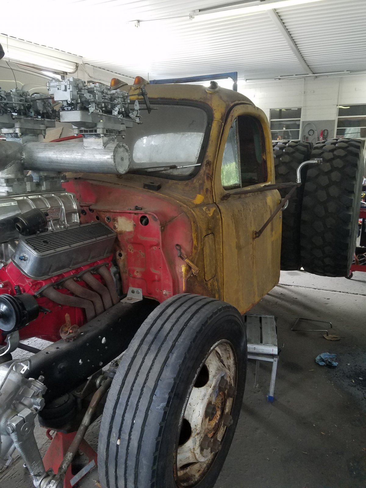

Took the Tahoe in for it's 15 day after trans rebuild checkup and saw they had this ratrod they were building - ala Mad Max.
