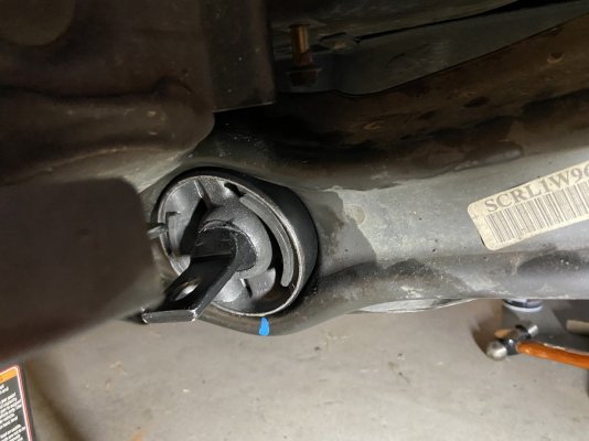

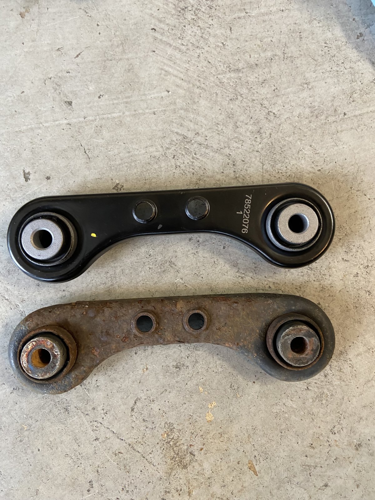

Sorry @iamdub, I got distracted starting on the Civic suspension work I’ve been putting off. I was pleased to have the trailing arm bushing taken care of, did the upper, and compensator arms, and then got hungup on one of the lower arm bolts.. it’s welded itself onto the bushing, so I’ve quit for the night, and will be headed to the Honda dealership in the am for some new bolts, so I can cut through, and replace them. I’ll get the throttle body outside diameter measured ASAP.

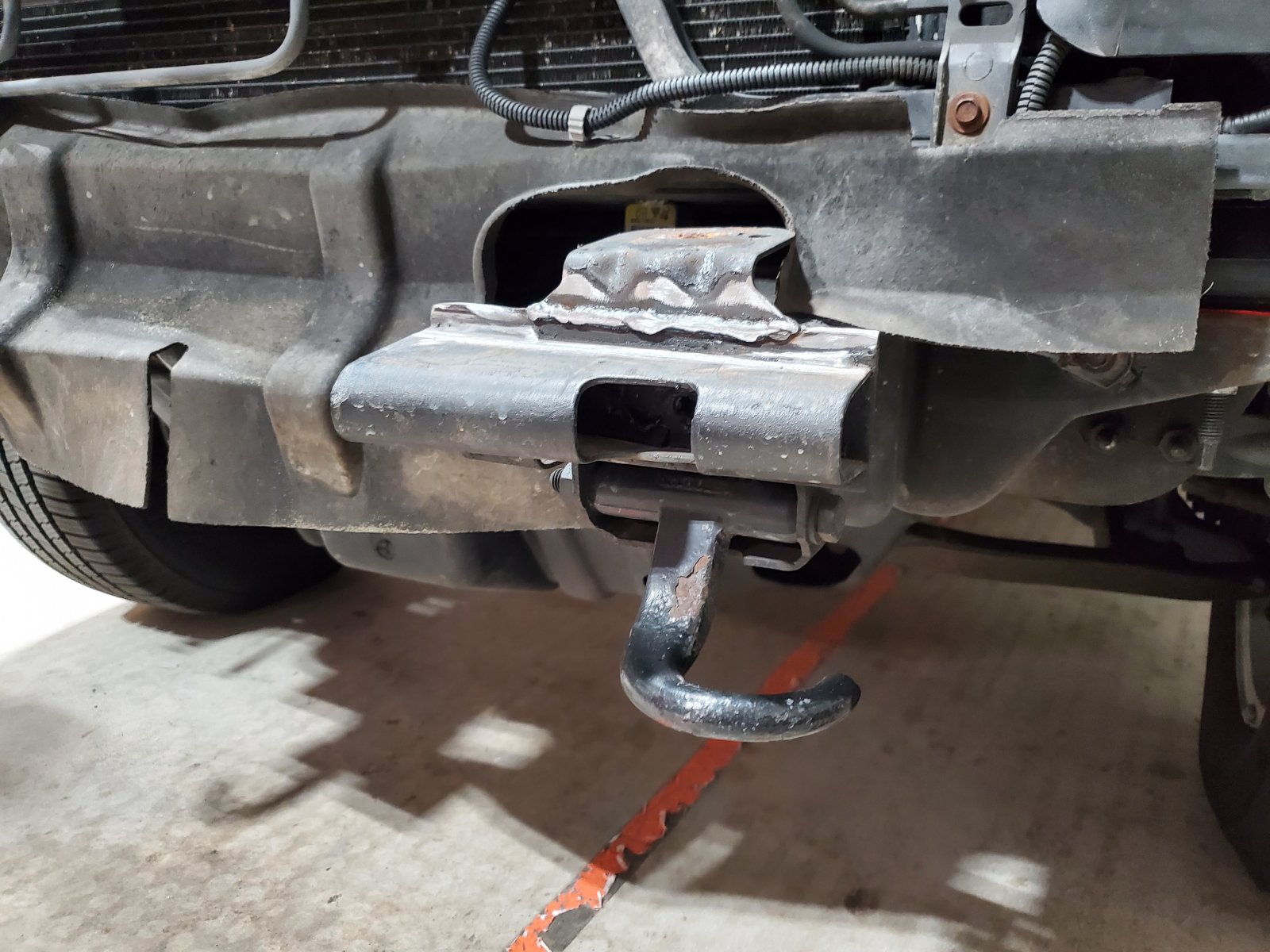

She's mounted, only the top brackets are bolted in.
I have to drill new holes on the outside brackets 1.5" higher and get two nuts to throw in there. Also need to make a 1.5" spacer and grab two longer bolts for the inside then all 6 mounting points are good to go.
New black led foglights on the way.

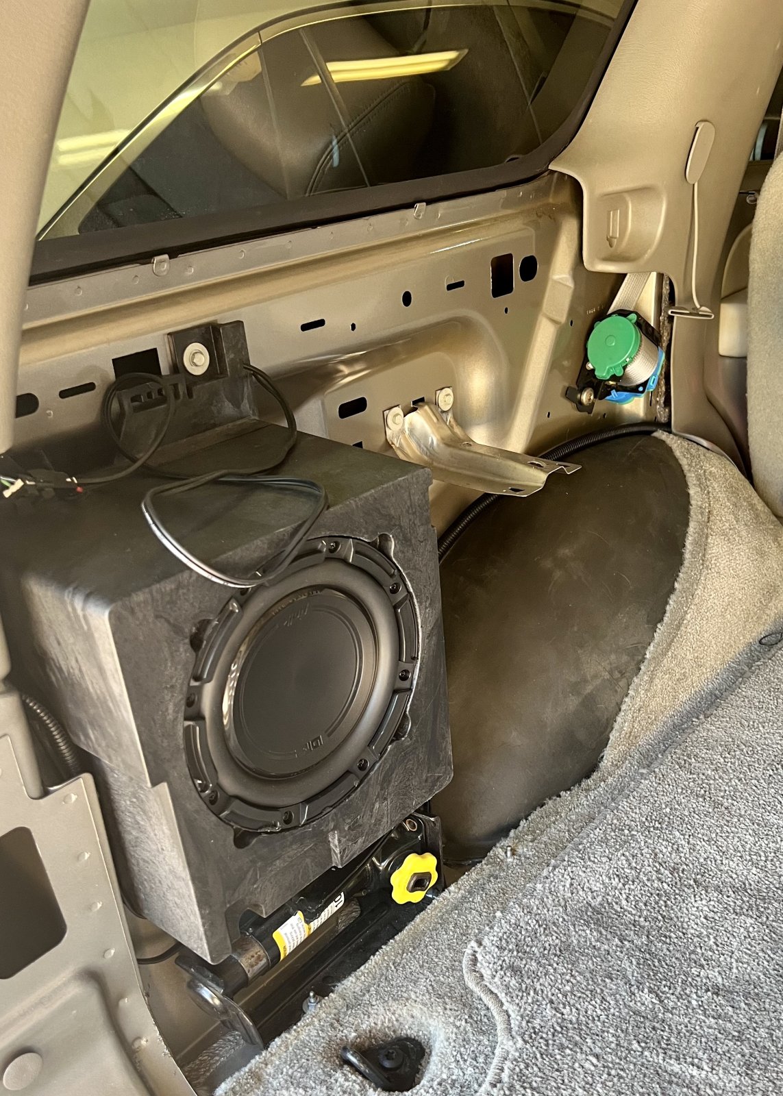

Working on a 1-Channel amplifier install for the subwoofer I installed in the back box of my 2001 Yukon. I’m pretty happy with the new sound system running off the legacy OEM amp under the glove box. It runs cool and …. It’s pre-wired, right? But an honest 300W mono-block for the 8” SVC Polk Audio sub should really add some punch. I found a good location for the Crutchfield store brand amp under the cup holder and in front of the console box, screwed into the console box mounting frame so don’t have to drill the floorboard.
