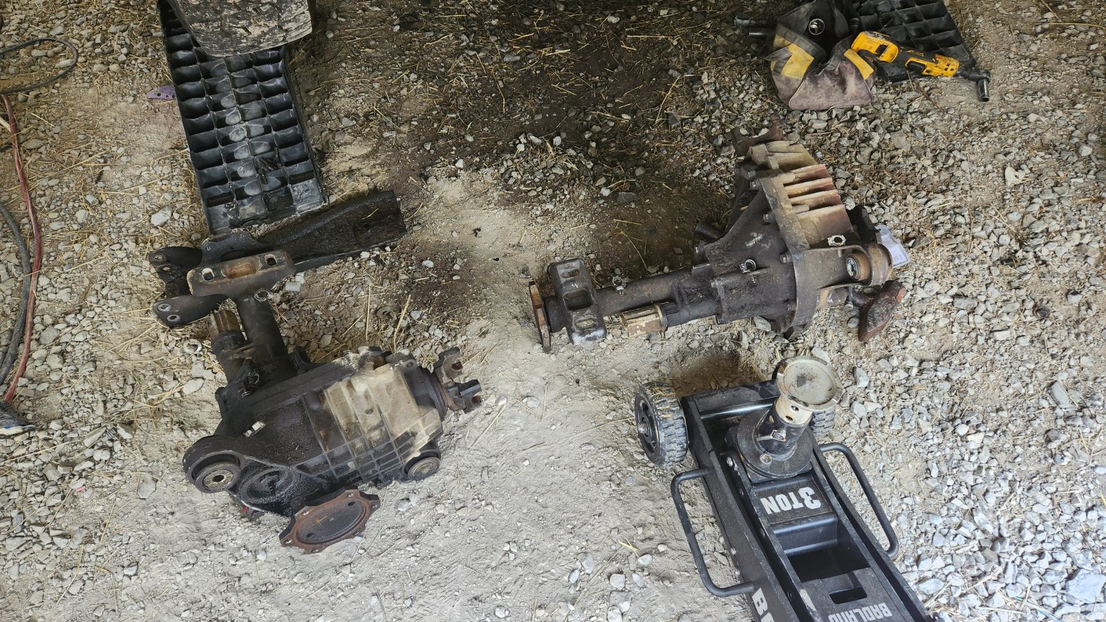

Tahoe is really getting some love this week. Threw in a spare front diff yesterday - the old had been leaking pretty badly and making noise so I wanted to get ahead of it before putting the little lady back in it so her Cherokee can go back under the knife. Also changed the oil. Couple thousand over due, whoops.

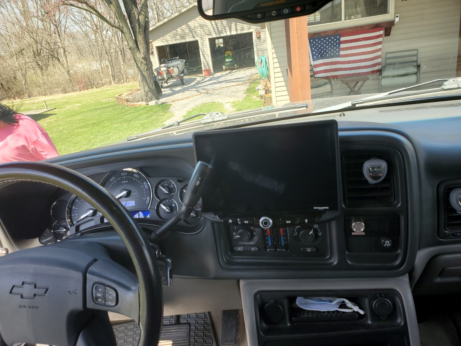

What unit did you go with for the touch screen? I've been toying with the idea of upgrading, but I love the integration with the DVD player and steering wheel controls and I'm not sure all/any aftermarket decks retain those functionalities.
If you're serious about getting into audio and functionality (and have spare change) I'd highly recommend the Stinger Heigh10. I have one in my Tahoe and it is easily the best head unit I've ever owned. Plus having the giant monitor just looks bad ass. Phone connectivity and the option for multiple camera inputs. Steering wheel controls all work as well.
