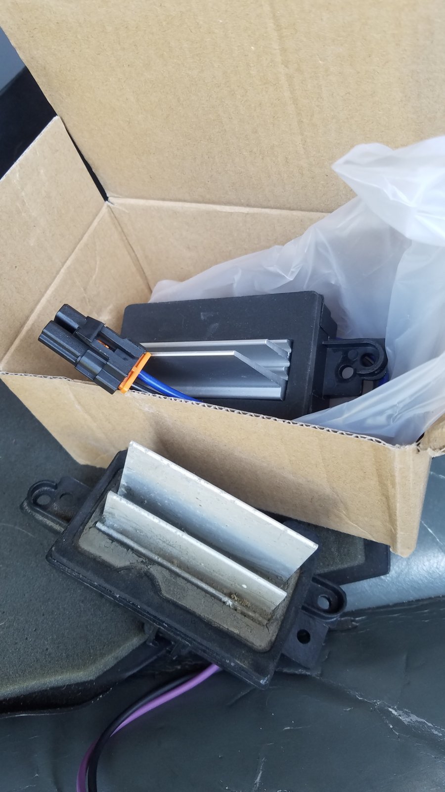

Started the truck and the fan speed set to high only came out at the low speed. Drove it got in it again and worked fine until I shut the engine off, fan kept on running :eek:
Ordered and installed a new resistor now the fan runs like a engine with a miss in it. So I ordered a new resister to see if it makes the problem go away.
