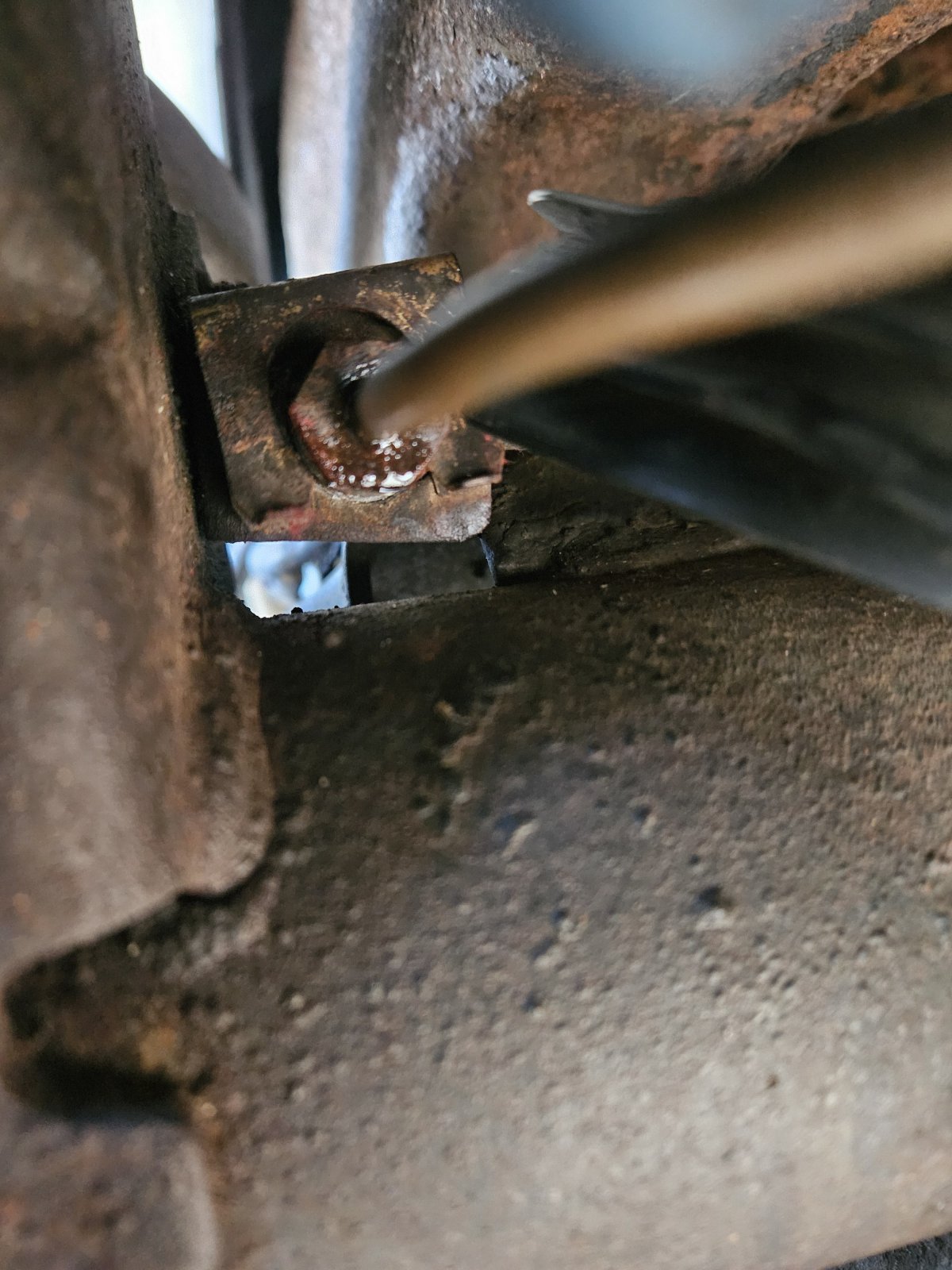

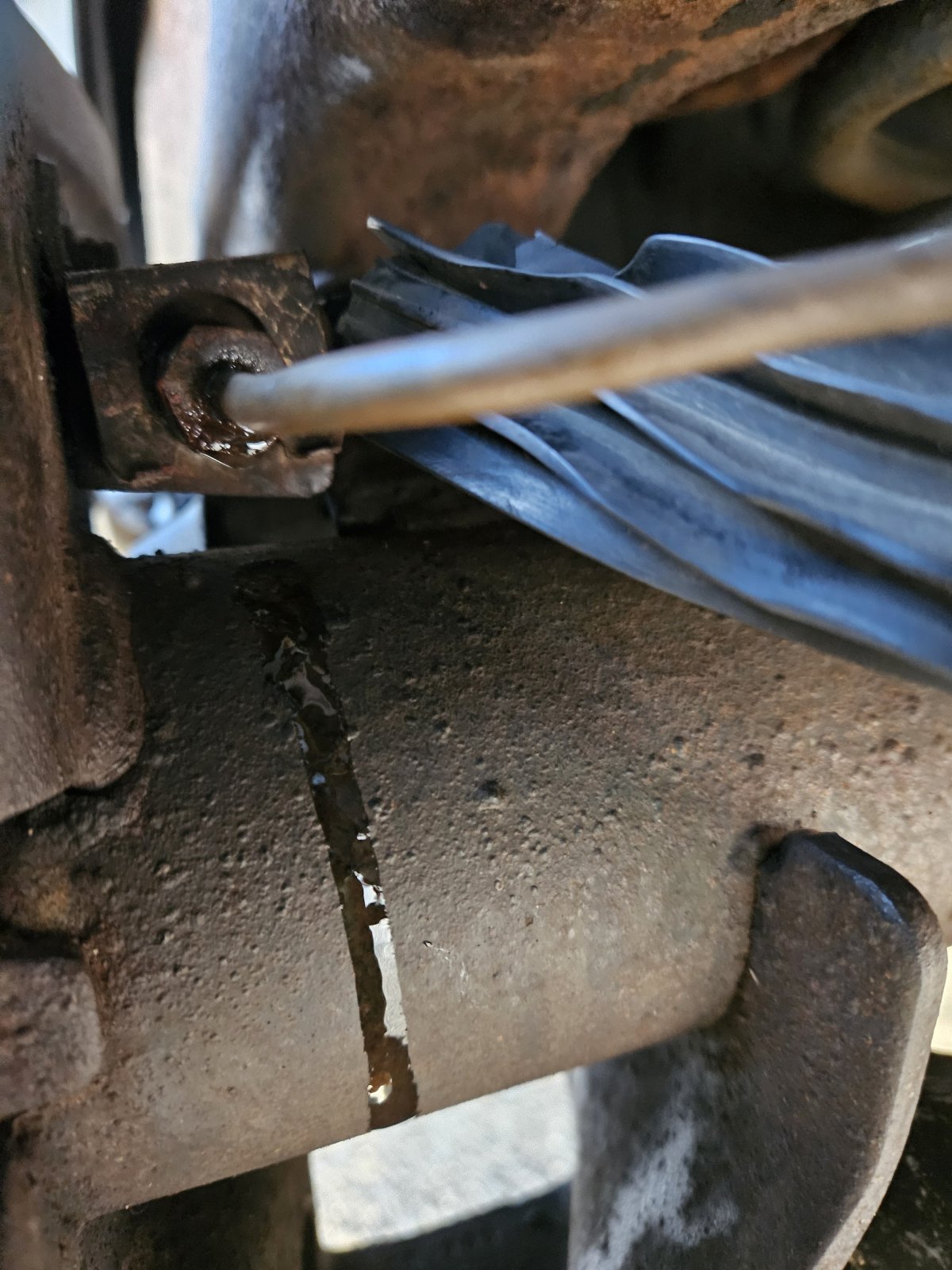

Well, I bench bled the master cylinder the other day, got all the air bubbles out. Installed it today--wasn't able to bleed the brakes yet--but the damn pedal still goes to the floor, and it barely stops. Same exact thing it did before changing the mc. Gonna bleed them tomorrow. I really hope that'll finally fix it. Anyone have any ideas? It's not leaking at any of the 4 calipers--or anywhere else that i can see. Everything is dry.

I had help. I was able to bleed 3 out of 4. Ds rear, bleeder wouldn't crack open and I didn't want it to break--you know how it goes. Other 3 bled fine. Pedal still yhe same--right to the floor. Doesn't stop any better then before. Funny--I paid a mechanic to fix a rear brake line--the one i couldn't bleed--it was leaking at the fitting. It's still leaking. I tried a few times, last time and i couldn't get it to seal correctly, that's why I paid someone else to do it. 20241207_152604.jpg20241207_152732.jpg
Same crap. I'm not sure if this is the reason the pedal goes to the floor.

I had help. I was able to bleed 3 out of 4. Ds rear, bleeder wouldn't crack open and I didn't want it to break--you know how it goes. Other 3 bled fine. Pedal still yhe same--right to the floor. Doesn't stop any better then before. Funny--I paid a mechanic to fix a rear brake line--the one i couldn't bleed--it was leaking at the fitting. It's still leaking. I tried a few times, last time and i couldn't get it to seal correctly, that's why I paid someone else to do it.View attachment 444429View attachment 444430
Replace that section of brake tubing w a new piece and high pressure compression fittings. Not a bad job to do
Smokin' gun, I would bet on...
I once had my mechanic do some front work to my 99 Silverado and he somehow left the brake hose with too much slack. The next day my brake pedal went straight to the floor on the first light leaving work, with very little brake power. I was able to stop by a Home Depot and then saw the the line ruptured because the rim was making contact on the line, and abraded it away.
If the hydraulic system has a leak, it can't possibly build pressure (or not enough pressure, depending on severe the leak is.)
Im actually scared to mess with it. What should take a few hours usually takes me a whole day--or longer. The other brake line flare I did wasn't right, and I couldn't get it right--thus the Teflon tape. Who knew there was so many different kinds of flares.
