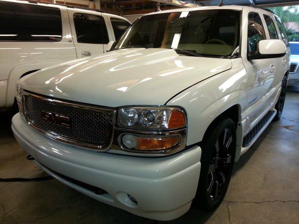

I installed Halo lights on the front head lights that gives it the look of new Audi's plus I changed all of my door, interior lights and License plate lights Blue. I replaced the bottom light assembly below the head lights with a new black look head light. One thing that bothers me is that when do these lights ever turn on; It pisses me off I tried everything but the lights below the regular lights wont turn on for anything and its really making me wonder if I wasted my money on lights that aren't even used?? Can anyone help. Take Care
Not sure if you've been through this yet but- starting from center going out-
Drl- on when daylight and truck is out of park and e brake off
Signal/parking- on when you signal and/or have the running lights on or headlights on
Sidemarker/signal- same as signal/parking lights.
You usually don't see the drls because you're in the truck when they come on unless you pull up to a building with glass front and see the reflection. Also, check fuses and check plug with multimeter to make sure you're getting voltage at bulb.
Pics of new lights please.
