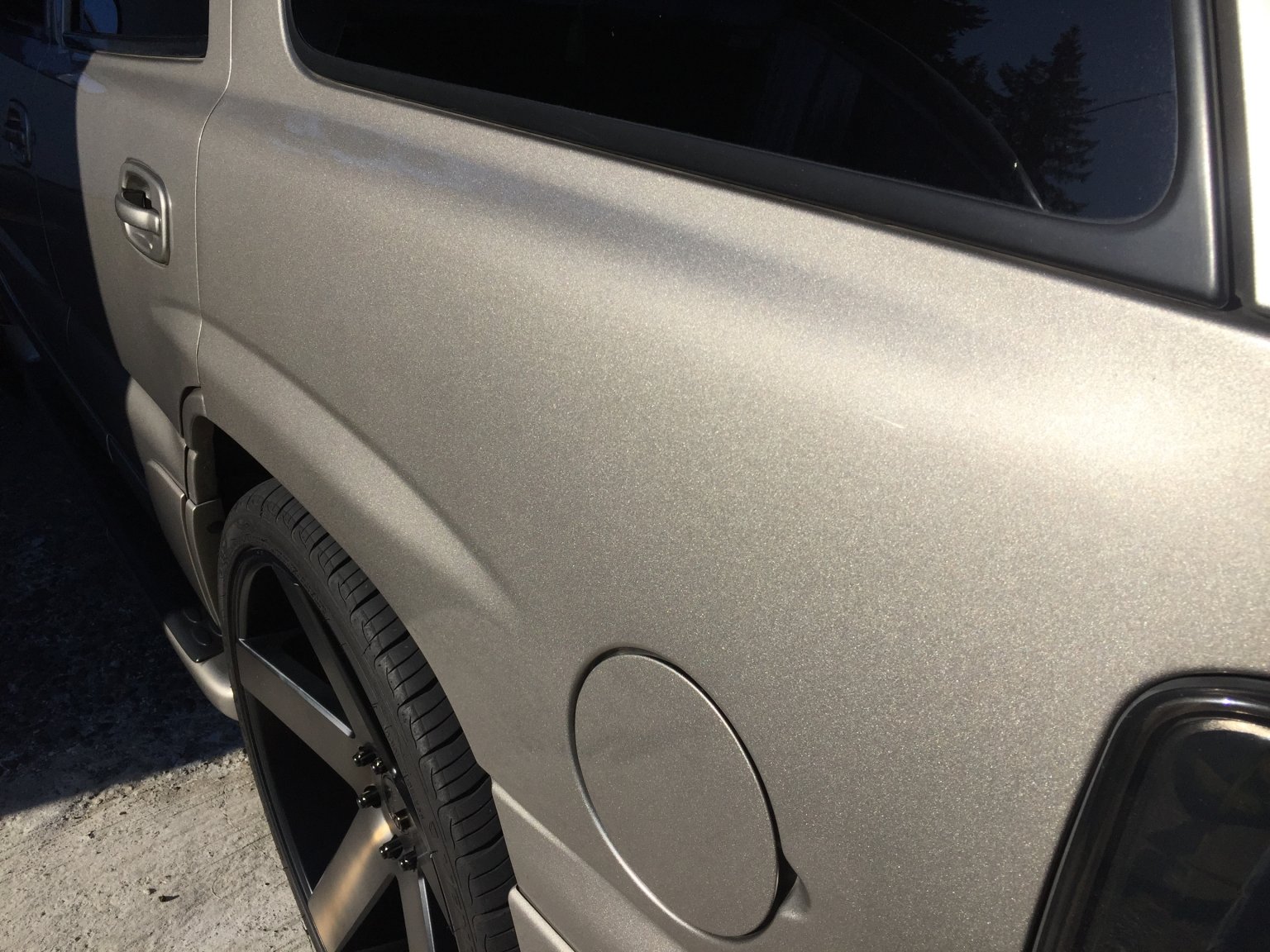

My opinion, ...................... and nothing more, ......................
Put your old wheels back on, as they looked much nicer than the wheels with rubber bands for tires.
Don't worry. I have my old 20s still. For when I want to blend in....
