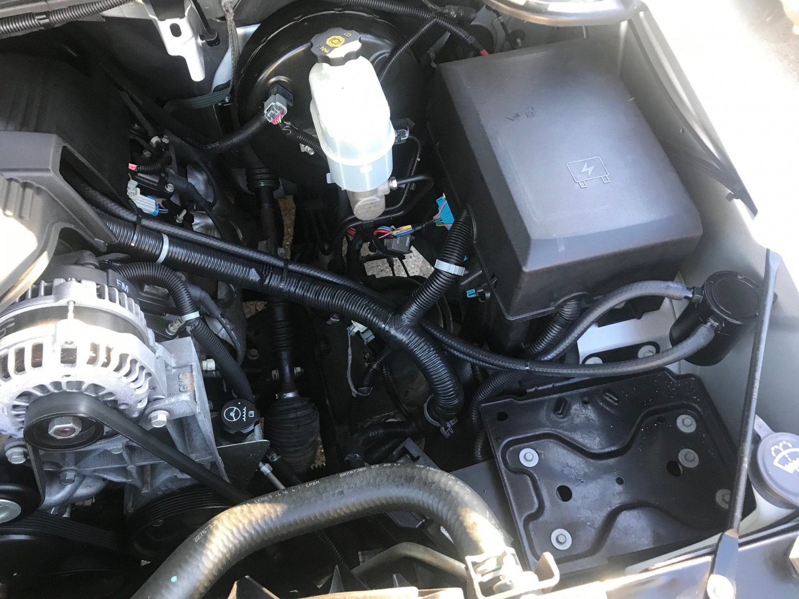

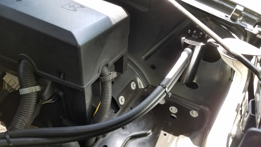

Also forgot to mention I got my new hoses made up today for my dual remote mount oil filter setup and oil cooler....
They are hydraulic lines with swivel threaded ends.
My only concern is the 212° max operating temperature but I have never seen my oil temp over 210° (after WOT pulls) and it usually sits about 205° when idling. Probably cooler when cruising due to more airflow over the oil cooler.
I figure that the maker probably tested it to higher temps and chose a safe number to list as spec. I seriously doubt that at 213° it fails.
The guy making the hose for me told me he makes them as oil lines for tractors and stuff all the time with no issues.
Hopefully this will alleviate the very minor leak I have. It's so minor that it doesn't even leave any drips on the ground but it's enough to annoy me just knowing it's there.
