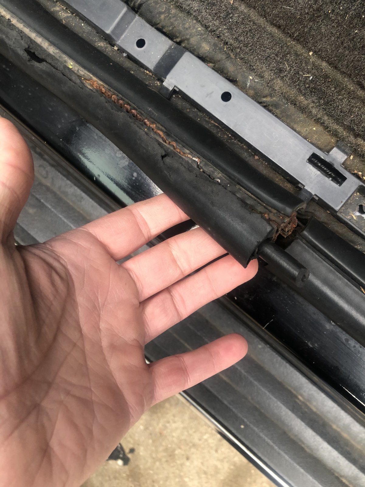

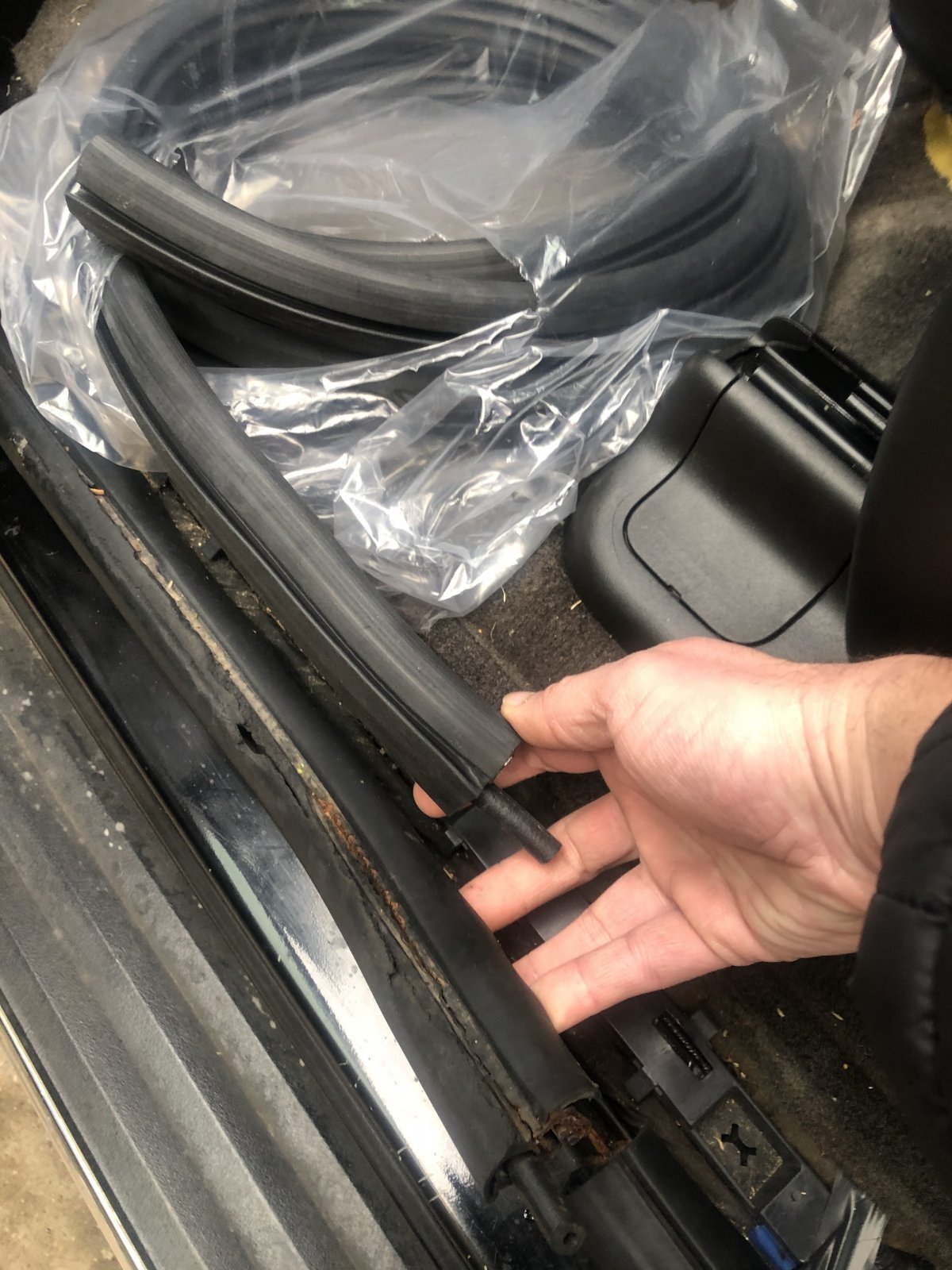

I noticed more water dripping from the left rear again. So I started pulling the lower door weatherstripping and this happened.
I finished pulling the rubber off, and pulled the "drain plug" out of the door. There was a LOT of water in there.
I'm guessing this is from a bad window seal. I dont see any other way for water to get in there. Any other ideas?

Not necessarily bad seal they are not exactly watertight, so it is acceptable for some water to get in the door, just make sure the drain holes are not clogged.

What drain holes? Every hole in the door had a rubber plug in it.
The other three doors were dry, btw.
There is a small drain hole in the corner. It's right above where the seam from the door skin is folded over.
Btw, I removed the rear most plug from each door and kept them out.
