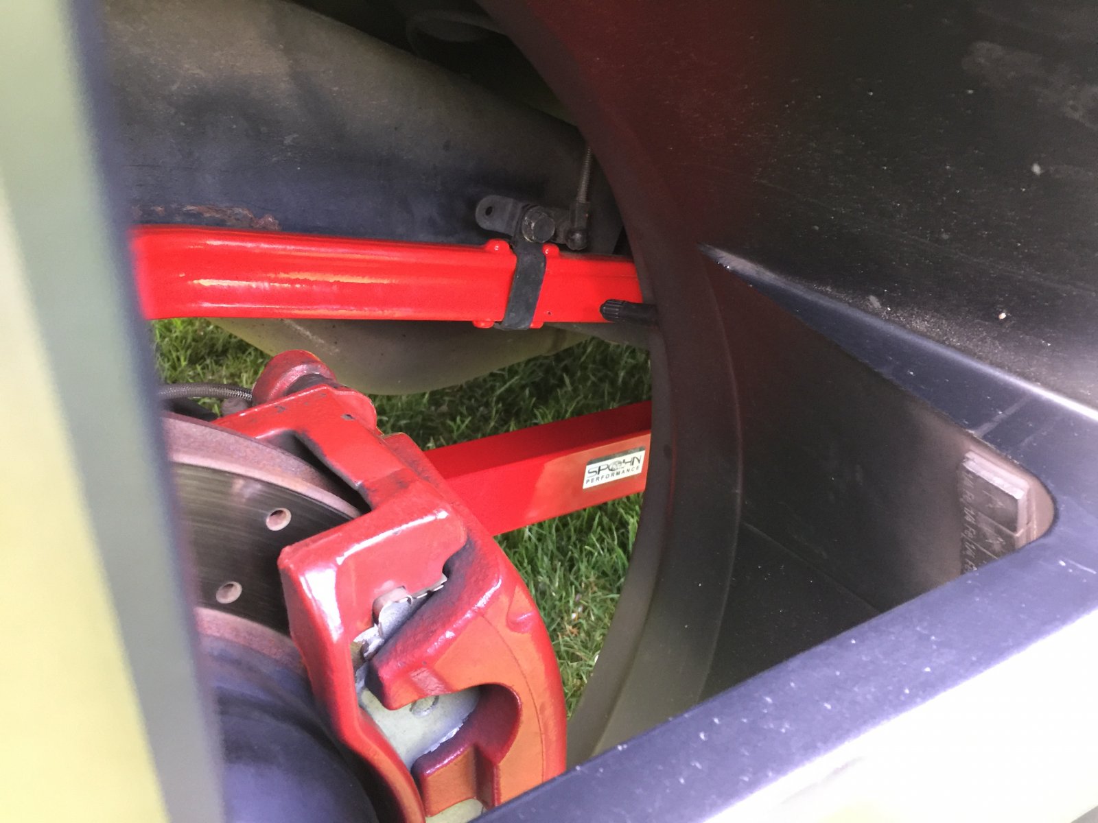

anybody ever use these or something like them
https://www.ebay.com/itm/Boxed-Rear...r:2012&hash=item27e53d899c:g:uZwAAOxyrx5Tj2u6

I run something similar on my mustang. They flex less because they're boxed (stock ones are open along the bottom), and have tougher/harder poly bushings. Because of the stiffer bushings there is a bit more road noise transferred into the cabin, but loud exhaust or stereo easily covers it.

The panhard is what locates the rear. The control arms do virtually nothing for sideways (lateral) support. I looked at mine earlier and saw the same rub marks on the plastic. They're not quite as bad as yours, but my Tahoe's not quite as heavy as your XL and I may not huck it quite as hard as you do yours. I have the same tires with what looks to be the same amount of wear. I noticed what may have been some slight rubbing marks on the control arms, too.
The rear isn't exactly centered and it does shift sideways slightly as it travels up and down since the panhard swings in an arc. Here's a little video that shows it in action on a drawing:
The pivot points are opposite of how they are on our trucks (ours has the frame mount on the RH side), but it's all the same. You can see how the rear moves laterally just a hair. The axle moving inward, plus the body leaning, plus the tire sidewall rolling inward all lead to the tire contacting the inboard areas. Beefing up the control arms wouldn't do much at all for this. Beefing up the panhard is about all that could make the only real difference.

ya I kinda figured that the panhard was the more critical part here, I was trying to look around at other ones besides just the spohn, I figure I can get that and adjust it to the same length as the stock one set it and forget it, maybe the poly bushings will be more snug than the stock rubber bushings, my thought is to replace the upper & lower control arms and the panhard bar all in one shot.
