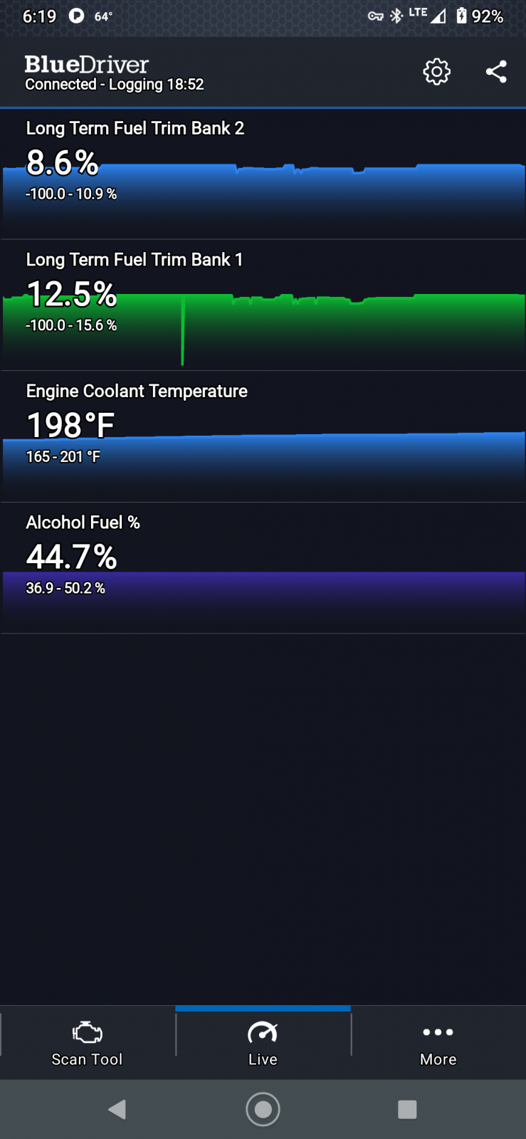

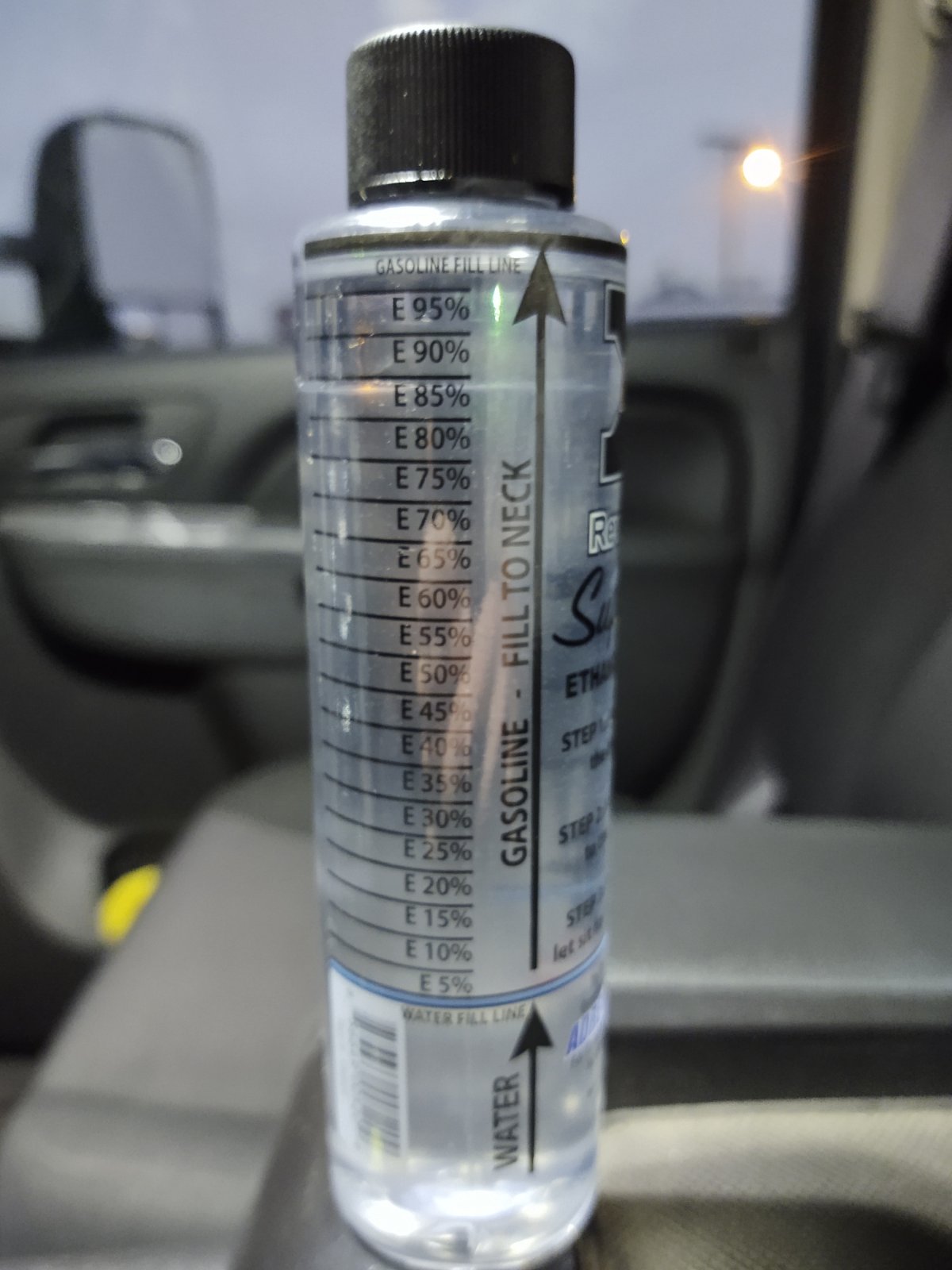

Late to the party, but I wonder what Wes, took out the cat? Sticky fuel injector? You can turn them on and off and check your fuel pump trims too. Your LTFTs @ 7, if they stay there for a long time are off. What's your alcohol content? If that number is off, you can reset the Fuel Trims and Fuel Composition and start her over again.
and the alcohol content is 2% currently, mpg bumped up to 9.8 today, historically it's been 10/10.2 ever since I have had it even with the old motor
