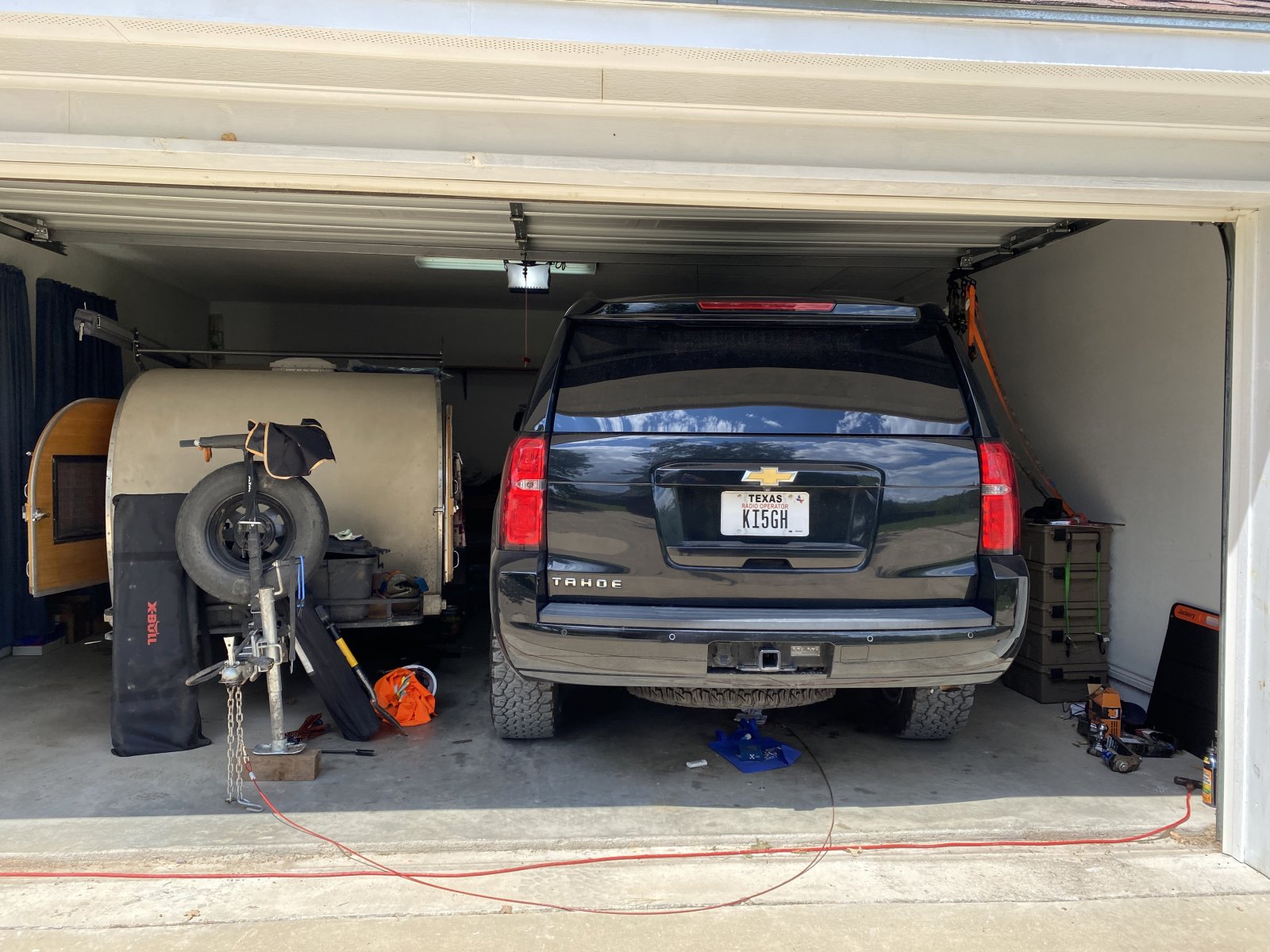

Just finished up a whole bunch of maintenance and repairs that I had been putting off. My tahoe has 140K on it but the engine runs great so I’m going to keep it for a while. I finally decided to finish the work after my G80 rear differential blew up. It’s one hell of a list:
Oil pump, water pump, timing chain, replaced the leaking oil pan gasket, H3 motor mounts, Yukon limited slip differential, replaced both front hub bearings, transmission fluid, transfer case fluid, front differential fluid and axle seals, tie rod ends, spark plugs/wires, cleaned throttle body, replaced leaking power steering hoses, replaced rear brake calipers, pads, and rotors. Replaced leaking brake master cylinder.
Also, I needed tires so I went ahead and got some Fuel Trophy 18x9 and some bigger Duratrac 295/65r18 tires. I wanted more rubber than my 275/60r20s.
