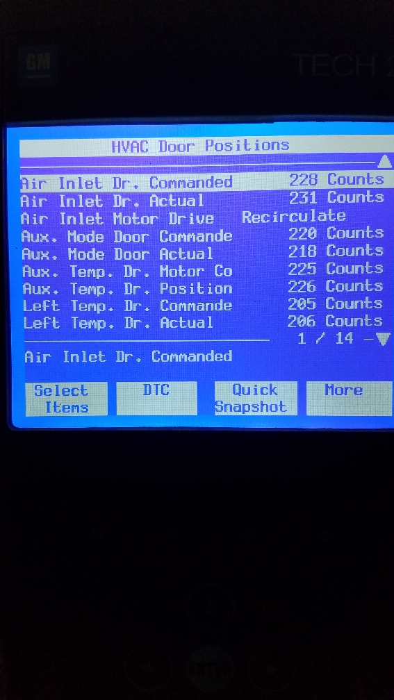

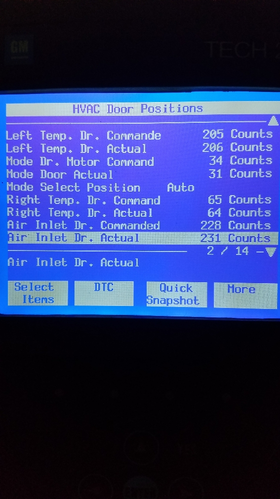

Your Auxiliary Mode Actuator probably needs replacing. Go into the Body Control Module, HVAC and then Door Positions and see what the commanded and actual states are. If they are off by more than 4 or 5 counts its going to throw a code. The B3782 code makes me think that the thing is wandering, the commanded might be a 32 counts but the actual is all over the place. That's is what my main Mode Door Actuator is doing right now with it's corresponding code like yours. If it doesn't rain tomorrow and my back holds out, it'll get changed.
Good luck trying to order the right one ahead of time. I thought I knew them but was proven wrong! I THINK it is 15-72972/89018375. Already proven that 15-72971/89018365 controls the driver and passenger air temperatures and that 15-73952/89018374 is the main Mode Door up front, it's sitting on my desk.
Good info. I'm in the car now with the Tech2 hooked up and looking at the door positions. They all seem fine. Attached are the screen shots.
I also notice on the HVAC system data screen that it lists
"Ign. Cycles Since Last DTC" is 100
So who knows. Would doing an actuator recalibration hurt anything?
Sent from my SM-G930V using Tapatalk
You can clear them and then run a dtc check again and see if it still comes up if not then check again in a couple days, or clear them and then do a re-calibration and see if it throws a dtc again.
Looks good, and no, it doesn't hurt anything to do a calibration.
