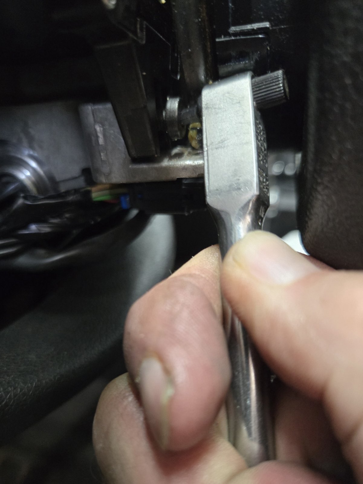

The only other door pins I've replaced were on my 99 2dr. It was pretty easy, grinding the tops is the same, pretty easy with my dynafile. It fell out on my 99, not the 07. I had to beat the crap out of it and it finally came out. I had to remove the bolt going into the body to fit a socket around the little torque lock nut not like the plastic lined lock nut. It was a pain and it needs to be threaded on roughly a 1/4 inch. Getting the spring out wasn't bad, getting it back in was a ***** because the spring tool didn't really fit. I had to remove the bolt closest to the driver in the door to fit the tool with the spring. I had to use a hammer to fit the tool on the spring and make sure to get the outer most coil and tighten the shit out of it. That and removing the bolt will fit.
So yeah, it is a ***** haha
