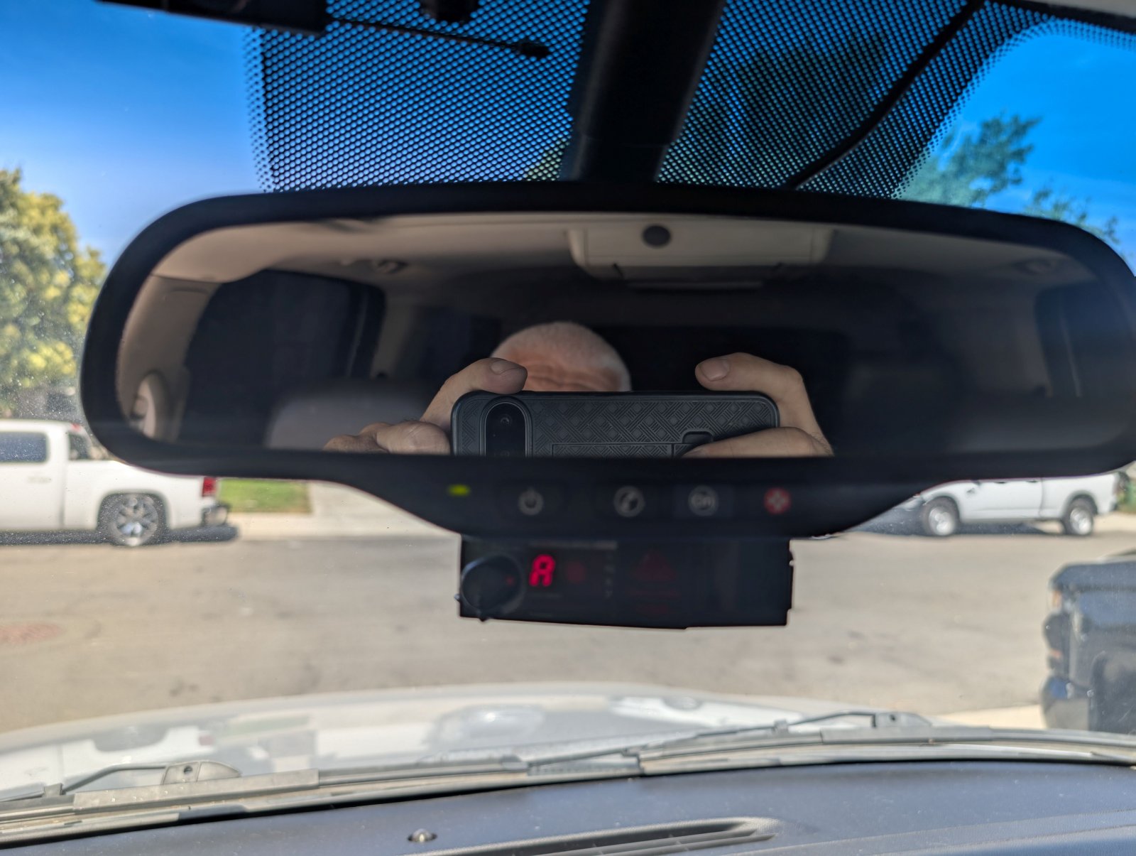

Anyone know Of a reputable mirror replacement? Only found TRQ so far and have never heard of them.
