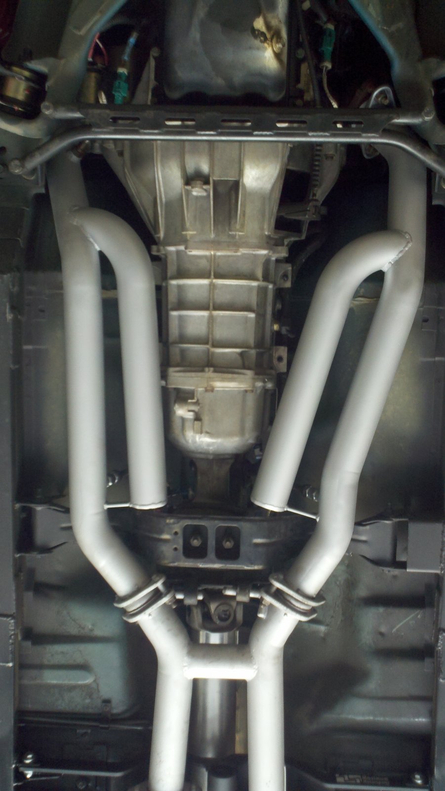

Is that a quarter-wave attenuator? I put a couple of those on my Mustang back in the day. After swapping to a catless h-pipe and Flowmasters, it had a bad drone around 2250rpm, right at highway cruise speed in fifth gear. The attenuators cut the sound power to less than half (-4dB) at that rpm. Worked wonders.
