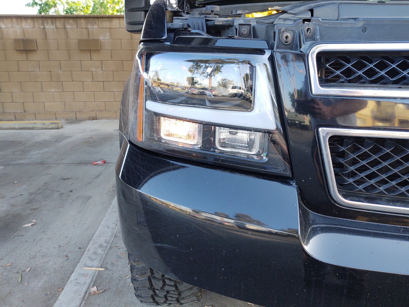

Finally swapped the white DRL bulbs back out of the turn signals and swapped in amber led bulbs in. Also changed the cabin filter. Wasn't too bad actually.

And I guess I didn't test it thoroughly enough yesterday when I was installing them. But I definitely have hyper flash now even though the tail lights are still the original bulbs.
27,125
41,029
you will need resistors or bulbs with resistors built in, the only seller I have seen with resistors built into the bulbs that actually worked is auxito
you have to get them from this guy though because others are fakes or not work
